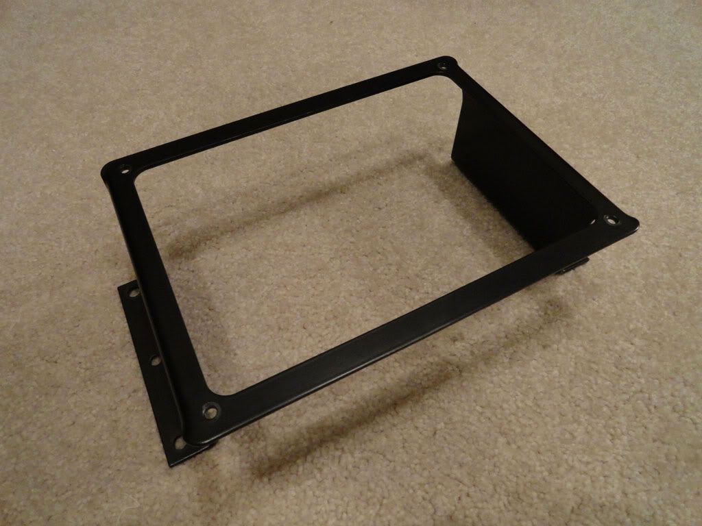

Default Mo Parts
While at Columbus I was able to pick up some more parts for the car.
ECM Mount and Remote Coil Mounts from Rodger at Ironworks (a site supporting vendor).
And after Chad (CCRacin) blew the side outta his Camaro’s LS6 motor, he purchased a replacement from Greg Weld who had a LS6 drop out from a Vette in his shed. Chad didn’t need the vette ECM, Wiring Harness and Intake system, so he sold them to me and I will use them on my buildup.
And the work continues...
Jim
