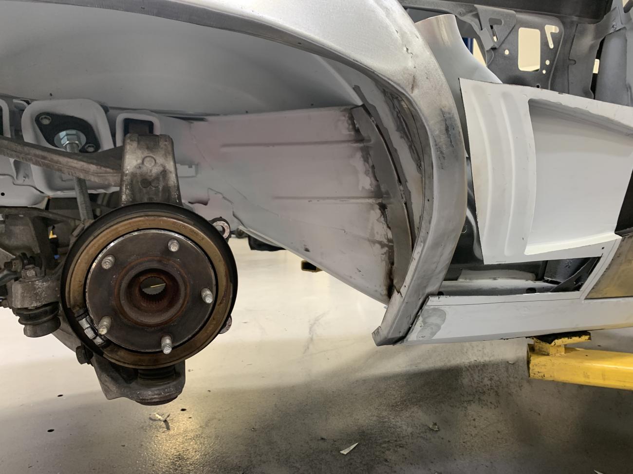

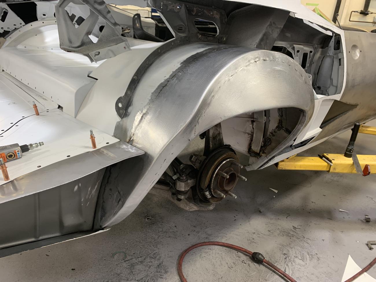

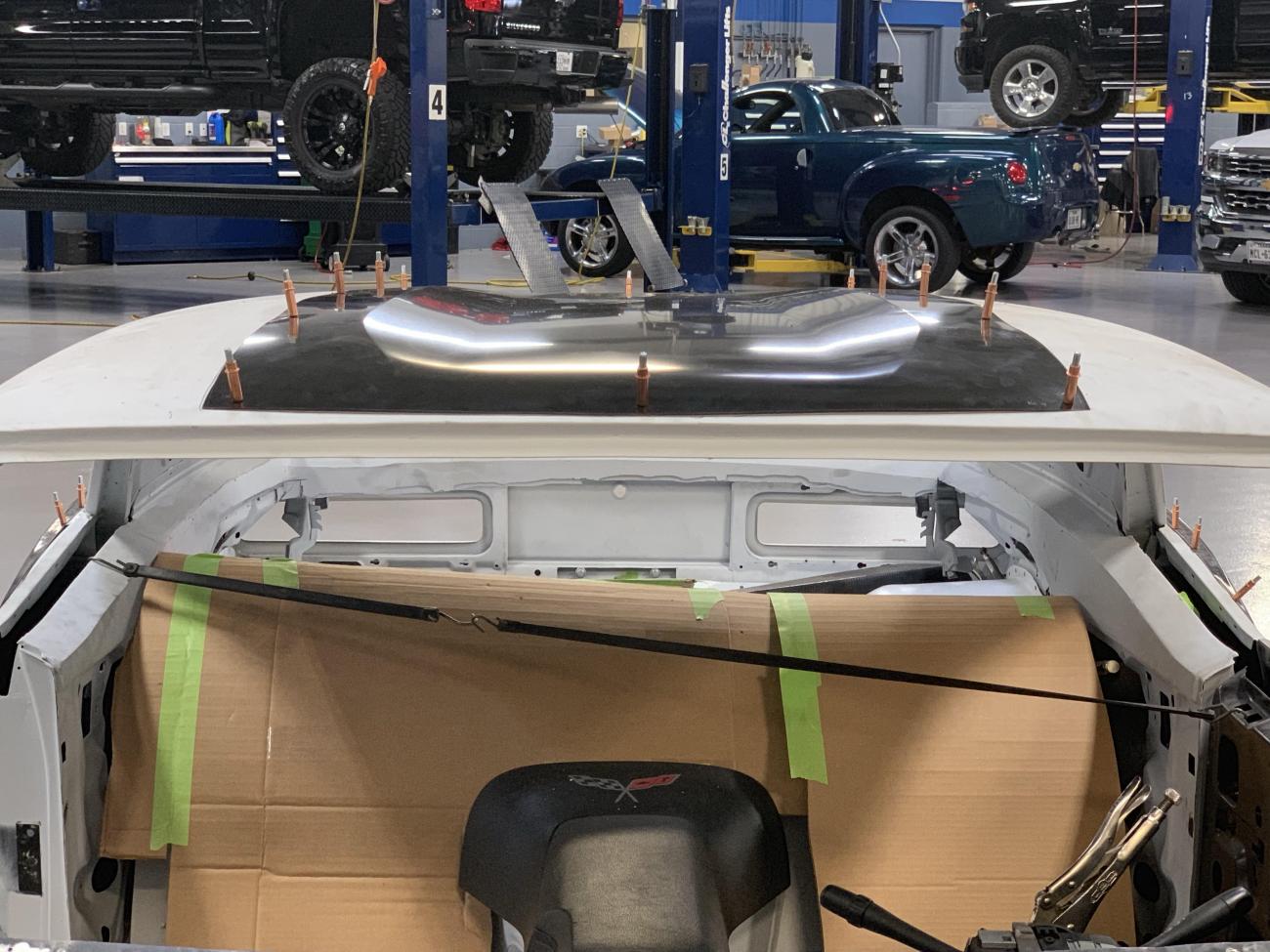

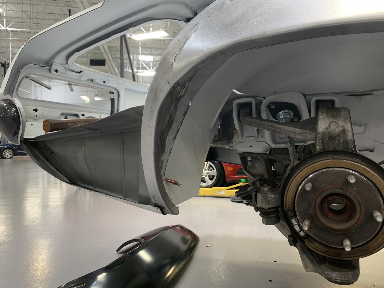

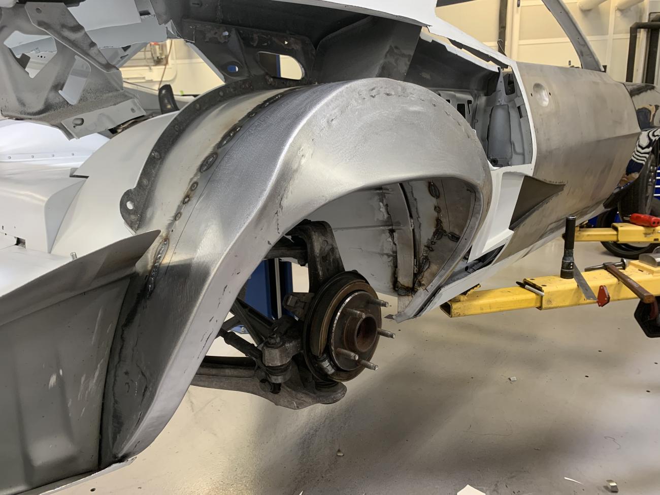

Saturday I got the passenger outer tub almost done. A little more grinding on the front side and its done until the quarter is ready to be welded on. I'm going to leave them removable for the time being so I can get to the back side of the structure for things I have in the works later.

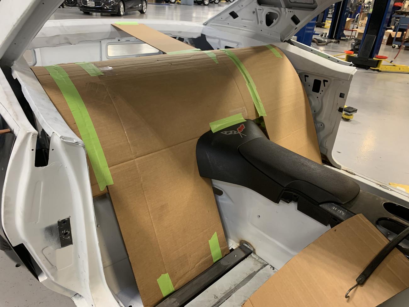

After I finished up the tub I started some rough mock up to get a visual of how things need to go for the new package tray/filler panel. I have a lot of room at the bottom so I can hide modules and fuse blocks behind the seats.

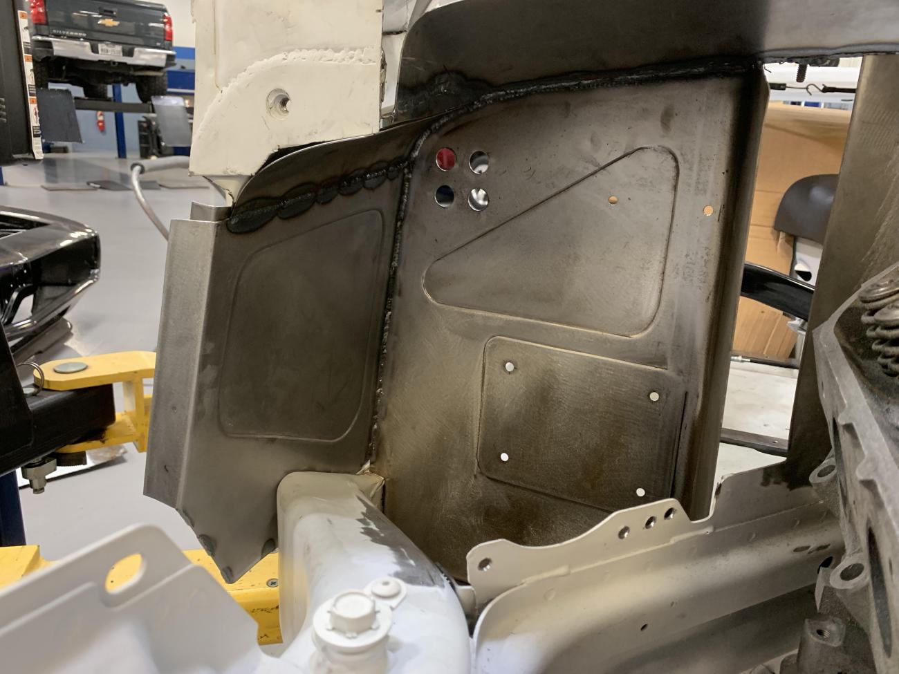

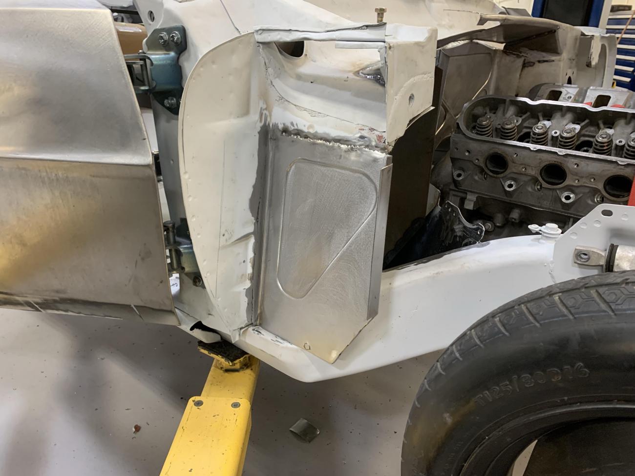

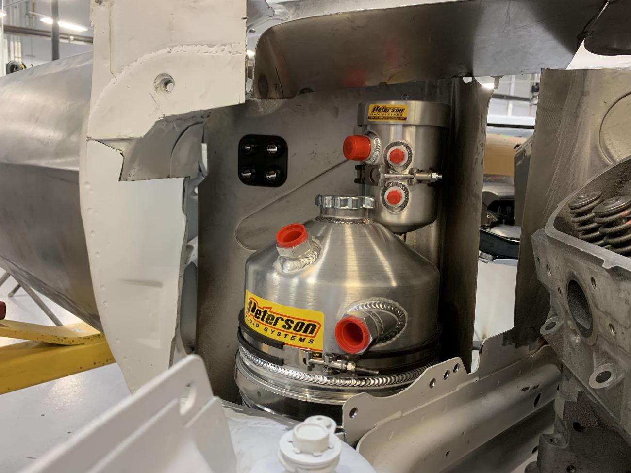

Now lets talk about the last part that showed up and progressed the firewall this past weekend. The 3 gallon dry sump tank. I wanted to put the tank in the tulip like Mark does, but the Vette frame takes up a lot of that area. So I moved it inboard some. It looks like I gave up a lot of foot well space, but you can see how much of the floor I hard to cut out. This is also the area GM put the fuse block and BCM so I actually lost no room at all. New firewall and the oil tank are mounted. I can now finish up the firewall on the passenger side and get the Vintage Air bulk head mounted too. I'm still trying to figure out were to put the breather. It might go where its pictured or on the other side. The plan is to make a cover to close out the tank area and help protect it from the header heat. I also still have plenty of room to mount the full size Vintage Air IV Magnum over the trans tunnel so my glove box will actually be full size.

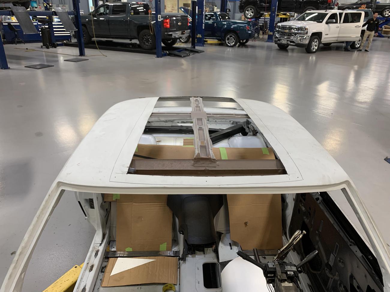

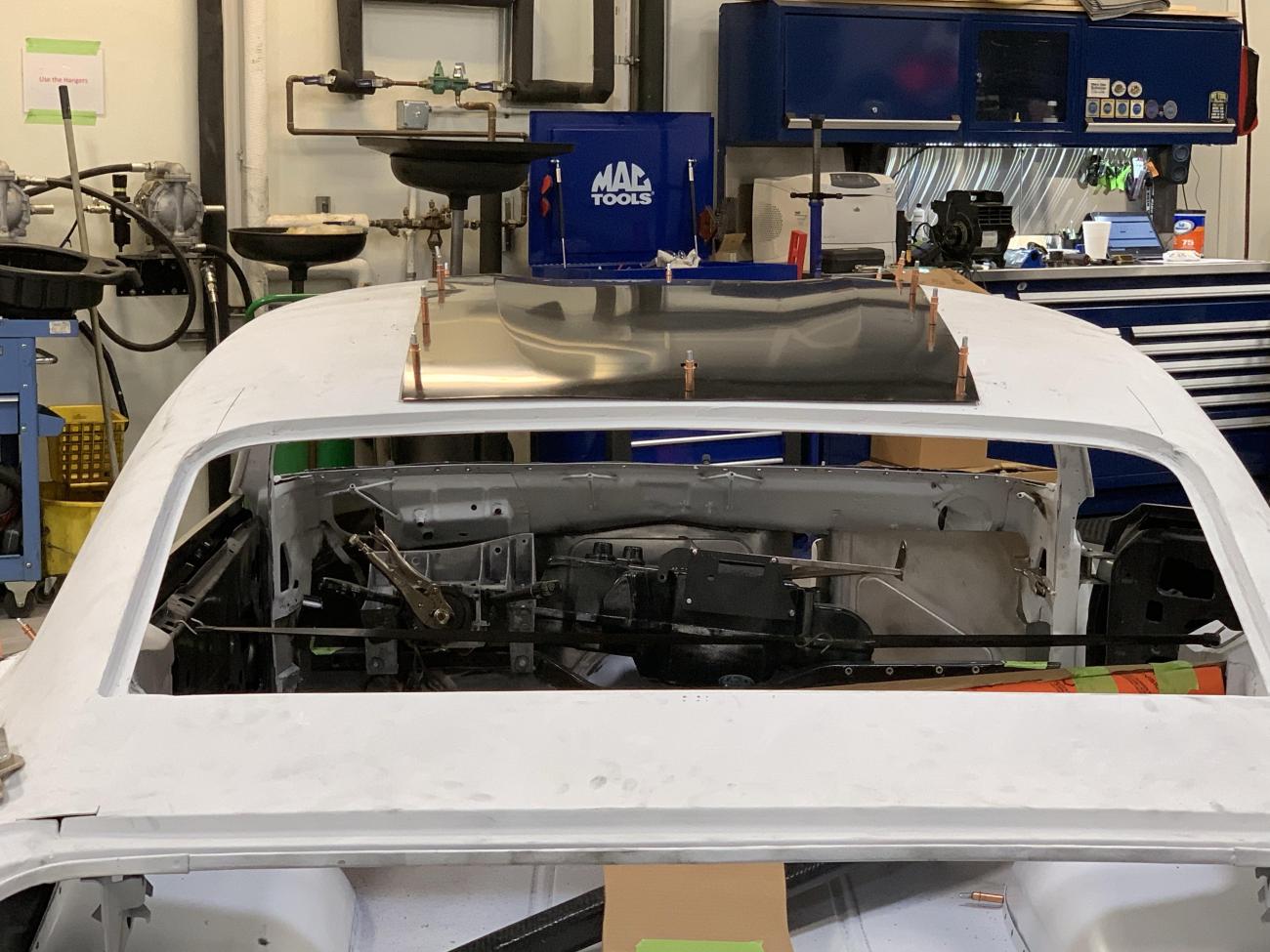

With that buzz kill out of the way I got the roof skin from a 2019 Camaro cut down and the roof of the '69 cut out and the two lined up ready for finial fitment and welding. I was really surprised at how well they lined up without any mods or metal working.
With the roof on track I wanted to get back to the firewall so I can get it done. I got the breather tank and the HVAC bulkhead mounted so it's ready to focus on finishing out the metal fab. I cut out the old vent hole and made a new filler panel to line up better with the new frame and old body and wasn't all beat up. On the inside of that I made another panel to close out the interior of the car. Up top I used the english wheel to shape the curve panel so it wasn't a bunch of flat pieces welded thrown together. I'm pretty happy with how its coming along. The plan for the area is a removable tulip panel so I can get in and seal and paint it and possibly put something else in there. Out by the oil tank I want to build a close out panel to block the heat from the headers and dress up the engine bay some.

Love that roof mod. Where is that piece from or is it custom?
‘16+ Camaro roof skin.
That's what I thought. Very nice addition!!
