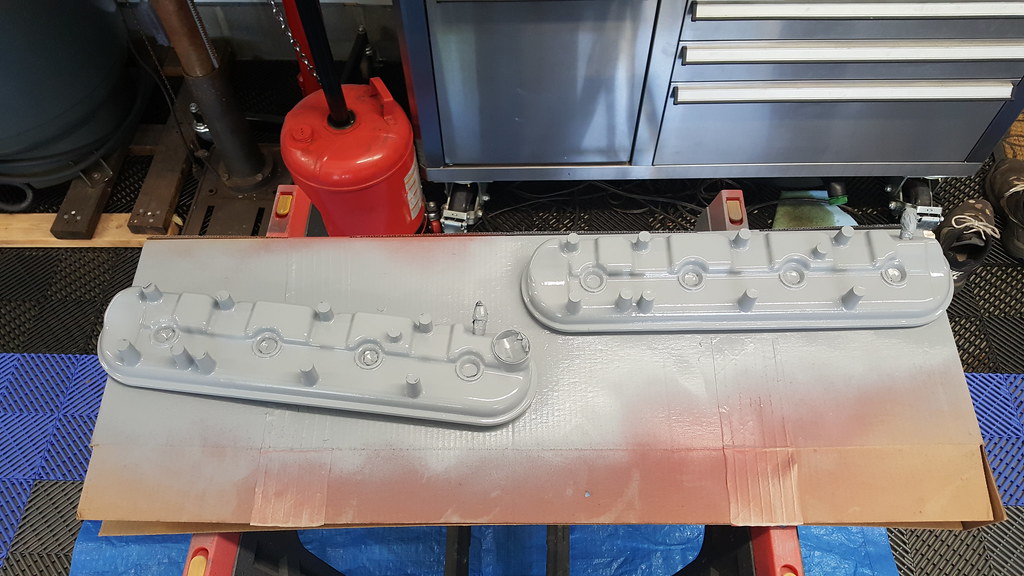

Ever since I put those Holley valve covers on - I have been having problems with losing oil/a huge cloud of smoke billowing out of the car on cold start up.
I did some research and the Holley covers like to suck oil through the drivers side valve cover right into the blower.
I am sure on a N/A setup - they would work great, but after loosing a quart of oil in a weekend - I had enough.

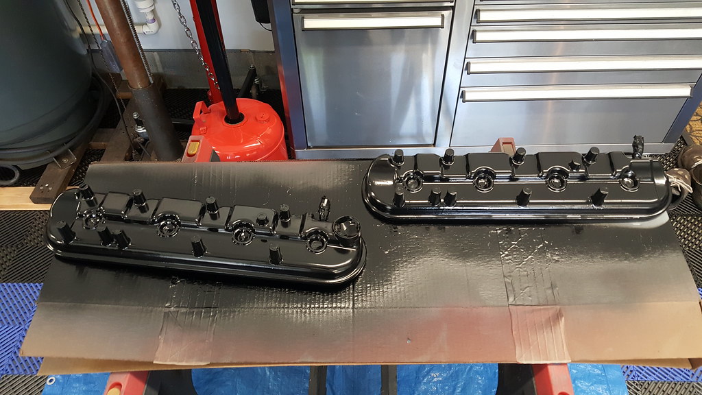

I ripped them off and ordered a set of LS9 valve covers.
These are built for boost - and give off the same look of no coil pack brackets.
For now I put the stock covers back on - and have not had an issue. No oil consumption, no huge clouds of white smoke on startup, etc.
I got the covers a few days ago - and have painted them black like the Holley covers.
I'll put them on the car after they cure for a couple days.
I also ordered a catch can - and will install that along with the covers.
This should resolve my oil consumption issues - and give me the look that I am after.

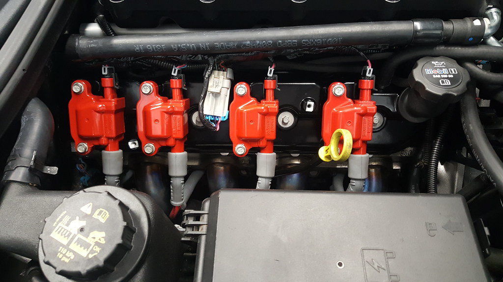

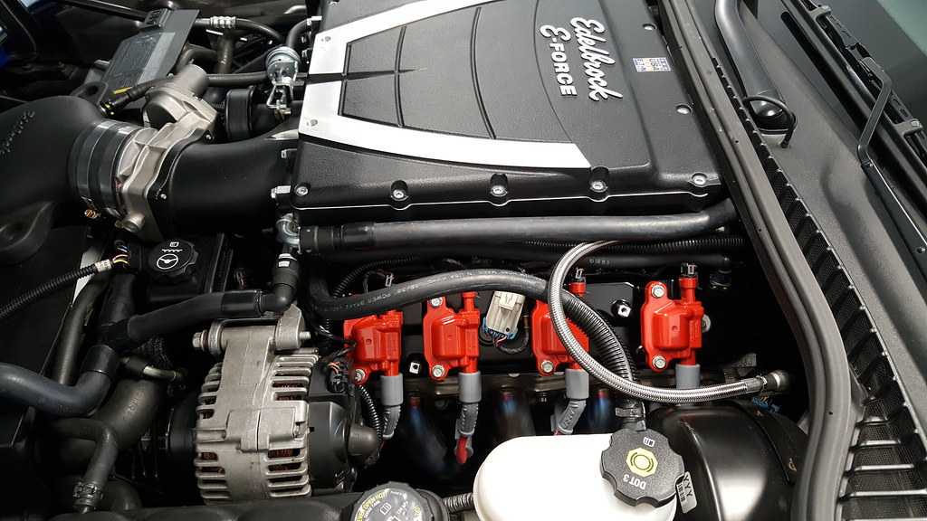

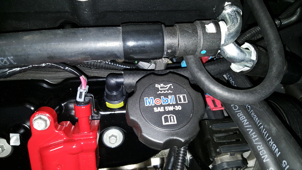

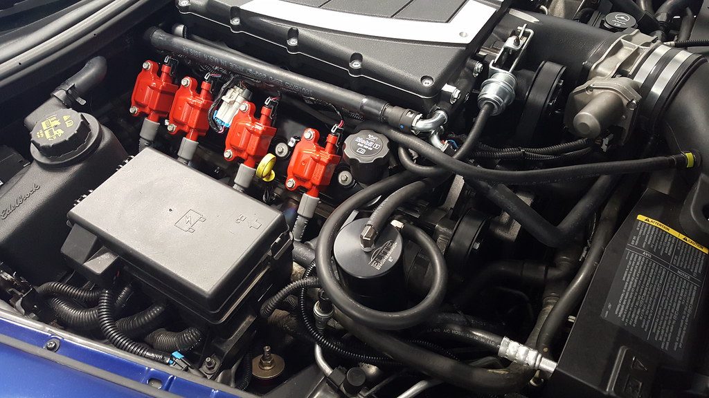

I got the LS9 valve covers installed - as well as my Elite Engineering Catch Can.
I ended up having to order the oil fill tube for an LSA engine as the LS2 one will not clip in because the LS9 valve covers have an extra tab inside the cover - and they moved the tabs as well.
I am still waiting on some 90* fittings from Edelbrock - this will allow the PCV hoses to snap into the LS9 valve covers - as they are designed to clip in to them.
I am also waiting for a straight barb on the catch can - it currently has a 90* fitting on there making the PCV hose wrap around the can.
Once those come in - I will trim the hoses to the proper length and clean everything up.

I finally got the PCV system finished up.
My 90* elbows came in from Edelbrock - I had to order them through Summit Racing and it ended up being a custom order.
These 90's snap right into the LS9 valve covers - and cleans up the PCV hose routing a lot.
Also - after adding the catch can I went on a 30 mile drive. I got home and filled up the can.
I added a PCV valve between the drivers rear port and the can. I went on the same drive - and there was barely anything inside the catch can.
So I think I got the oiling issue resolved.
