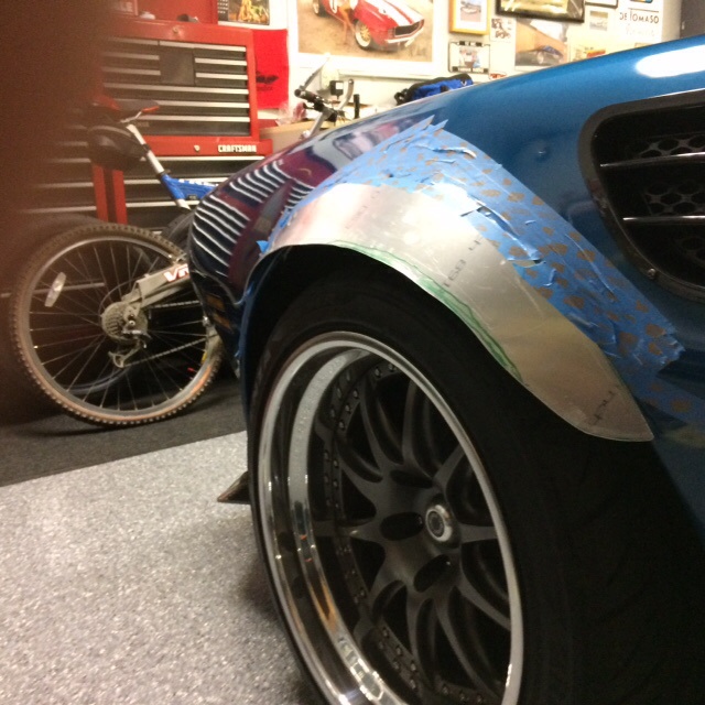

I added the Trans Am flairs, hood and Spoiler and
had one of my Autocross buddies Paint the Car
25 years ago for $1100... still looks pretty good

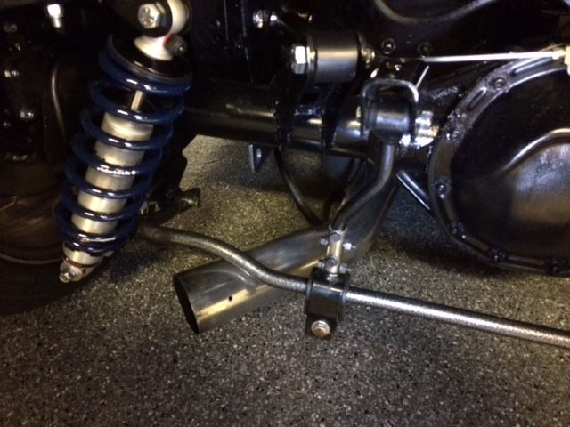

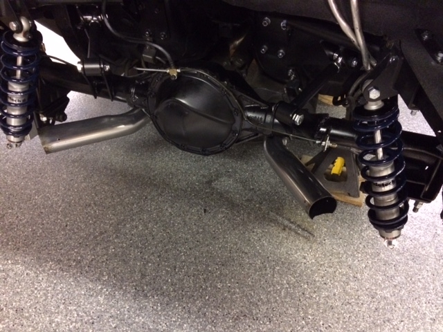

Speed tech front end with coil overs - now Vikings
with 450 Lb springs

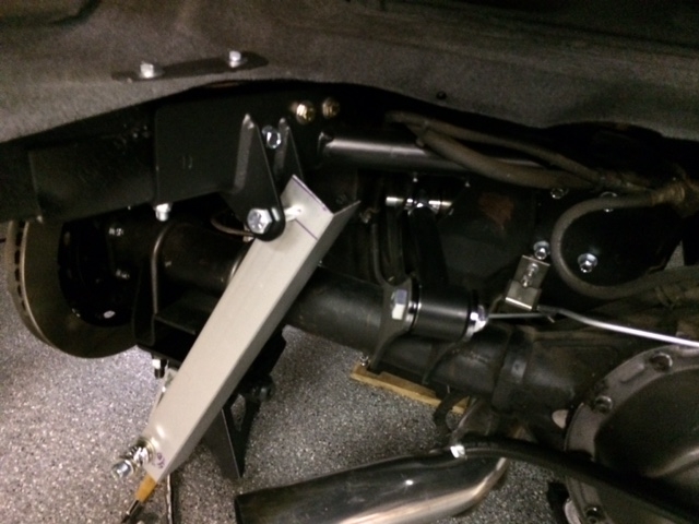

Mono leaf rear with spherical and raised front mounts
Viking shocks out back also
Protouring subframe connectors along with his old
Herb Adam style front braces, Autopower 5 point bar

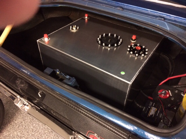

Electric water pump, A1000 fuel pump with return to
Rick's SS tank with rear sump, Msd dizzy and electronics
Carb is a 4150 built with Dominator plate and metering blocks
approx 1150 cfm
Just put a Splitter out front, rear lexan window,
pulled the side windows and working on a rear wing
extension, have new side vents and a glass hood
to install sometime
