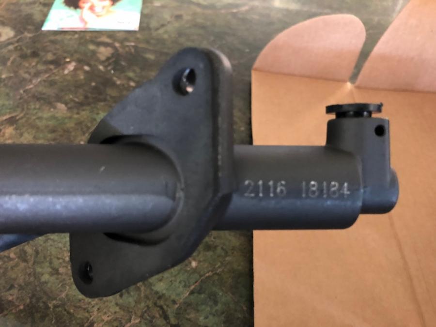

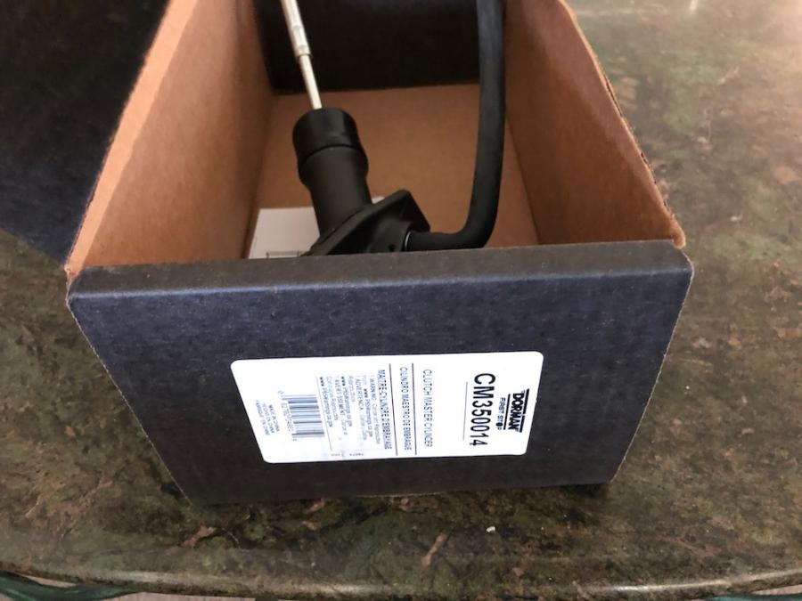

Originally Posted by RdHuggr68 View Post
I called Dorman tech dept. today and gave him the part # listed by Mark and they told me that it is plastic and has been plastic for at least 7 years. Not sure what to think.
Apparently the secret is to order it from Summit Racing on the west-coast... Sparks, NV.
The description on Summit said "plastic", but this is what I got
John Brown
Instagram @wilwaxu
Facebook @wilwaxu
