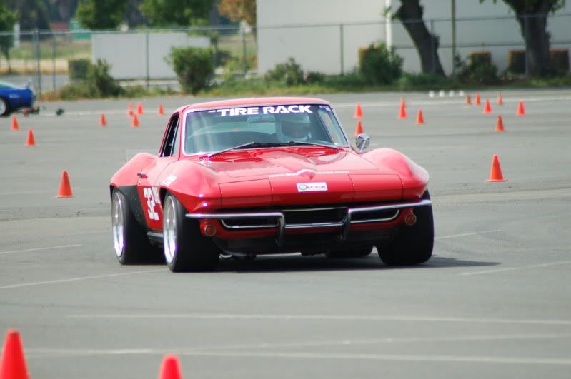

Mark,
The Corvette flares were done well over 30 years ago and were hand made. The car was flared the first week the original owner received it and they grew over the years as tires were getting bigger. There are not any molds of these flares. We get a lot of compliments on the flares. The body line continues down the side in the flares and they do not look added on. We run a 335/35/17 in the rear on a 17 x 12 wheel. A 345/35/18 or a 345/30/19 will fit with no problem in the rear. The front fits a 315/35/17 with a 17 x 12 wheel perfectly.
I will be taking the Corvette to RTTC II and you can see it in person if you are there. I will have 315/35/17 all around for that event.

They are Etoile wheels that were made in France. I purchased them in 1990. At the time, they were the only wheels I could make the size I needed. They are long gone out of business. The car is driven on the street once in a while. It is registered and insured. It is just about all stock except the engine. All stock interior except the drivers seat. It even has the original radio! Stock suspension with stiffer springs and shocks. Besides the flares, the body is all orginal. It is an original 65 Fuel Injected car with an computer controlled fuel injection system and a 350. The original fuel injection motor is in the garage.

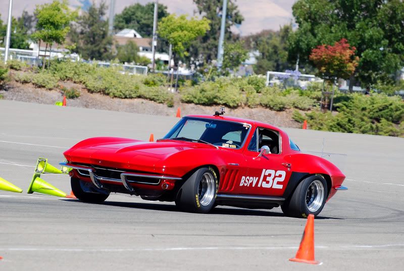

Dan,
We run a spec 15" Goodyear bias slick 25x11x15 front and 27x11x15 rear. It is the GT/GT1/GT2 spec tire. Mike and Frank use a 16" G19 setup. Our local class uses the spec tire to keep the class as even as possible. It is a great tire as it has good stick and wear.
Here is a photo with the Goodyears on it.

I hate to hijack the thread.........but.............I REALLY dig the Corvette. Any more pics? Perhaps a new thread?
