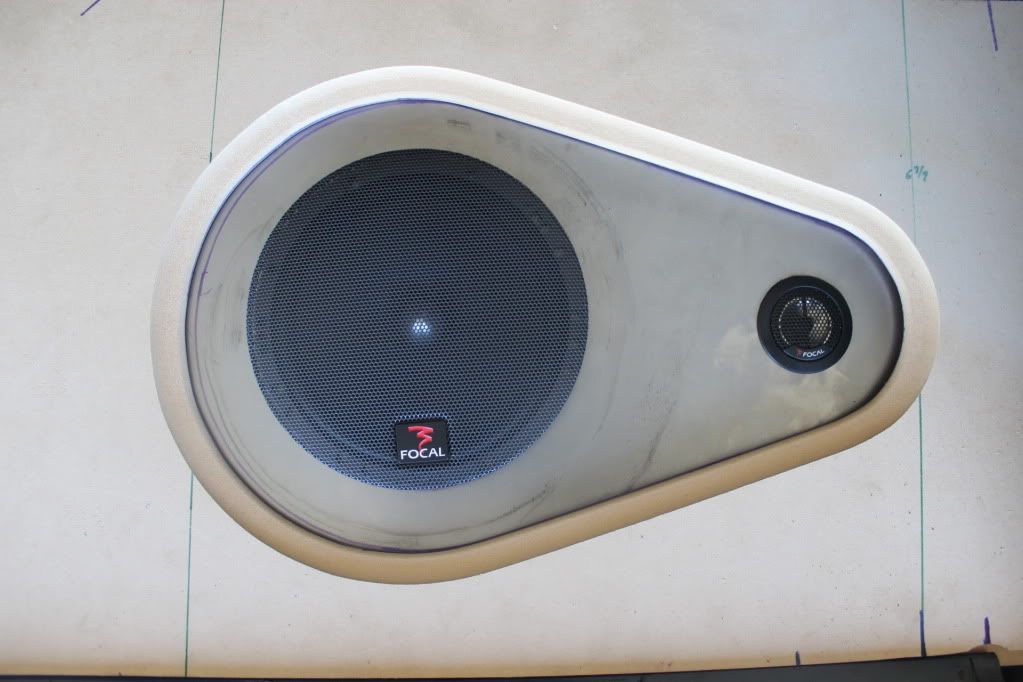

inside edges are now routed. i was hoping to find a bit that left a ledge for the inlay to sit on, but it didnt work out. not a huge deal, but could have been a little easier.
i also started to pull the really old dynamat off the package tray and found a mess underneath. it looks like a few sets of speakers had been installed, so instead of dealing with swiss cheese, i cut it all out and welded some sheetmetal back in. i would have done without any metal and just my mdf package tray, but the upper portion of the 3pt is going through and i obviously wanted some support.

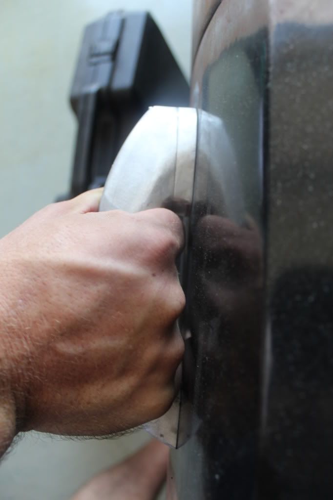

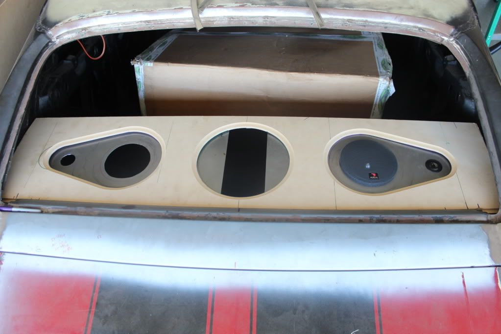

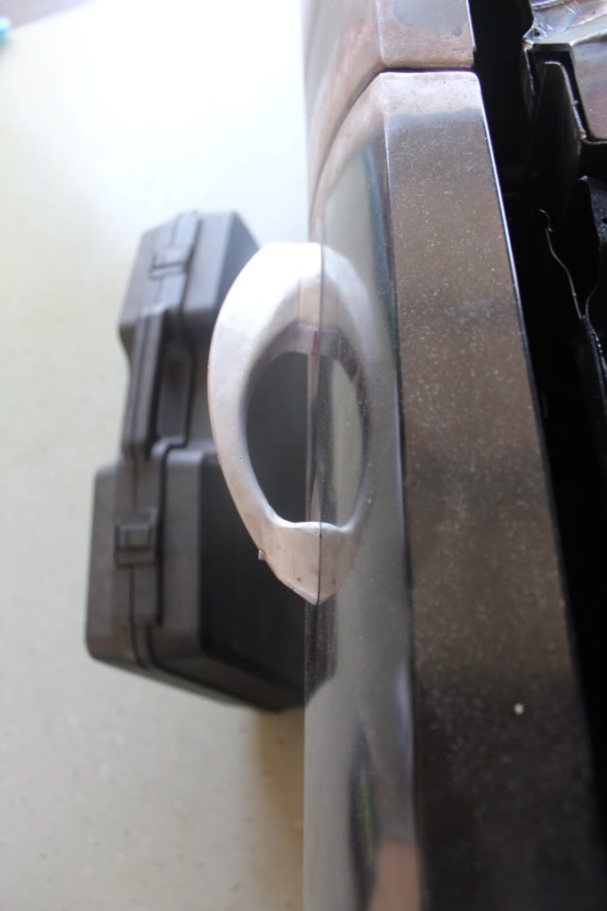

more progress on the interior. got some work done on the package tray. there will be a 1/8" piece inlayed and the speakers will be flush with that. i plan to build the box in the next week or so and finish getting the speakers mounted.
i also added a couple pics of the door handles. still rough, but getting closer. the ring bros handles were WAY too small for my hands so i made some spacers. not sure if i will epoxy or attach another way, but they will get smoothed and painted as one piece.

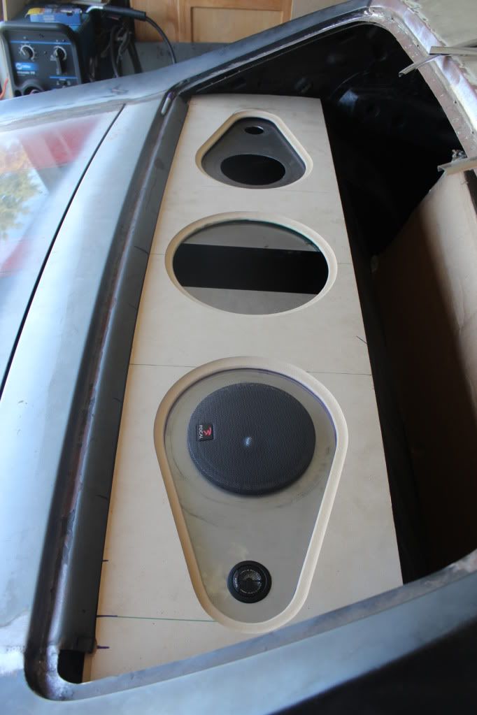

more updated pics. i would call the trunk just about done. i plan on making an aluminum "cover" for the trunk latch hole and i need to remount the new back piece. other than that, its ready for material.
a few people have asked about the back cuts that i used to lighten the panels. if i wouldnt have put the detail in the panels, i could have gone with a thin piece and not needed a back cut. id also wait until done mounting before doing the cut if i did them again.
