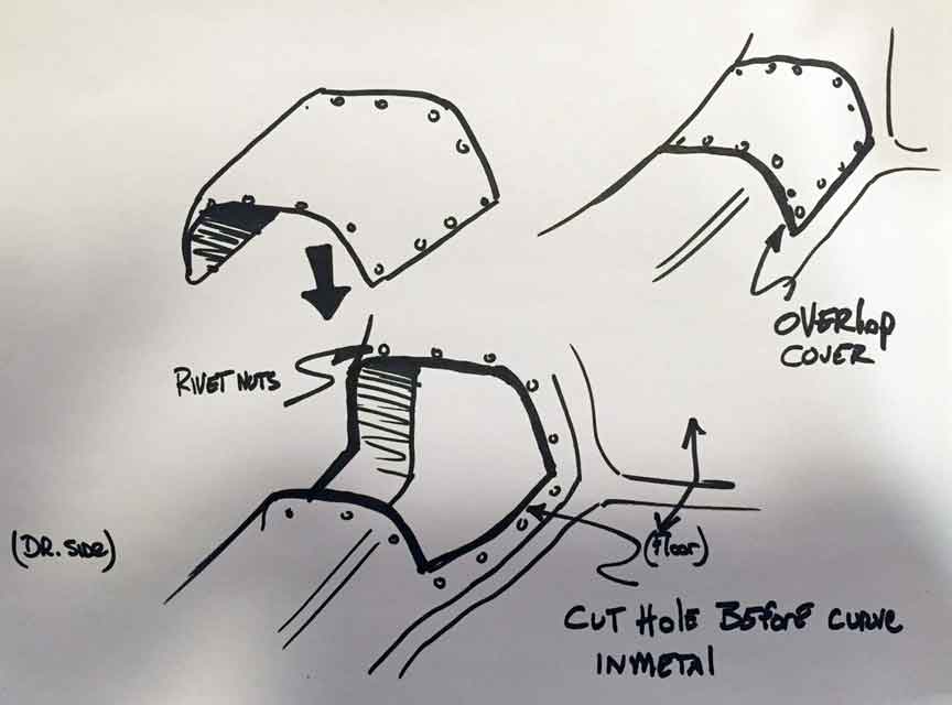

This must be a great idea because I plan on doing that to my car, too, ha ha! (I'll need to do this when I remove my bellhousing next to align it better) If it helps inspire ideas even though I haven't built mine yet I plan on making mine with an overlap of the sheet metal and using rivet nuts so I have an easy way to thread bolts down from the interior of the car. I'll use something like a 3m weather stripping putty to seal the panels yet still be removable.

Understood. Of course, if you're covering this with carpet/ dynamat, etc. you may not even need a flange. A simple overlap should do the trick and should be hidden underneath. To quote Doc Brown " please excuse the crudity of this sketch...." Its rough, and I think I have way too many rivet nuts...
Dude that sketch is awesome! I stared at the car for a few minutes yesterday and thought why do today what I can do tomorrow. I also looked at the kick panels trying to figure out a good way to seal them as I want to keep the vents. At the end of the day nothing got done. Back to the tunnel.. I'm planning to do something along the lines of what you are. I was thinking flange so water would have a harder time making it into the car.
