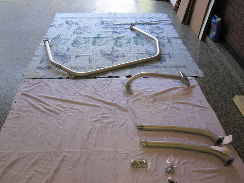

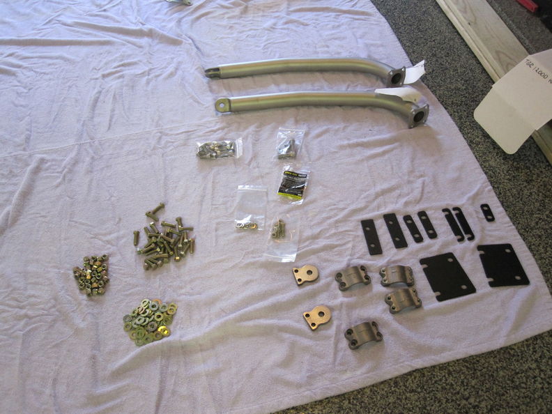

2nd Chance Camaro - Ride Rech Tiger Cage
2012 08-04 Update - 2nd Chance Camaro - Ride Rech Tiger Cage
www.2ndchancecamaro.com

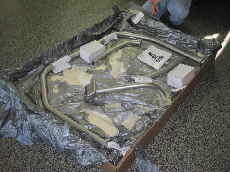

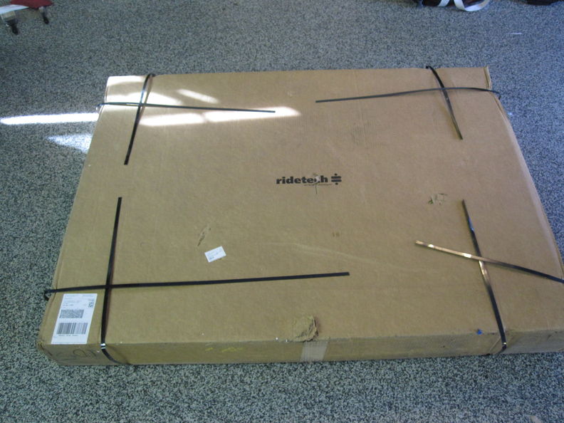

Afternoon All,
More boxes from Ride-Tech
Good thing Scott was over he was able to open the box while I took pictures. It's to bad he's a cuB faN the good news is but he's
still a good guy.
It's going to look really nice once I get it installed.
marty-mj

Cage looks good! Is tha a powdercoated one? I thought they make them from SS? Do you go without the door bars?
  #365
Old 08-04-2012, 03:53 PM
syborg tt's Avatar
Posts: 8,449
Thanks: 5,669
It's their Stainless Version and yep door bars and harness bar has been ordered
marty-mj

Rick D's Avatar
Rick D Rick D is offline
Posts: 3,437
Nice, Marty are you sure that Scott didn't put some weights in the box when you weren't looking!!
Does Ride Tech make the cage in mild steel? I thought it was only SS?

syborg tt's Avatar
Posts: 8,449
Thanks: 5,669
To the best of my knowledge SS only
marty-mj

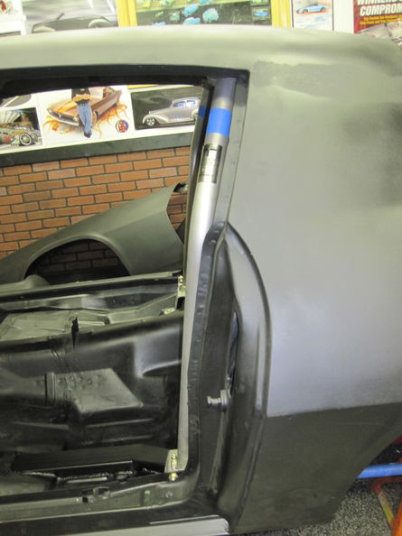

2nd Chance Camaro - Tiger Cage Install Part 2
2012 08-09 Update - 2nd Chance Camaro - Tiger Cage Install Part 2

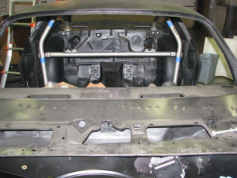

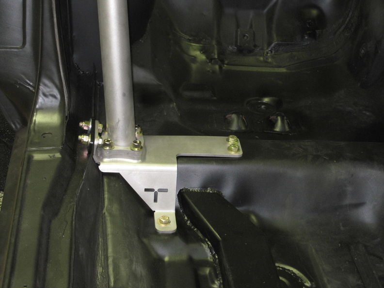

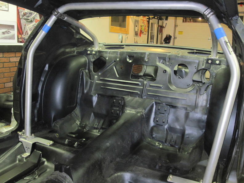

Good Evening all,

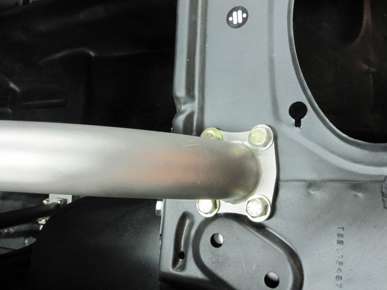

Installing the Tiger cage is fairly easy. I was able to install the complete cage in about 4 hours. However, I did
need a helper to finish tightening some of the supplied hardware

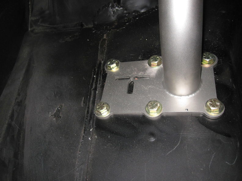

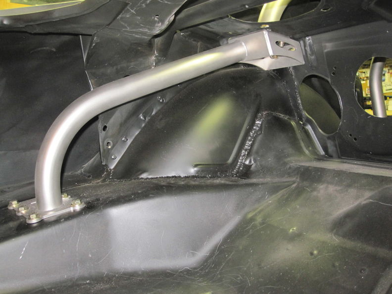

The hoop mounts into the floor brackets which self align for easy drilling.
The down bars attach through the package tray.
Quick look at the finish of the down bar.

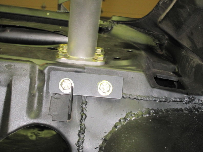

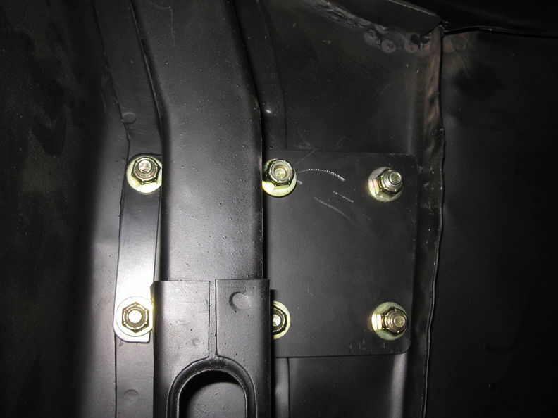

The down bars attach to the trunk floor. I used the frame rail spot welds as a guide to line up the bolt holes.
Make sure you line this up perfectly so it hits the flat part of the frame rails. I used a right angle drill with a
1/8 drill to make sure I hit the frame rail perfectly.
You can see that the bolts hit there mark perfectly. I also had to get tweak the floor just a little bit.
Finishing off the cage I once again enlisted the help of one of my daughters. I also found the perfect use for an
old cotton shower curtain. It makes a perfect blanket for my daughter to lay on.
You can see Ride-Tech did a perfect job when designing the Tiger cage. The main hoop is in perfect alignment
with the "B" pillar.
Harness bar installed.
Pictures hosted by www.garagescene.net
