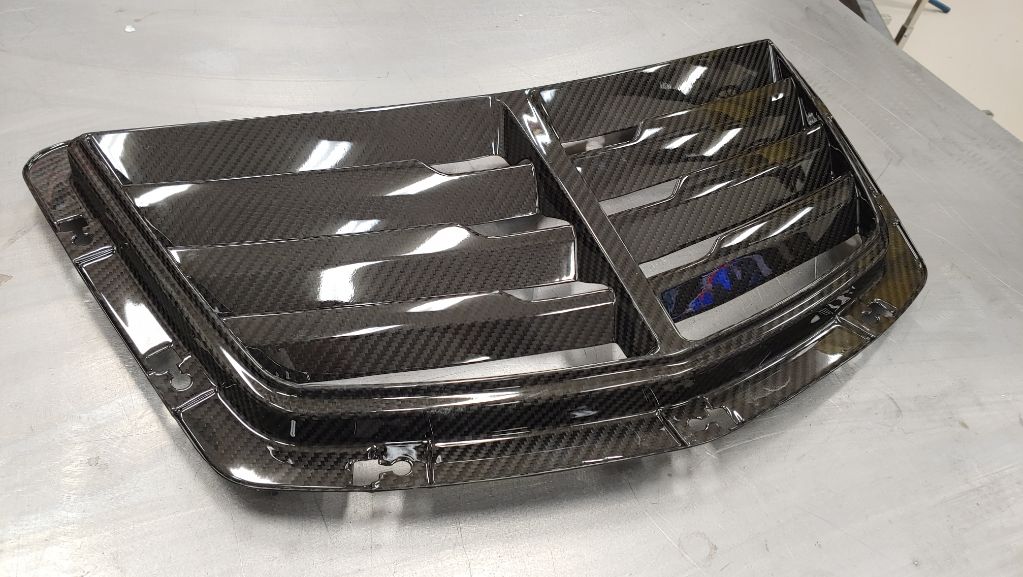

Hood vent - for another day!

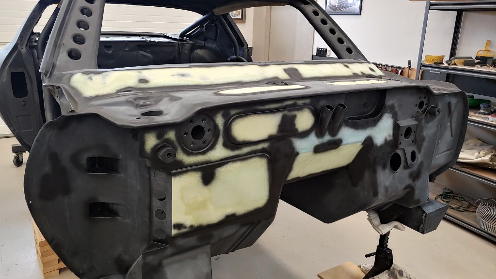

A little bodywork on the firewall

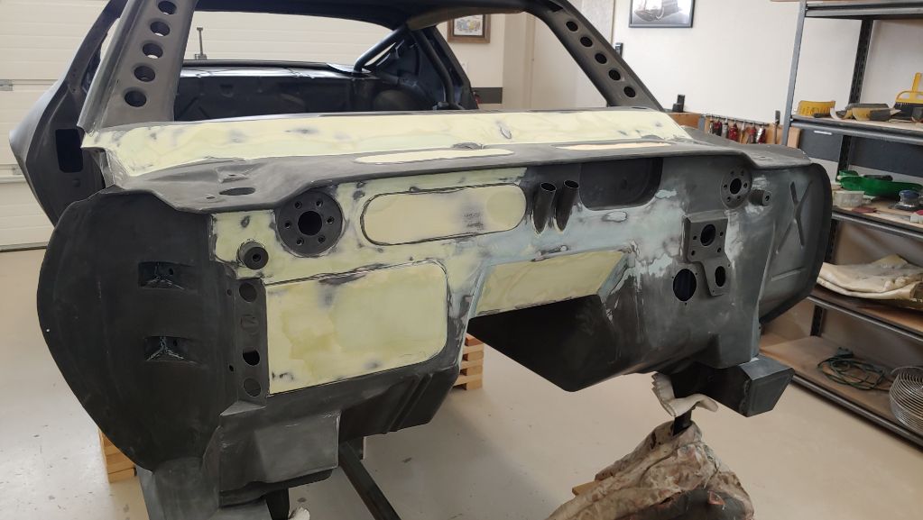

Touched up the epoxy

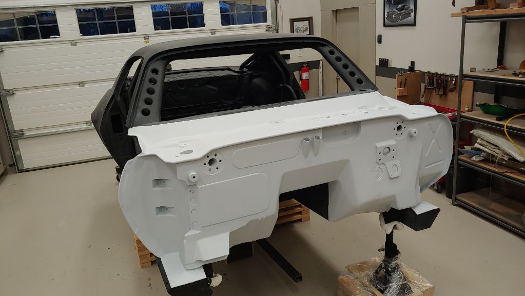

Filler primer....now the block sanding begins.
