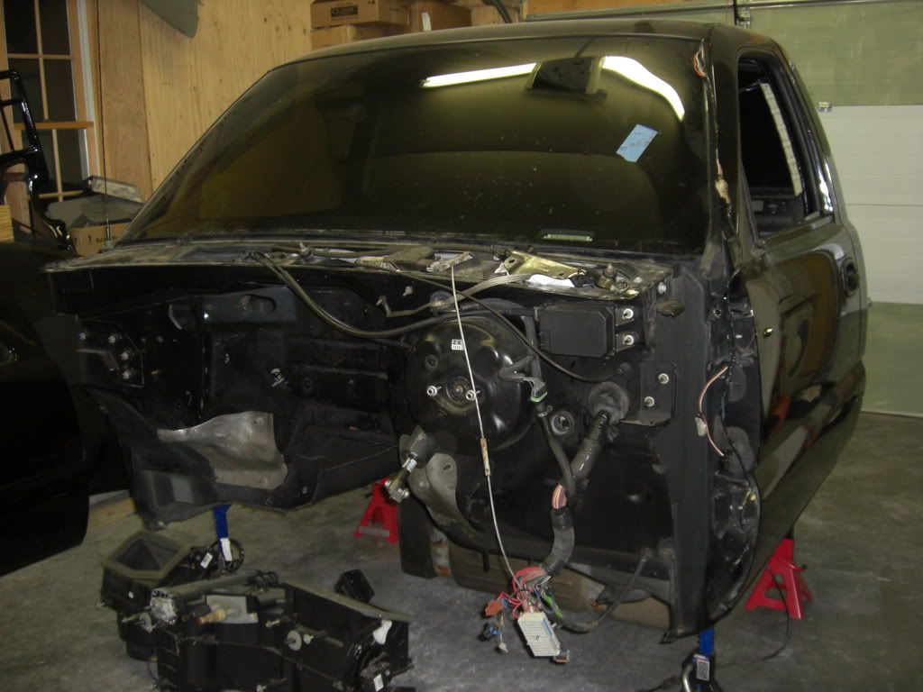

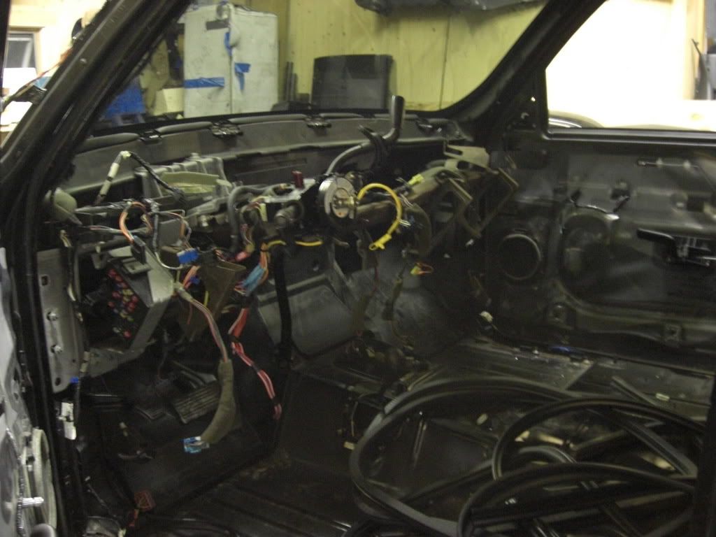

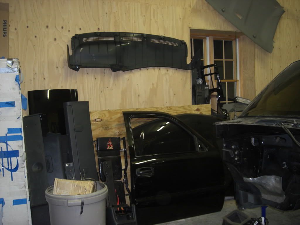

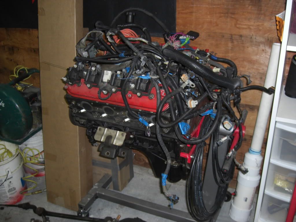

Well I've been lurking this site for a while now, and figured I would share my project, as long as it's cool with you guys. I know it's not a pro-touring car, but the plans for this thing is a mean street machine, that can handle well and put it's fair share of power down on the pavement.
April 2007 was the last time I took a bunch of pictures of it, this being two of them.
July came and after having the trans built the August before I had it blow on me 3 times, all the builder told me were they were bad parts, never got a chance to push the truck much, and was told the trans would hold more than I was asking for, well after the third time I convinced myself I would be careful till I could afford to order a level 5 80e or something similar. Well with my luck it blew again, no reason what so ever I was just on my way to work and it locked up. When the fluid was cold it would move, heated up and it would go anyway. So it went back in my garage, and I convinced myself, not so much my friends, that I was going to tear it completly down and build it frame up.

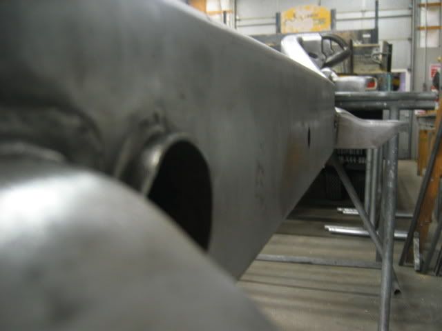

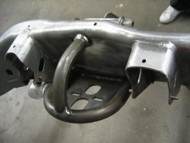

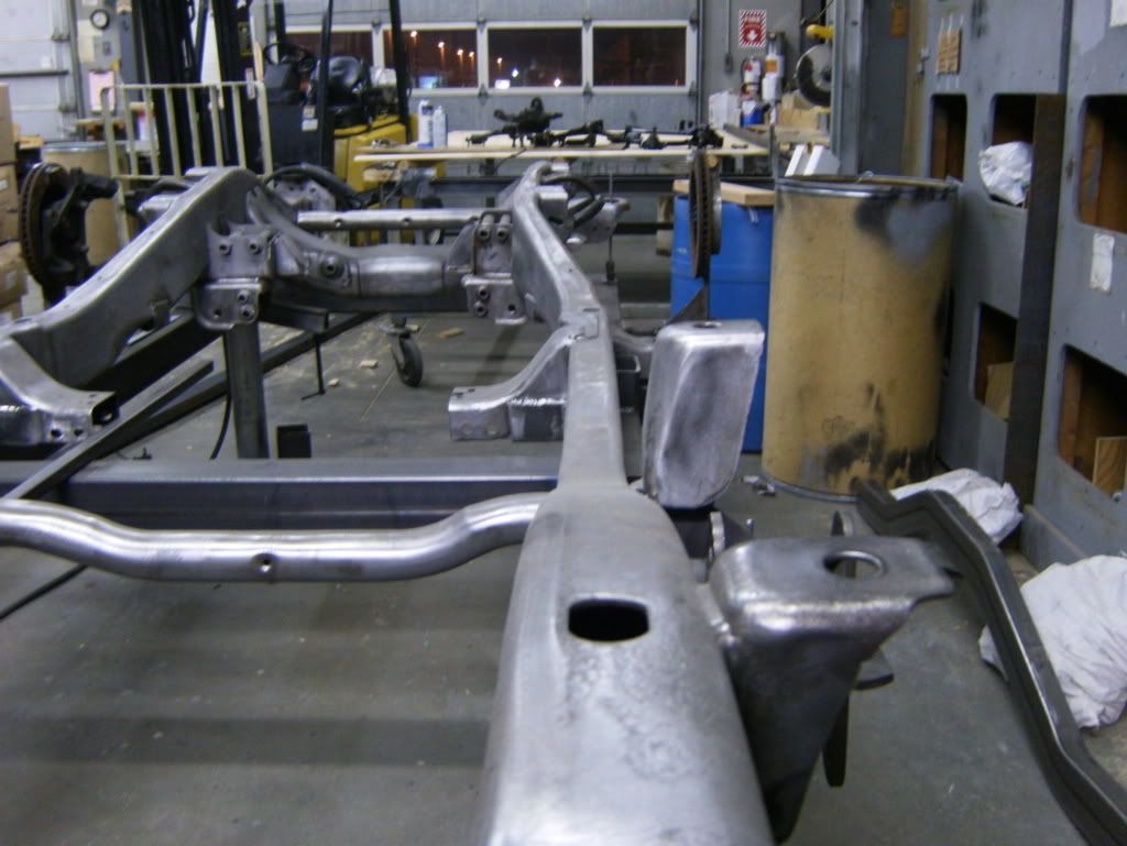

Originally I modified the stock frame, and finished it besides my shock mounts
But I figured with this extensive of a build I might as well build one from scratch.

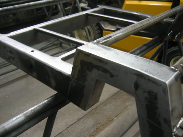

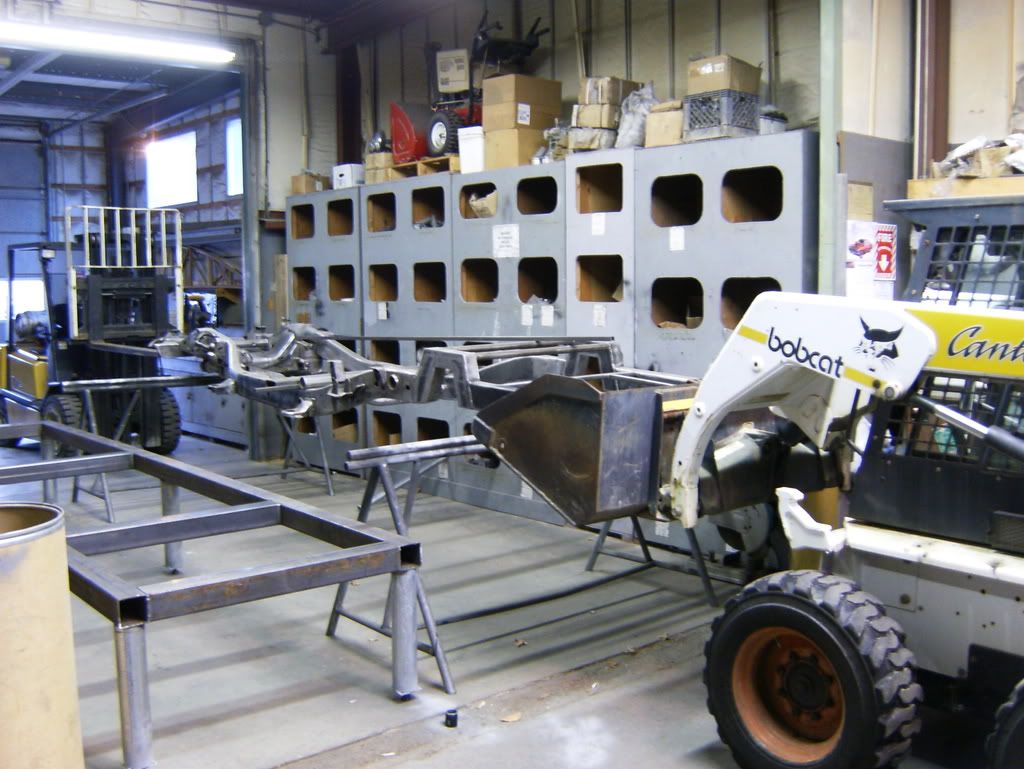

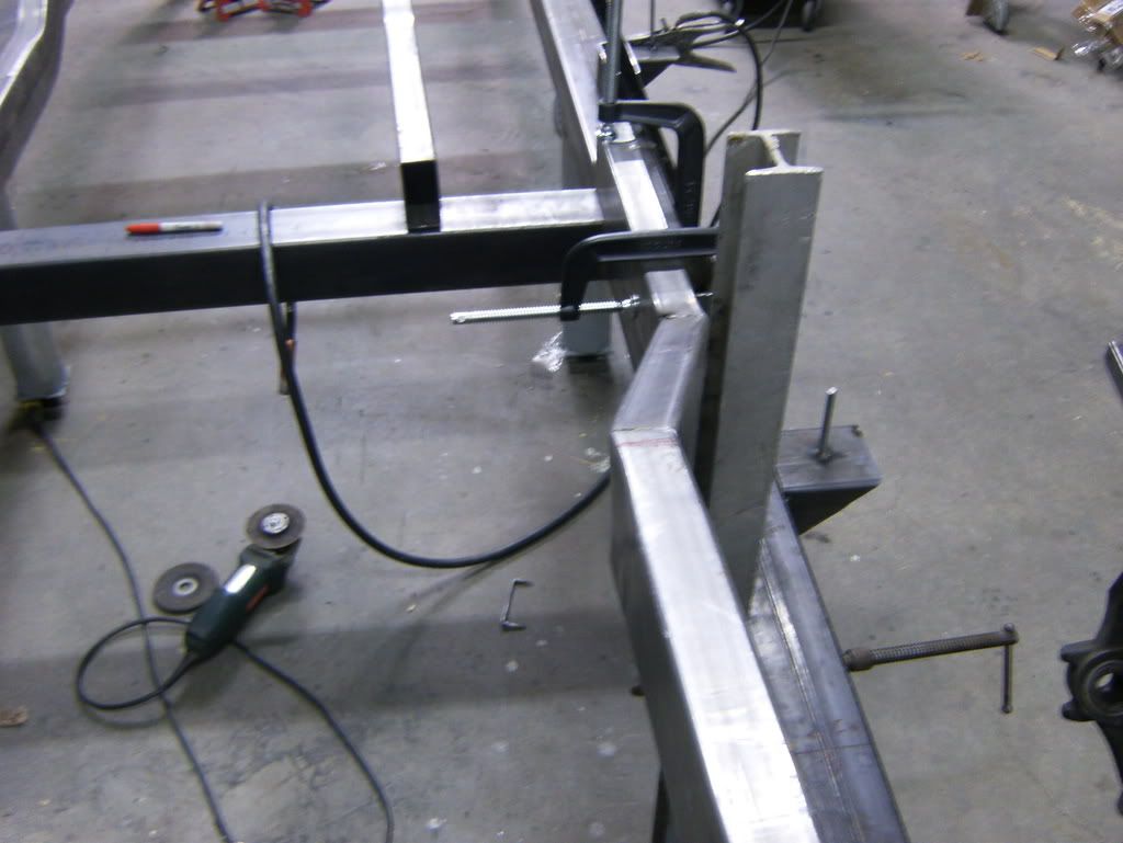

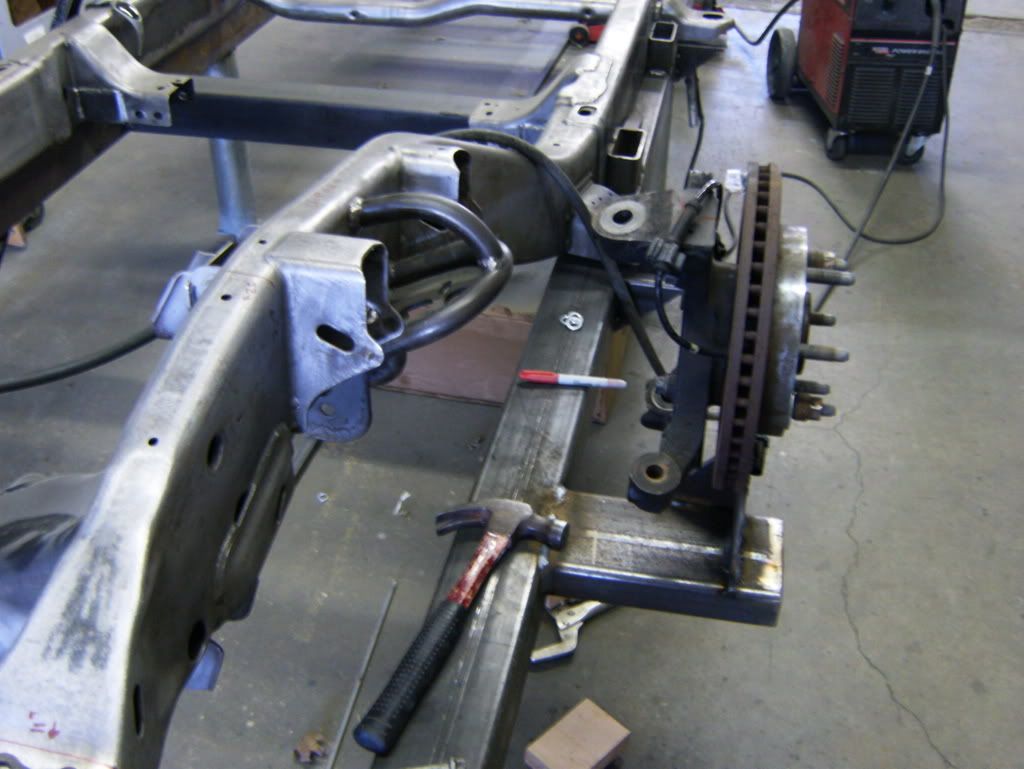

But then I decided I'd rather build my own frame, so I built a table
Threw this frame on it
Jigged everything I needed
Nick Schiffer

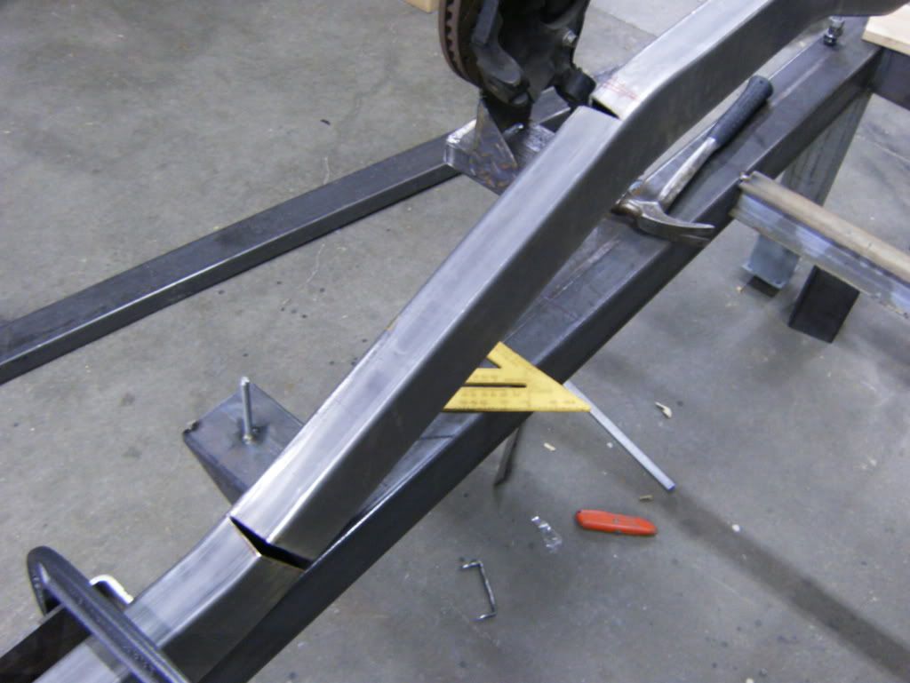

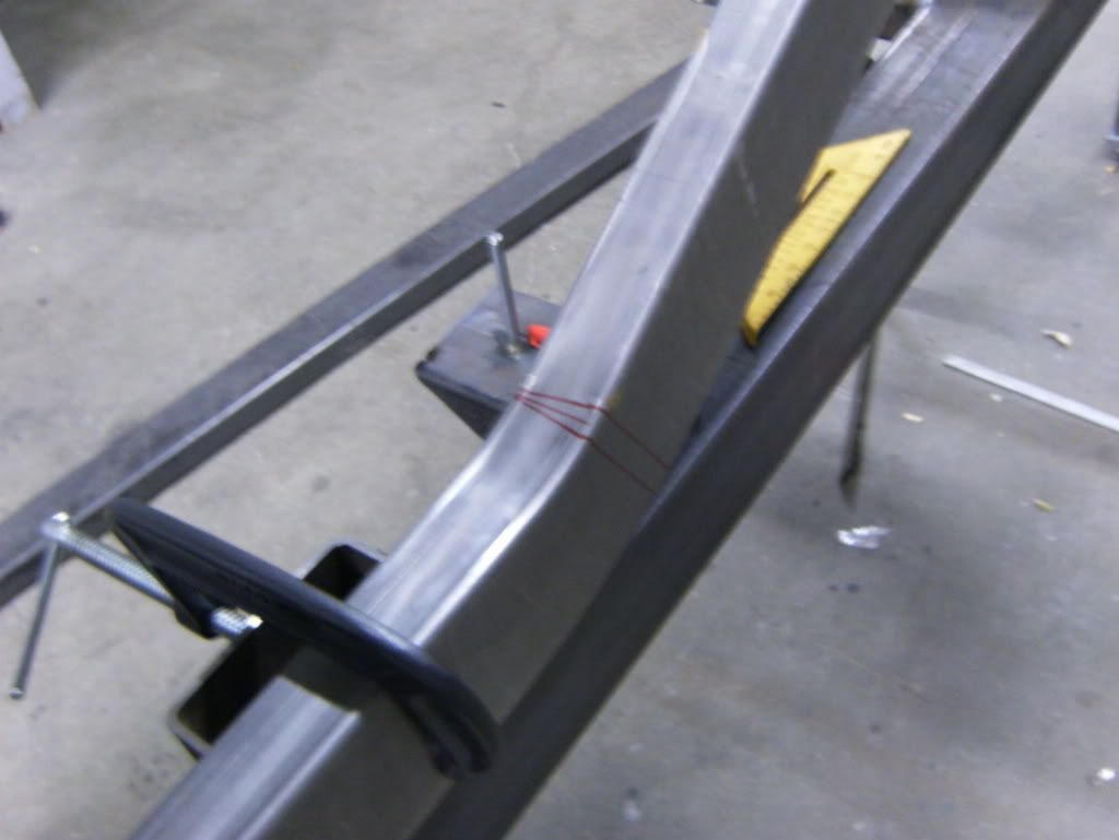

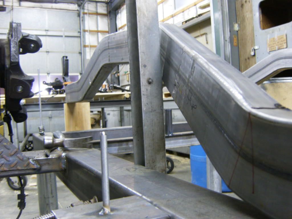

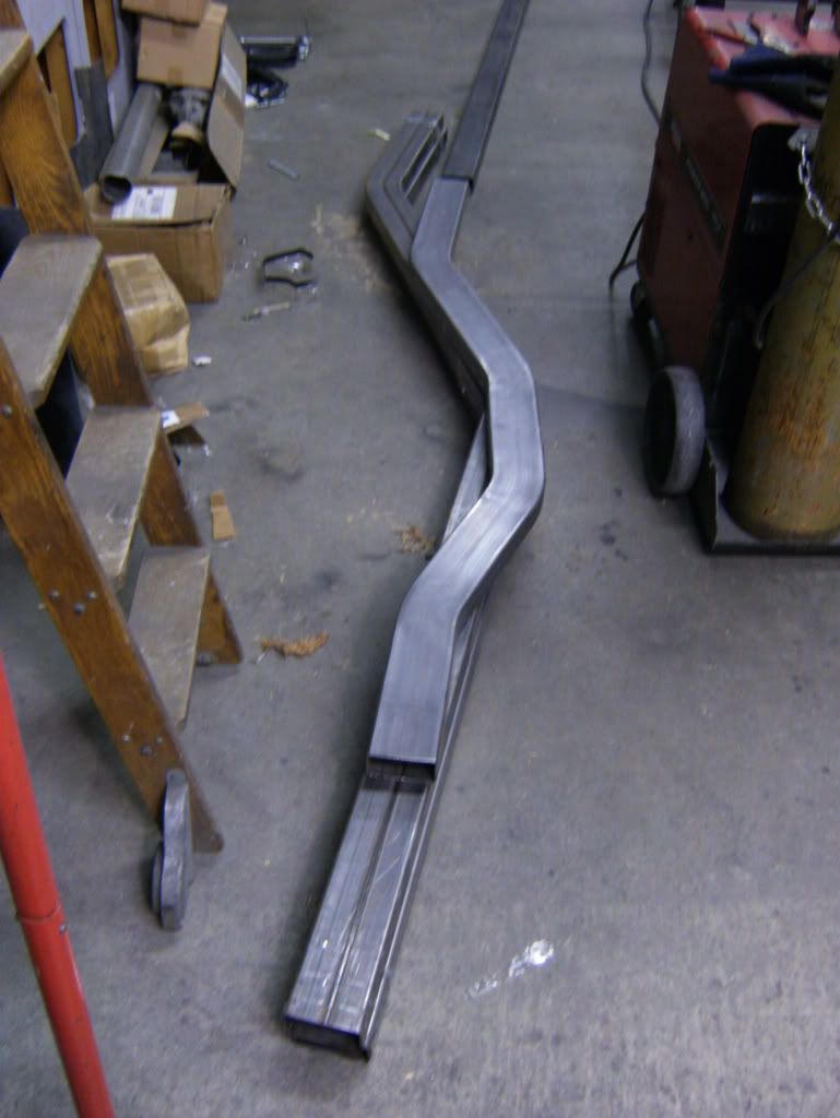

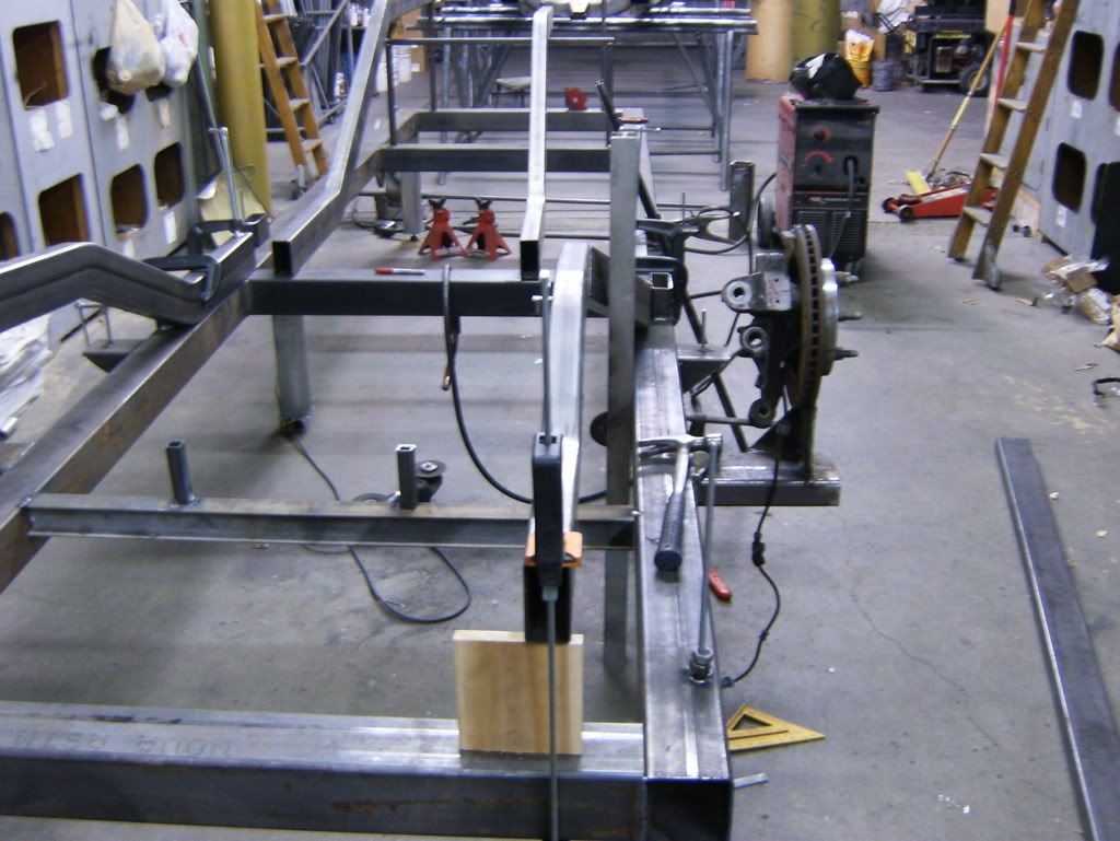

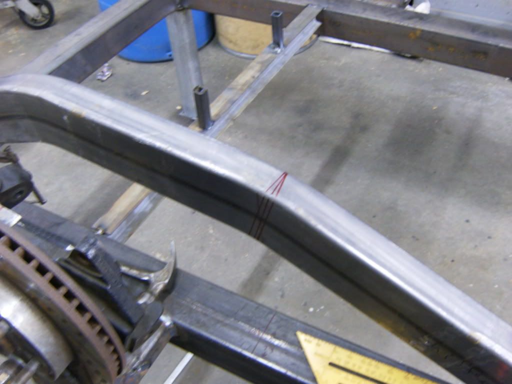

Ordered some custom spec rails from AutoWeld
Starting to lay them out
Here you can see how the stock hyrdoformed frame compound bends in, so I needed to mimic that
Marked the angles

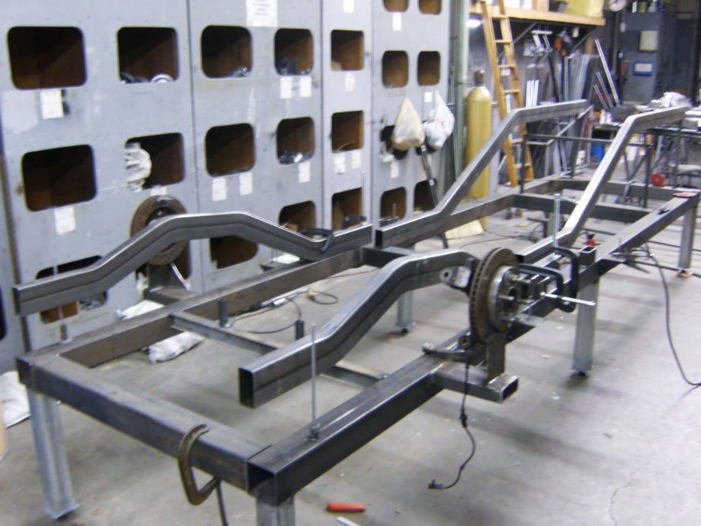

Cut
Clamped into place and double checked everything

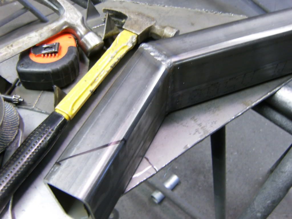

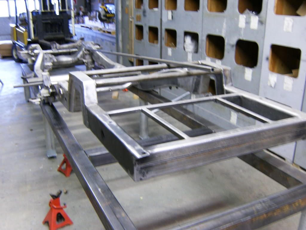

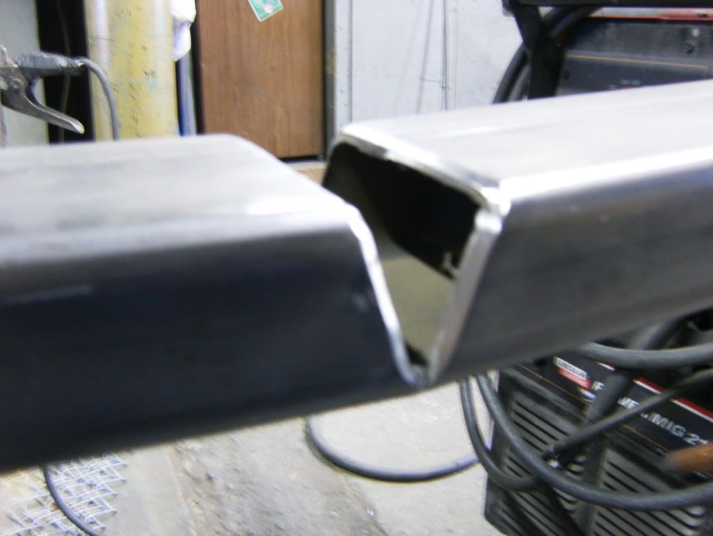

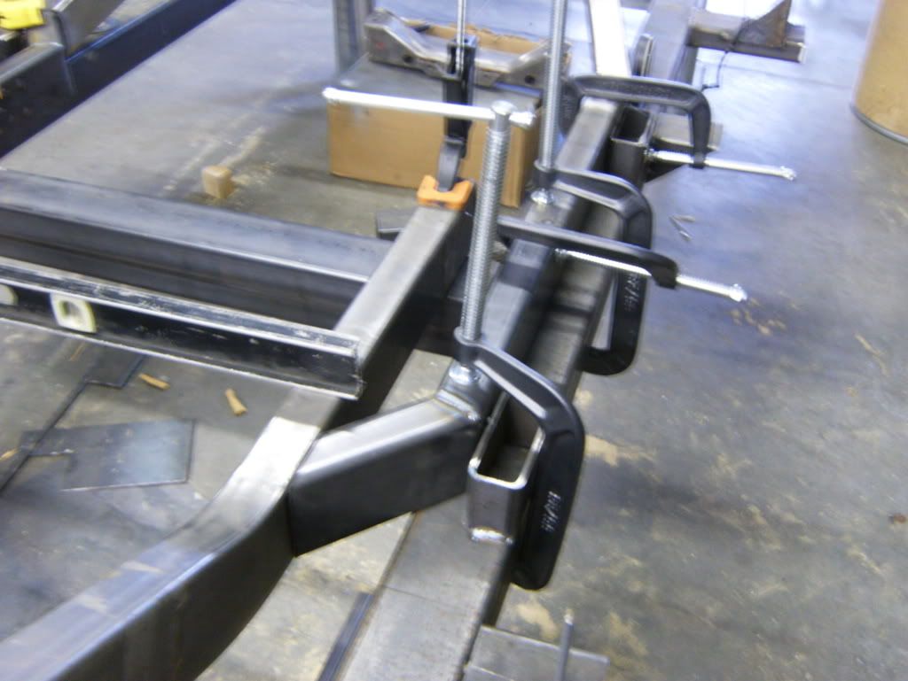

Welded the seams up
Then I used the same method to tie in the rail rails since they were 10" closer together than the mid section
Cut and Bevel
Weld and then mark them for final fitment
Clamping up and getting ready for final fitment
