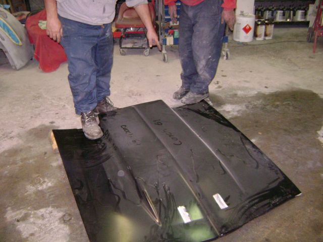

Hood alignment 101!!! Last Sunday Mike and I installed my Fesler hood hinges to do the final alignment and square up the front end. After getting everything square, and the hood flush with the fenders I noticed that the back of the hood along the cowl was to high. So after some time tring to adjust the hood to get it flush I finally came to the conclusion that the hood was bowed ! I figured I would have to take the inner stucture out and push the rear of the hood down and reweld it. Naaaaaa!! Hey lets take the hood off and set a wood block in each corner and push down on each corner of the cowl scoop and see what happens . It friggin worked!!! We set the hood back on the car it was perfect!! Love my aftermarket parts!!!!!! Getting closer to BBT!!!!!

Oh yeah, I have a GM Cowl Hood, and It also had too much bow in it. Tim and I did the same thing, I stepped on it with blocks under it. It fits perfect now.

been there, done that, got the t-shirt to prove it to.

You no what Bob I have a OE cowl hood that I put on just to see if I had something else out of wack .The OE hood fit perfect! Not one issue . I just couldn't justify cutting up a OE hood ..

Been wondering why mine don't line up on the right rear side. Thanks for the info
