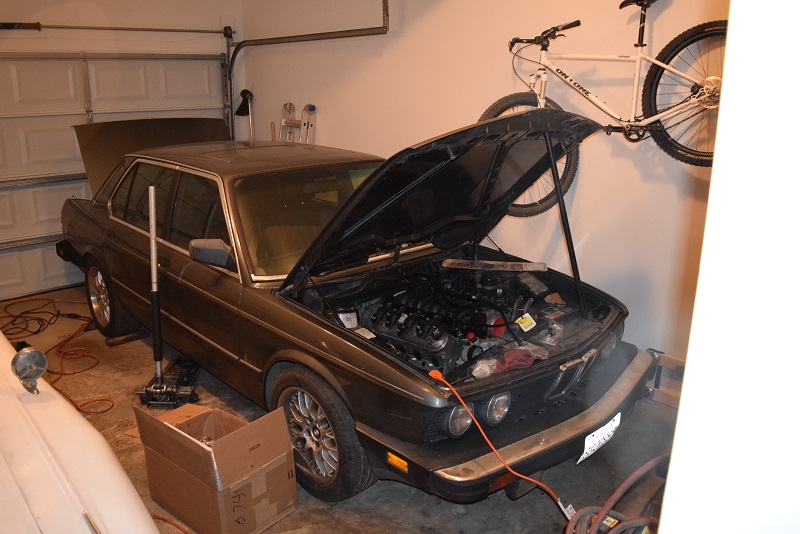

Tone of Volvo idling is absolutely perfect; it's not at all what one would expect, even with the hellaflush wheels. Then again, it's kind of like the prostitute with the adam's apple and a strangely deep voice, if you've had enough alcohol to appreciate the uniqueness . . .
All of our stuff is indeed out here; I think I did the drive (2500 miles) three times between Nov. and Jan. I could do without another hotel stay for the next year or two. The old 12-valve hauled Fritz the 524 out without an issue, aside from the headlights not working after Phoenix . . .
Things are astoundingly cool here, from beer to mountain bike-specific parks to three road courses within two hours of driving (Road Atlanta, Atlanta Motorsports Park, and Barber Motorsports Park). You also get a bit more house for your dollar.
Gratuitous threadjacking pictures follow.
