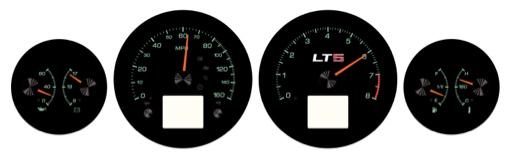

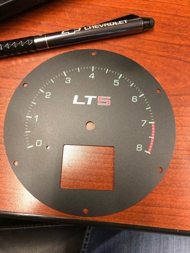

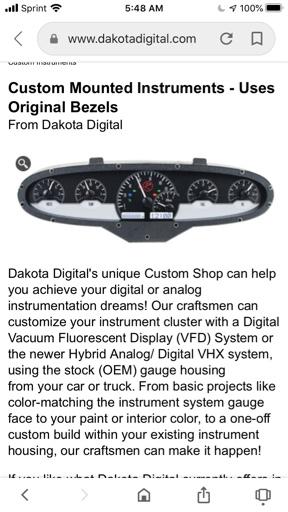

Dakota Digital has finalized my gauges and are getting ready to make them. Great team to work with. They should look great!

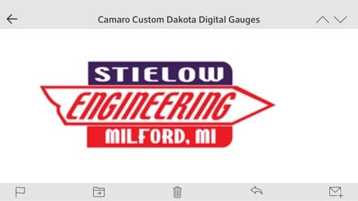

Below the LT5 it should say “Stielow Engineering”
This will be in the digital screen during startup!

The hard part is designing a one off bezel. Dakota Digital made the process very easy.
It is available to anyone.

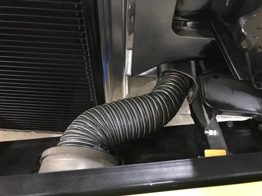

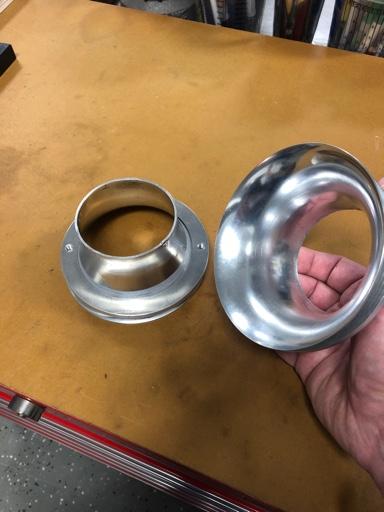

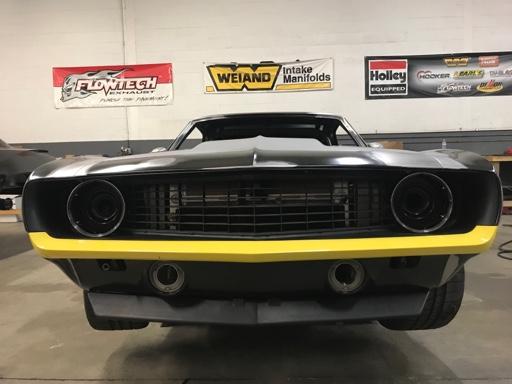

Another issue with big power cars on open track days is brake cooling. I did big brake cooling ducts on Hellfire and they worked great. I did not do brake cooling ducts on Gunner and Jackass and those cars brakes felt soft on track and they killed brake pads.
We looked a few options on this car. Option one add cooling duct to the center of the front turn signal.
I kinda liked it but I felt we need more air flow. Modify velocity stacks.
Now I gave a 5 inch opening that will funnel air down the hydra formed DSE frame rail and dump air on the brakes.
Stielow Engineering
