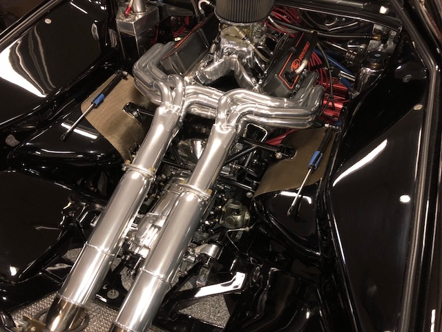

So finally got the motor dropped in yesterday
Had to do some cleanup in the engine bay, etc
I installed some DEI Lava rock vinyl at my chassis brace
area (gold color material in the pic) due to cracking of the
bondo etc that was done around the braces... so instead
of repainting the engine bay will give this a shot.. hopefully
it holds up under the 180 headers.. my buddy has some on
the underside of his fiberglass deck and around his fuel cells
that are really close to the headers
Now to hook up all the misc hoses etc... good thing it was
run and the cam is broken in
Bob

  #384
Old 02-26-2018, 01:02 PM
Break-in is not required for roller cams..... Just sayin'
Looks good Bob.
  #385
Old 02-26-2018, 02:00 PM
Panteracer's Avatar
Panteracer Panteracer is offline
Join Date: Oct 2013
Location: SF bay area
Posts: 1,184
Thanked 306 Times in 122 Posts
Default Dreamin Tas
We decided to stay with a flat tappet... worked for 10 years
on the old engine...
We upped the compression by a point plus, flowed the heads and had George
at Clay Smith spec a new cam after talking to me a bit
Cam is a little less lift but 10 degrees more duration
I wanted a little more on the top end and really could lose a
little on the bottom end-trying not to blow the tires of the thing
Pistons are Racetech lighter units with a light wrist pin
Just honed it .005 and reconditioned the Kryptonight rods,
Polished the crank, new oil pump, rockers and all new exhaust valves
and that was it
We will see if it does what I want
I also fixed the problem I had with the clutch hanging
up.... The shaft that the throw out bearing was riding on
was buggered up and then it would scrape up the throwout
All new pieces and I cut a relieve in the throw out for grease
so it won't happen again
Bob
  #386
Old 02-26-2018, 03:18 PM
Posts: 6,575
Thanks: 1,543
Thanked 855 Times in 643 Posts
That's a gorgeous picture, Bob. Congrats on getting it back in the car. Now, don't be shy. What kind of numbers did the engine make?

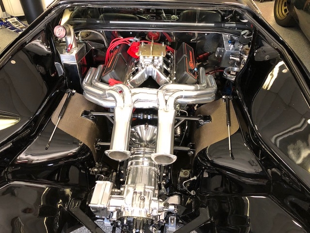

Pantera engine all installed.. sounds pretty
good but did not drive yet as it was raining.. maybe tonight
Thunder Hill test in three weeks with Checkered Flag Racing
Bob
  #390
Old 03-22-2018, 08:47 PM
Posts: 6,575
Thanks: 1,543
No mufflers or resonators? Good luck, Bob!
