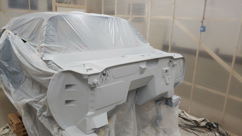

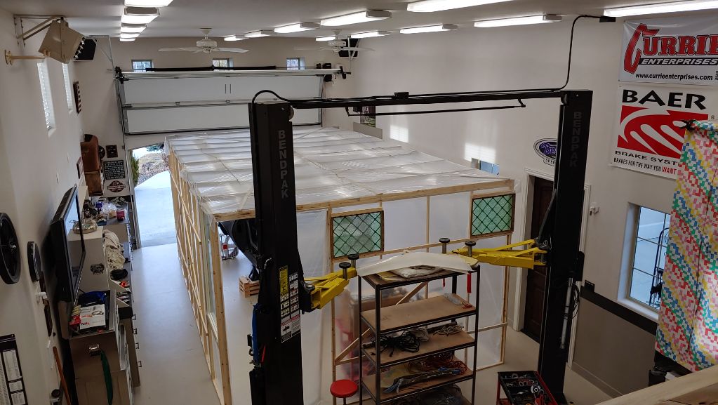

Built a temp booth so I could contain sanding dust, as much as possible, and so I could spray primer. Just trying to manage the mess a bit.

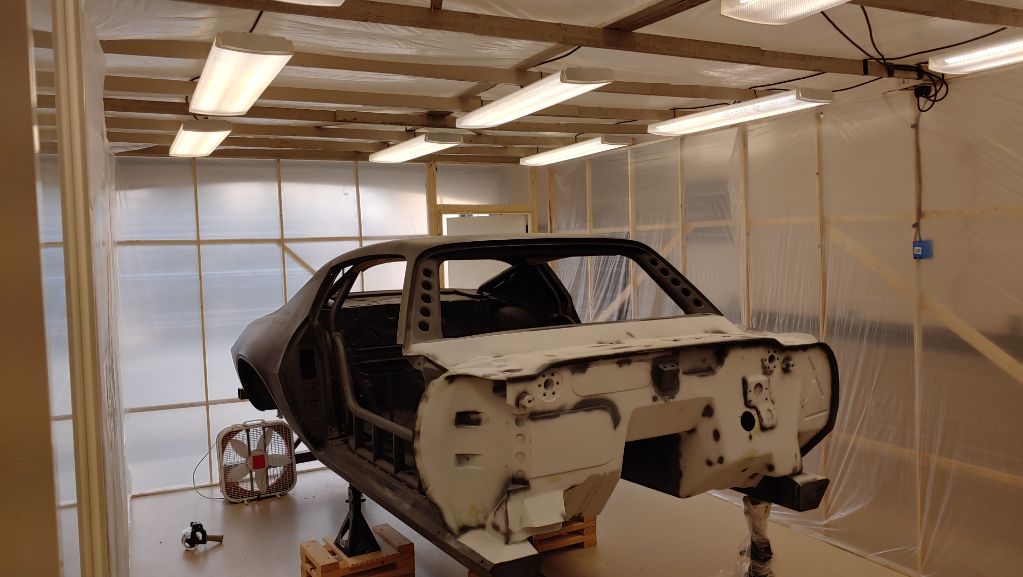

Sprayed a final coat of polyester on the firewall. I will block it and paint next.

Great work on the booth, my garage will need a full overhaul once the car heads out to paint as the poly dust ruins everything!

Thanks! So true. I tried to convince myself that just doing the firewall wouldn't put dust in every possible nook and cranny within a 100' radius. Lying to myself when I know better seems to be common for me.
Bet it feels good to be so close to paint. Nice!
