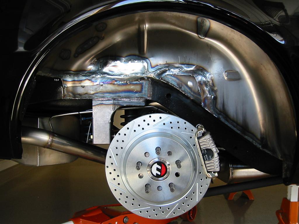

Man, TIG welding the entire rear was painstaking!
What a chore.
Is there a reason you decided to TIG vs MIG? Just curious on your theory.

Tom, yes we had to support the car very well. The car was on a level steel
work platform then braced firm. This is all very important as we cut across
the whole trunk. Not a place to shortcut if you want the car true. We also
put the SFC in so this support helped that come out good.
The car has ATS spindles, as for the welds being TIG Rich there is no real
reason. The work was indeed tedeous, Ryan deserves huge credit for alot of
great welding in awkward positions. It took alot of time & massive amounts
of material.

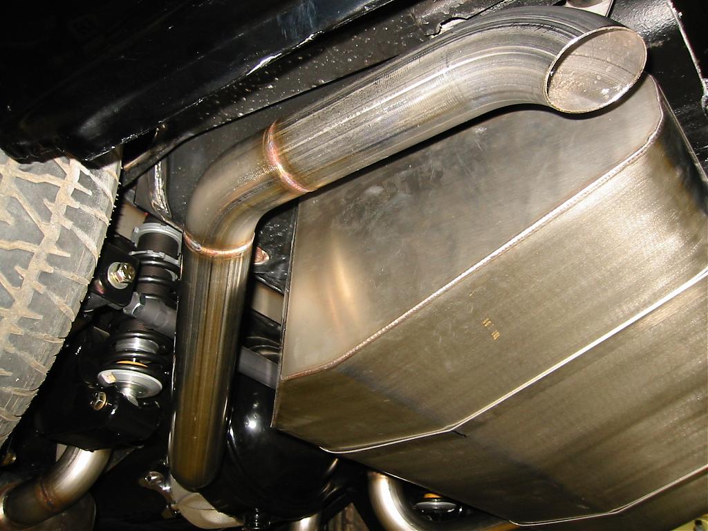

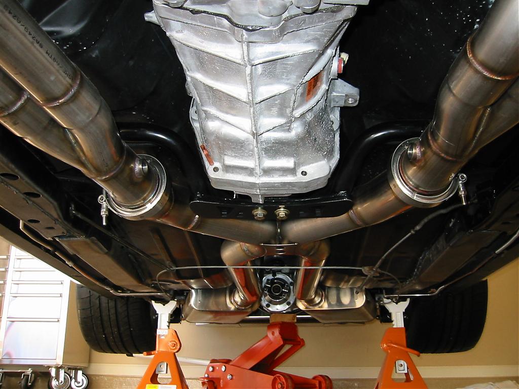

The pics of the tub & Quadralink install are the most recent. They are also
fabbing my intake tube & exhaust system out of pieces I brought them.
It will be ATS headers to 3", 3" fabbed X-pipe (earlier post pic) 3" back to a
set of 2.5 Corsa mufflers then full tail pipes.

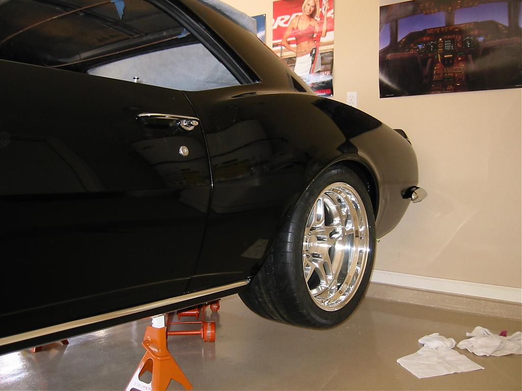

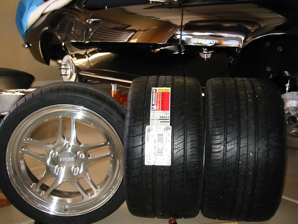

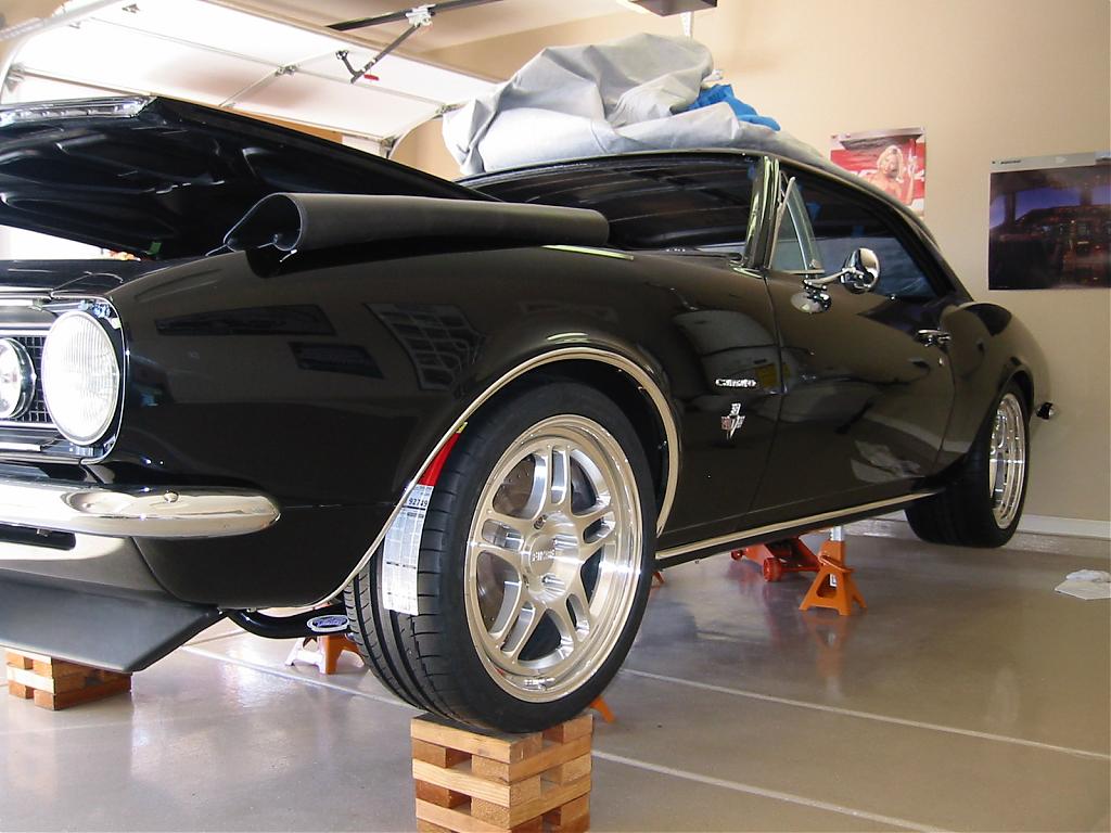

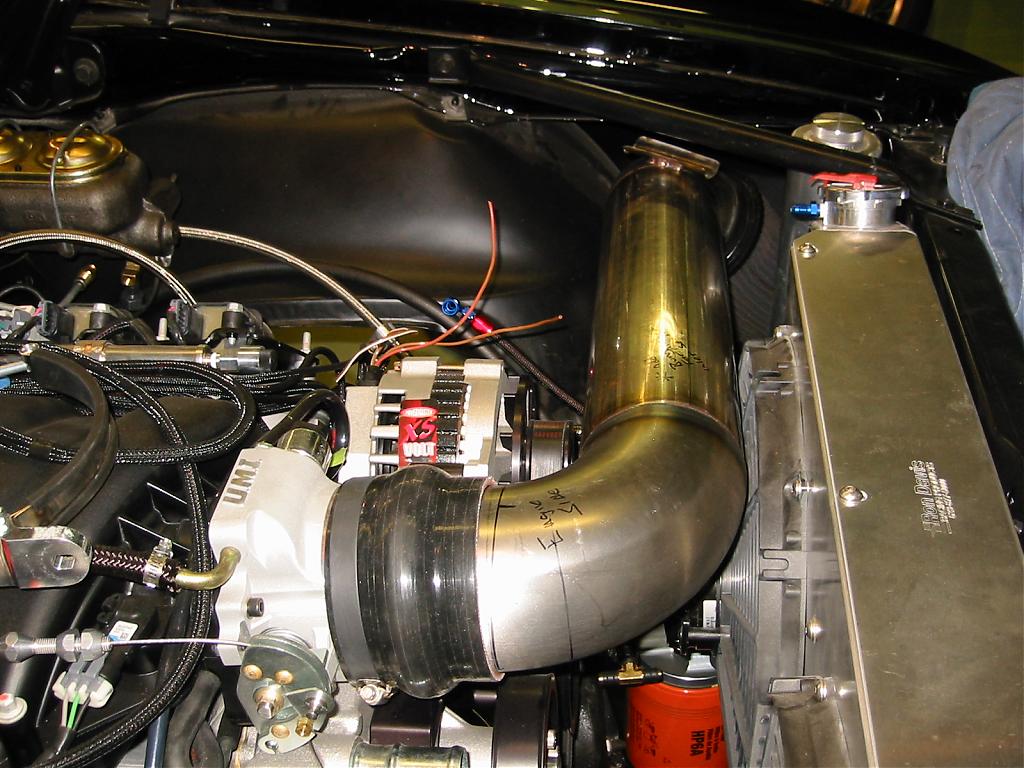

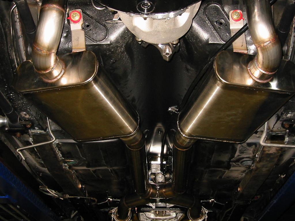

The Quadralink is in & the SS 3" exhaust is in. Fabbed X-pipe, 2.5" Corsa mufflers, full talepipes.

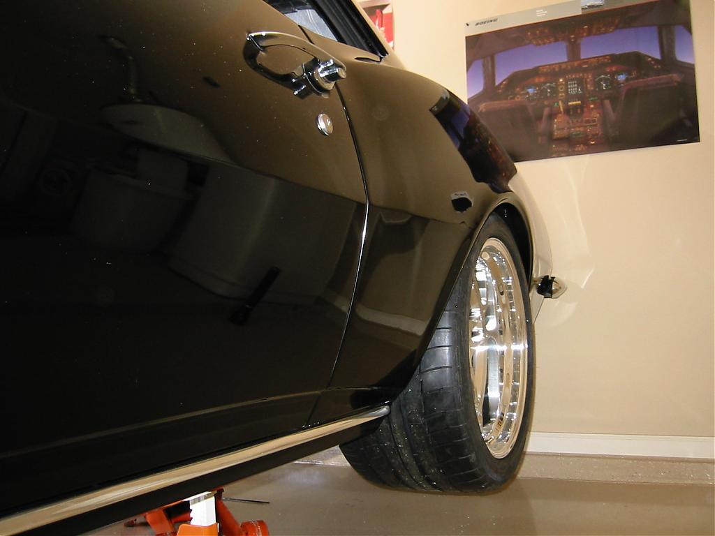

I just recieved the wheels Fikse Profil 5S.
Front 18X8 245/35 Michelin PS2's
Rear 18X11 315/30.

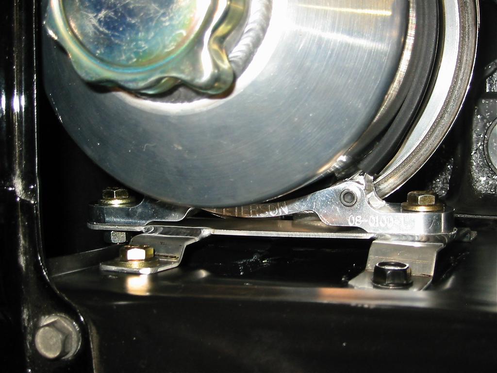

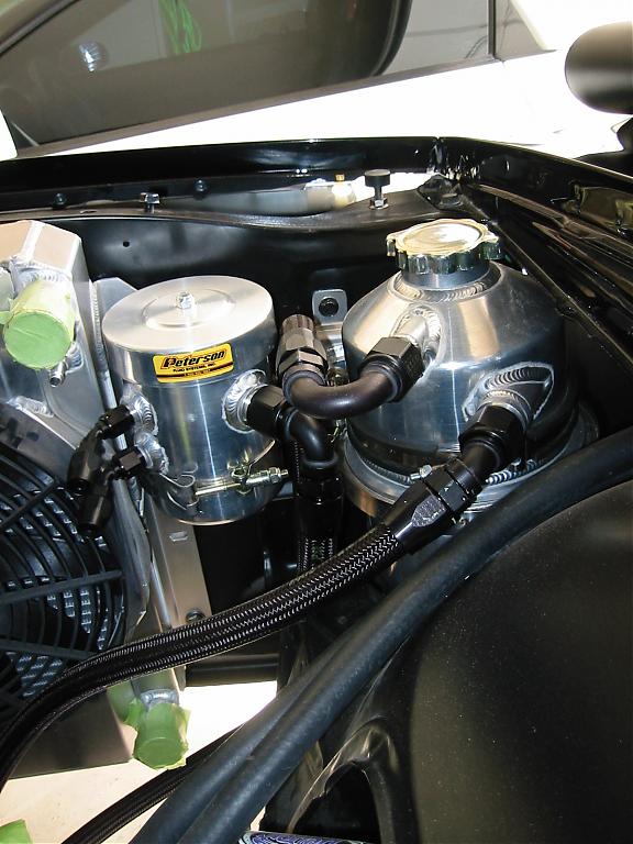

SS exhaust, oil tank brackets, intake tube.
