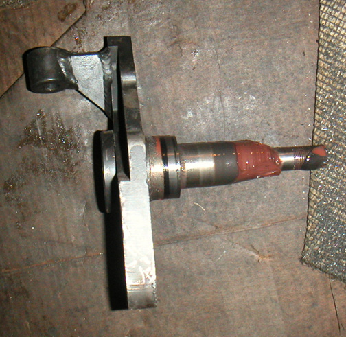

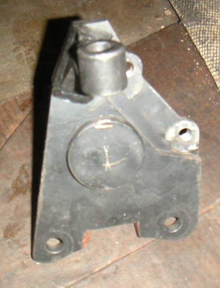

The car with the notched frame does not run FATMAN dropped spindles.
The owner did buy a pair, mocked them up, then put them for sale. The construction is weak at best and when you call them to ask tech questions they have NO clue about the design considerations or any geometry of the spindle.
The cast/forged 2" dropped spindles are a much nicer piece.
Here's a Fatman 2" dropped spindle.
