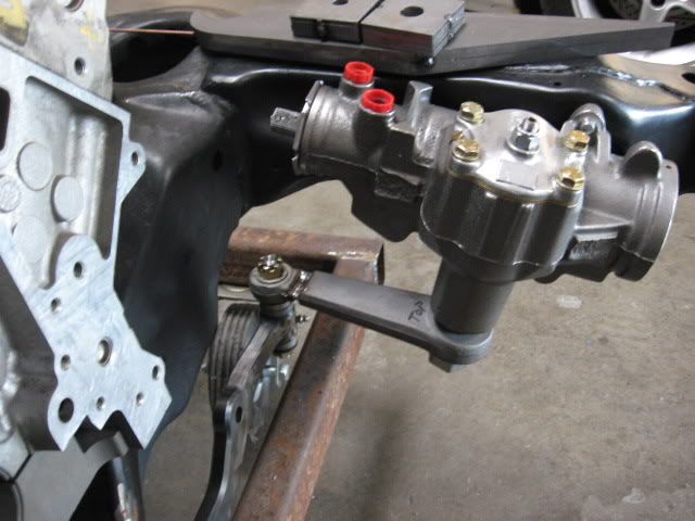

Brian, one other thing that I noted is what appears to be the Howe drag link. I have one that I have played with too, but a caution. The unit I have is designed specifically for the circle track cars, and as such has different left to right steering angle output/Ackerman. Not designed for both directions, I'd take a good look at that. Shame, it is a REALLY cool and functional piece. I can check the part number on the one I have, but it is the one listed in their catalog of two years ago, I don't "think" they have changed it?

You are 100% correct. We found out after we installed all the steering parts that the center link is for those folks that like to only turn left. We ended on modifying the Howe link so the Ackerman was the same left to right. We were scratching our heads for a little at first. Thanks for the heads up!

We ended up removing the bend they put in the center link and straightening the pitman arm. Everything seems to measure out good now.
You can see in the first photo the bend and reinforcement Howe adds. We removed that in the second and third photo.
Fantastic!!!! Great idea!!!!! I hadn't even thought about modifying this one, I threw in the towel when I found the issue and decided I'd have to build one from scratch, well done guys! You made my day.
Cheers,
Mark
EDIT: I also noticed the pitman arm, the issue was probably exaggerated in my measurement due to using Howe's billet pitman arm, it's really short. I have since bought a stock replacement, I don't recall it having the bend like your photo, I'll have to take a look at that.
