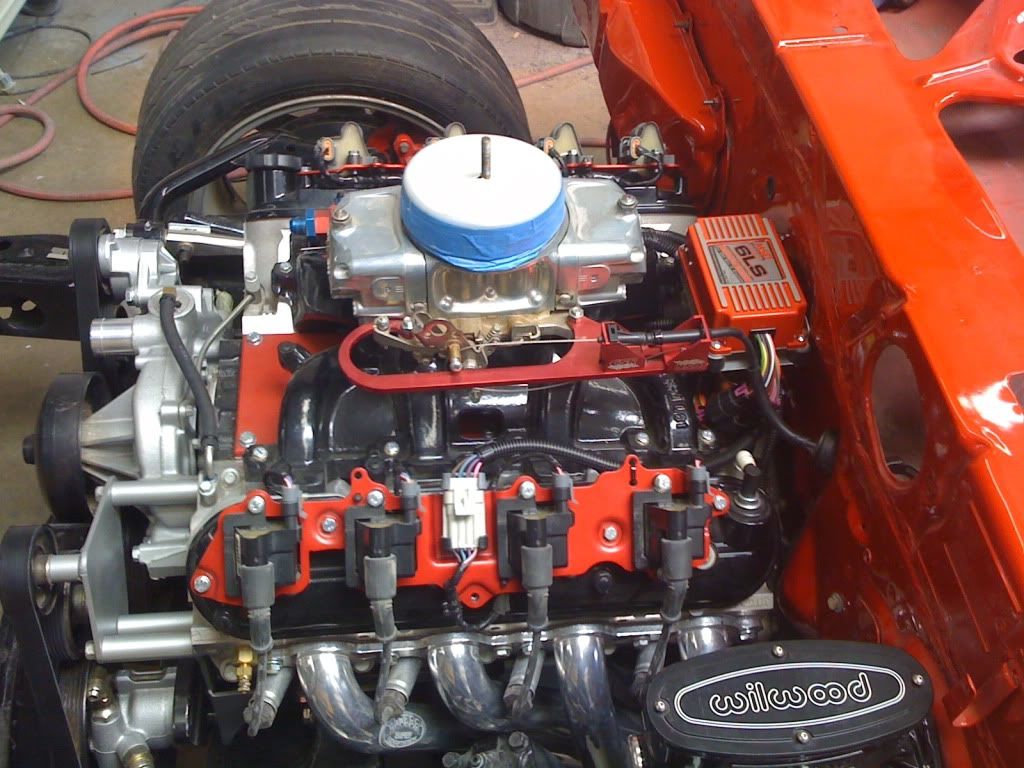

i also installed the Hooker long tubes and 6ls computer system.
(sorry about the size of the pics, firewall at work here is funky)

Nice Brantley! Who's coil mounts are those?

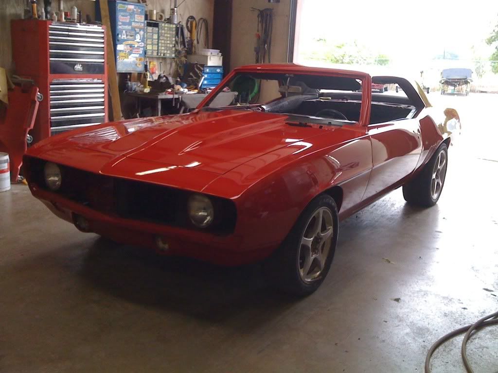

well the car turned out great. we are going to let it cure out in the heat for a few days then knock it down with some 600 wet and reclear it. they always seem to turn out extra slick that way...
the color is gm9260 with a tiny bit of blue pearl (to kill the orange)
all of the trim and chrome should be back from the powder coater anytime now.. i got everything done flat black..
