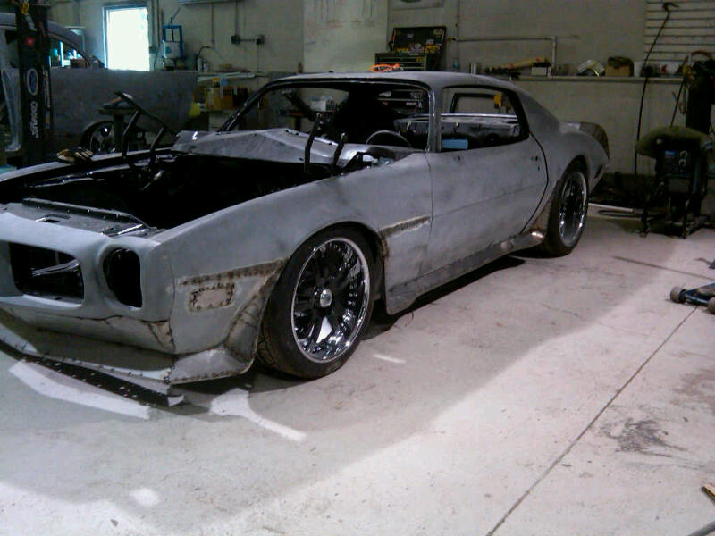

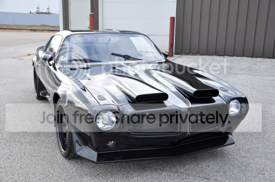

As for the body, the plastic injected front spoiler and rear wing were scrapped for real metal. All Speed was concerned about the structural integrity of trying to blend the plastic and metal as it would result in separation at high speeds. Everything on the car is now metal except for the fiberglass nose and hood.
The chin spoiler is complete. Now we just need to cut in the lower valance openings and we are installing 3” running lights below the headlights. This car originally had square turn signals below the headlights, but we are installing an integrated headlight and turn signal thereby leaving the space below for some tasteful running lights. We also closed out the side marker lights for the front and back.
The front fenders have been widened by about 1” and are cropped by front wheel flares that carry into the side skirting and rear wheel flares. They will finish the flares behind the rear wheels this week which will tie into the rear diffuser that will run from the rear bumper (that will be tucked) to the axle. The rear diffuser will include the cut-out for the custom exhaust manifold that exits the rear.
The fender vents are being built and will be finished this week as well. They will be fully functional to create more down draft on the front.

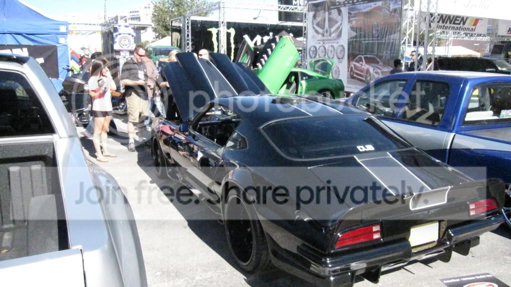

The rear spoiler includes the cut-out in the middle to carry the indentation theme from the roof to the trunk lid to the rear of the vehicle.
The hood scoops have been enlarged for height, width and were brought forward 3” and back about 5”. This will compact the look of the front nose. The scoops will be functional and tied into the turbo system.

Here are a few shots of the chin spoiler after the first pass with the grinder.
Fenders were widened and side skirt added.
The rear spoilder has been enlarged with the center cut detail and rounded edge.
