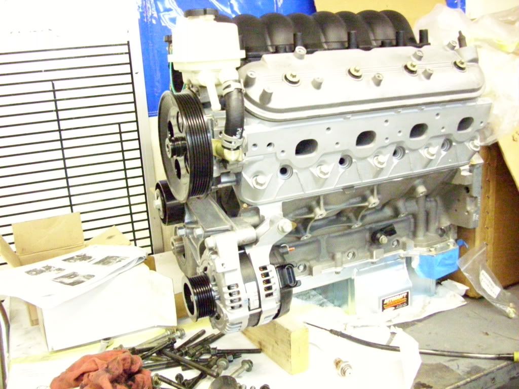

We ran into a little hiccup that was resolved by an awesome vendor. In the picture, you can see the killer CTS-V accessory drive system that keeps everything in close and mounts the alternator way down low on the driver's side..... Right on top of my Lee steering box. The car and the motor were never in the same room until the swap started and bonehead me immediately went for the cool looking drive never thinking about side effects so I called Pace Performance to see if just by chance they might have a relocation bracket to save me from having to replace a $500 drive and they simply said to pack it back up and we'll swap you straight across for a Corvette drive! I'm so grateful so that is why there's no drive in some of these pics but that will get fixed very shortly.

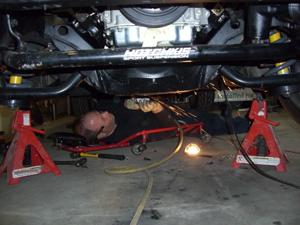

The Powerglide crossmember actually works with the new 6 speed with a couple slight modifications including cutting a tiny notch in the dead center and scooting it rearward a few inches.
