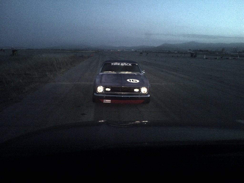

Your Camaro looks GREAT!!!

Here's a writeup of its first race weekend:
http://www.rhoadescamaro.com/build/?p=1845
Also have an in-car video for download, it is somewhat large though (~180MB):
http://www.rhoadescamaro.com/build/w...urDay2Run2.mp4
A long way from where it needs to be handling-wise, but now the fun can really begin!
