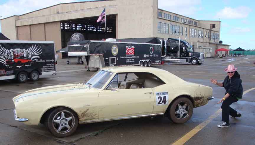

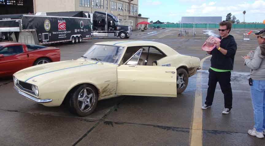

Originally Posted by LM7_67 View Post
Time for updates!
After I covered my car with mud Saturday morning spinning out on the road coarse, I hosed it off and I thought I got most of the mud off. But I was wrong. This stayed with me all through the rest of Saturday, all of Sunday, and a 400 mile drive home.
I was there that Saturday. At least you can say the track was cold and wet from the crisp morning condensation. The folks who spun out later that day didn't have that option...
