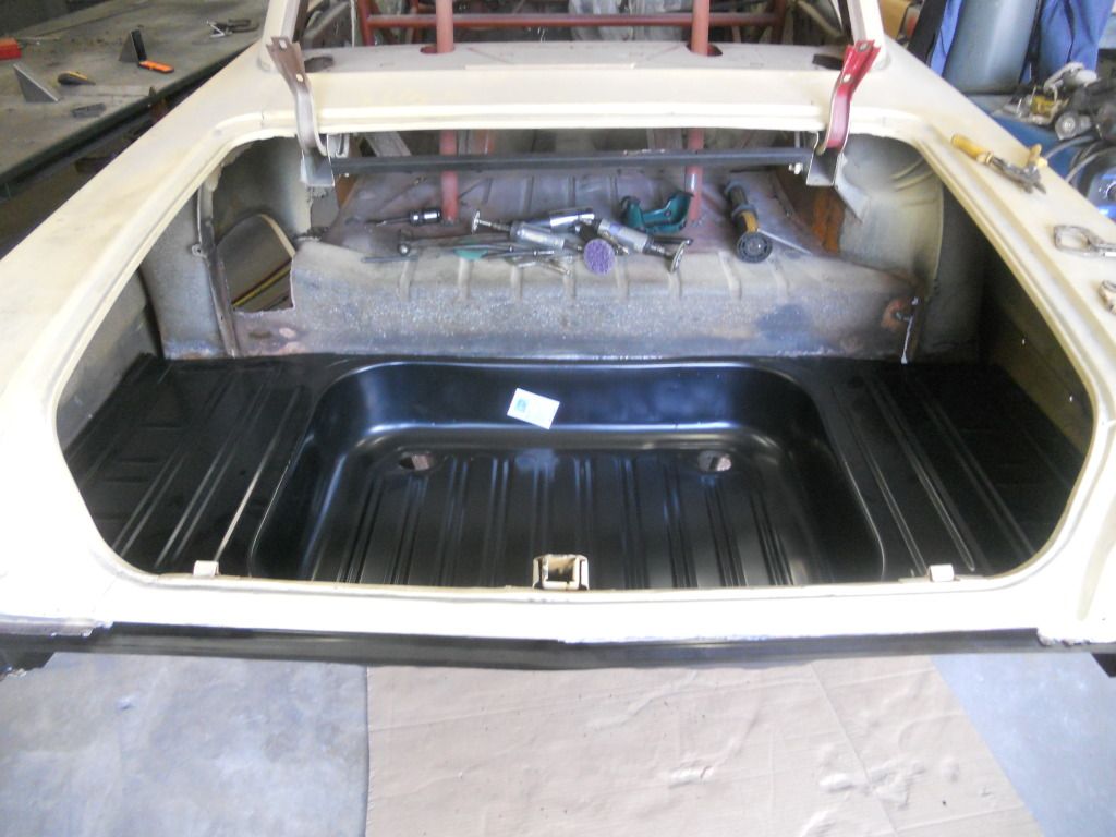

no more junkus in my trunkus! hope it goes well.

first fit. fits alright.

on the frame....off the frame....does it ever end? well, all said, it fits pretty well. floor pans, tubs and then finish the bottom.

do your self a favor don't weld the trunk pan in yet. until you finish the tubs.they are alot easier to do when you are not laying on your belly!
you can just stand up and do them with the trunk floor removed. Just trying to make your job easier.
