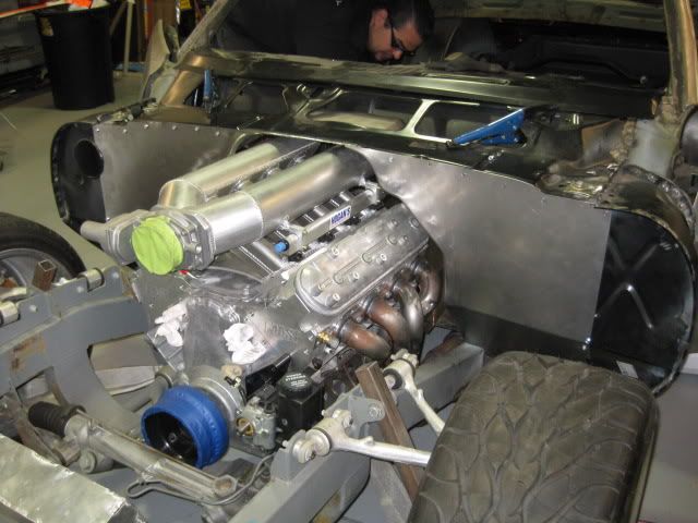

Jesus man that thing is sick. That intake looks kinda alien like.
What are the power #s on the LS3?

Thanks everyone! its a team effort here and Brian, my lead fabrictator has been extra busy!
Originally Posted by John510 View Post
whats the lead time on that manifold?
The manifold took about 6 weeks if I remember right
The engine dynoed at 640 HP and 560 TRQ

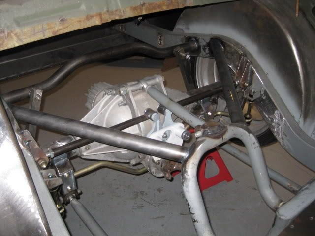

Shaved dripped rails. A pillars were also widened to cover weatherstrip channel.
Rear suspension needed all brackets removed and rewelded to housing due to previous shops work (all brackets misaligned and crooked). A new shock crossmember was fabbed, TSM watts linkage, and modified sway bar brackets

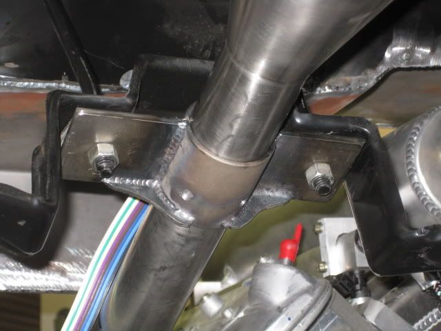

3" exhaust system run to rear crossmember
heat shields fabbed will be attached between floor and exhaust

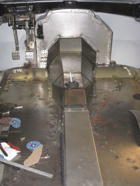

partial floor and tunnel fab. tunnel will be removable.

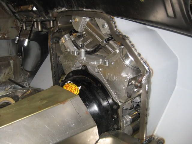

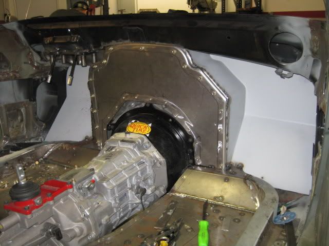

The owner of the car is very tall, but by removing the whole center of frame section and dropping down, we were able to get a very ergonomic seating position and steering/pedal placement especially considering the full frame and engine setback.
