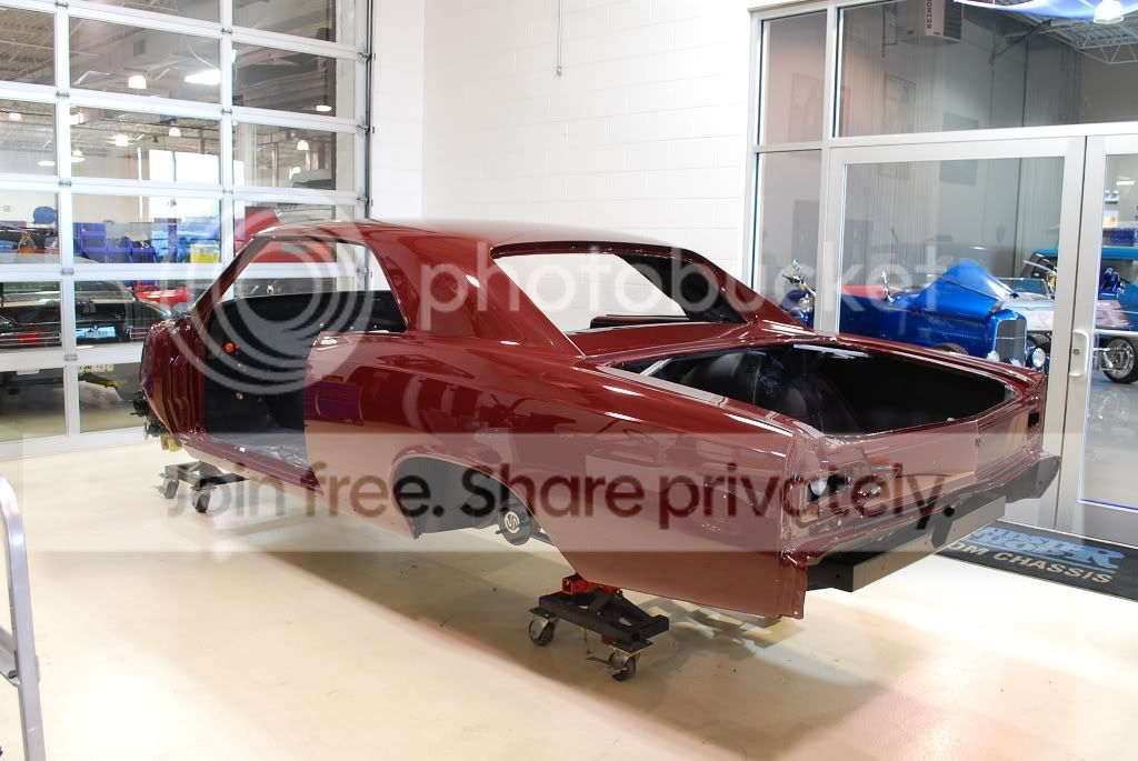

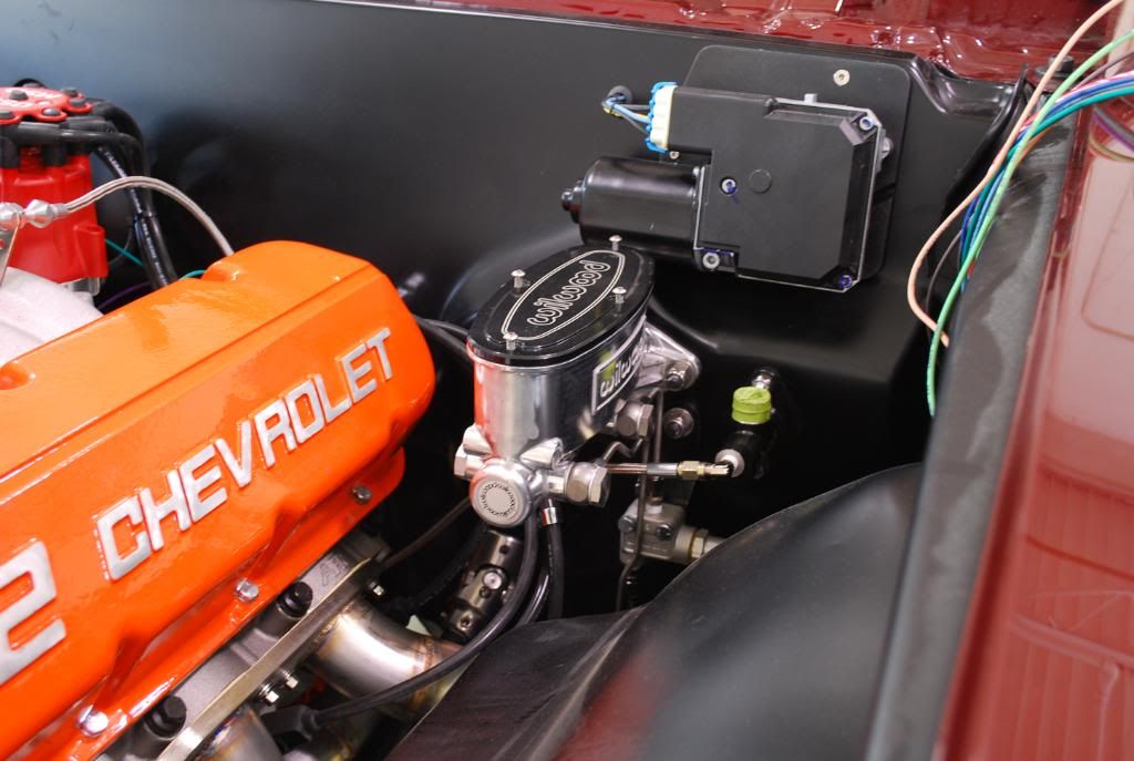

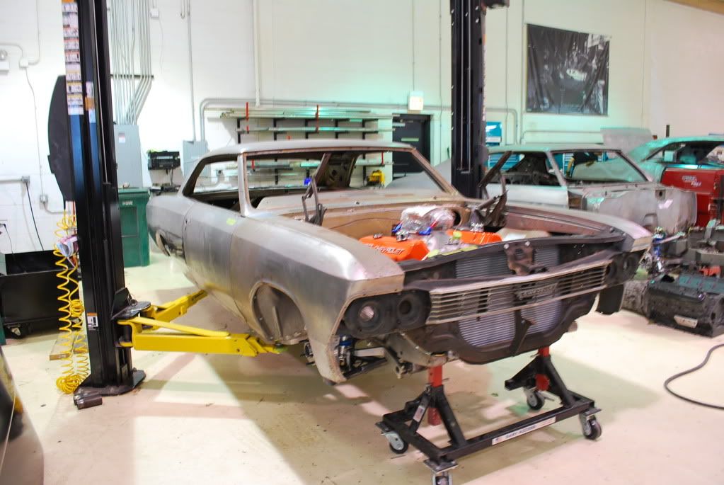

Default Making progress

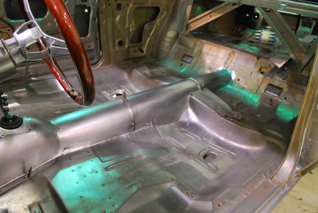

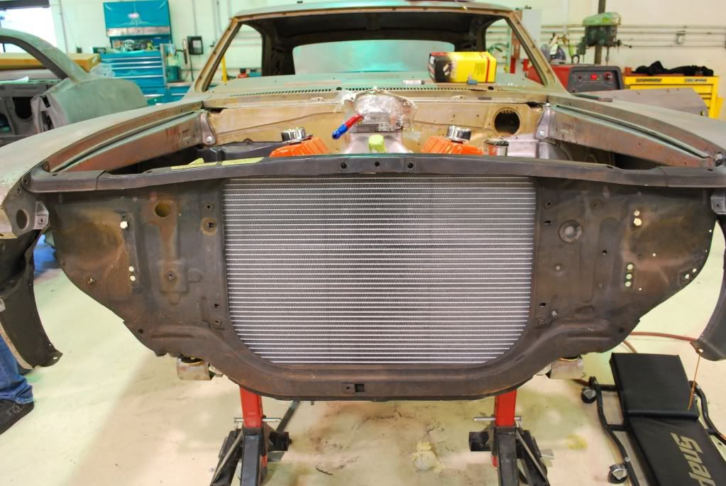

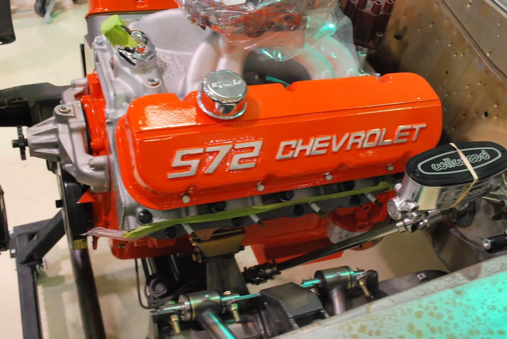

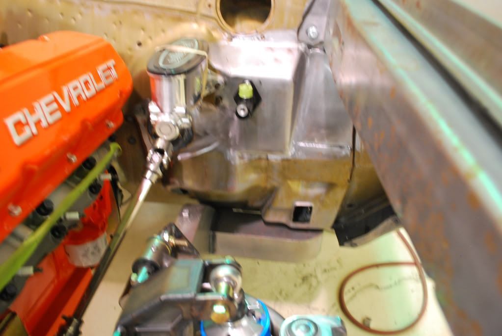

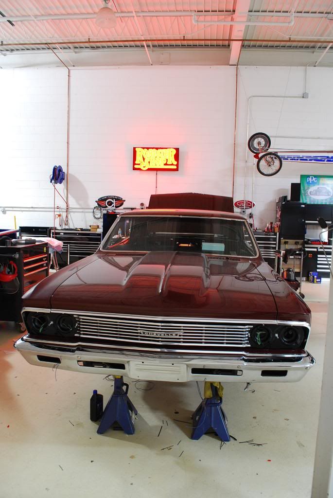

Completed work:
Steering Installed
Brake and clutch master cylinders installed and firewall smoothed around them
Trans tunnel completed
Fabricated new raised drive shaft tunnel and installed
Installed brake/clutch pedal and gas pedal
Radiator mounted to core support
Fenders and core support mounted to chassis
[IMG][/IMG]

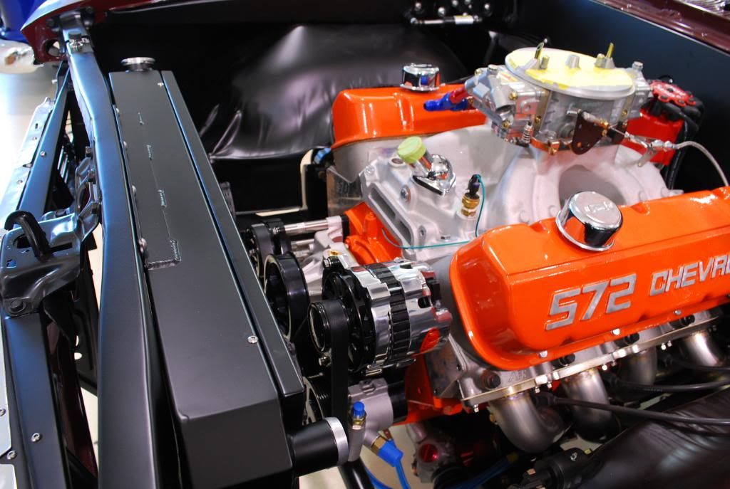

BBC71Nova BBC71Nova is offline
Join Date: Jun 2007
Location: Birmingham, AL
Posts: 849
Thanked 4 Times in 4 Posts
Nice. What radiator is that?

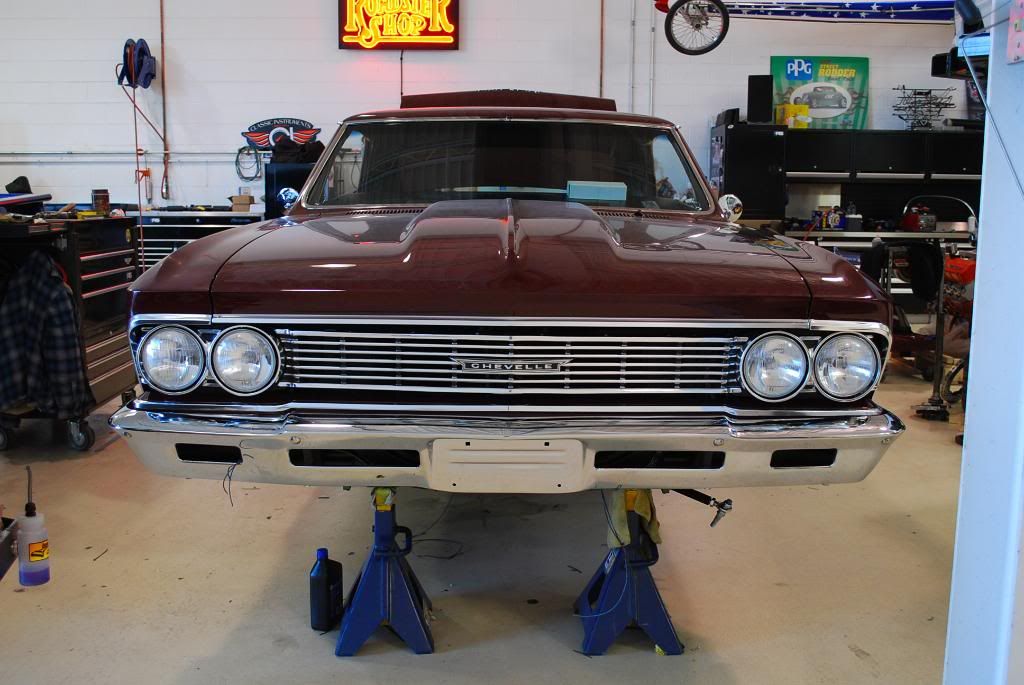

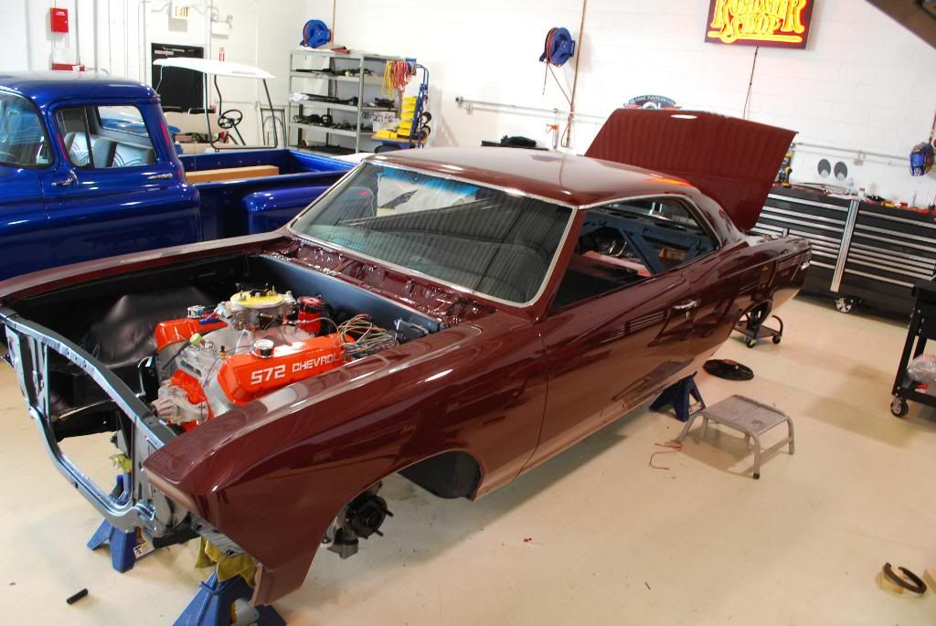

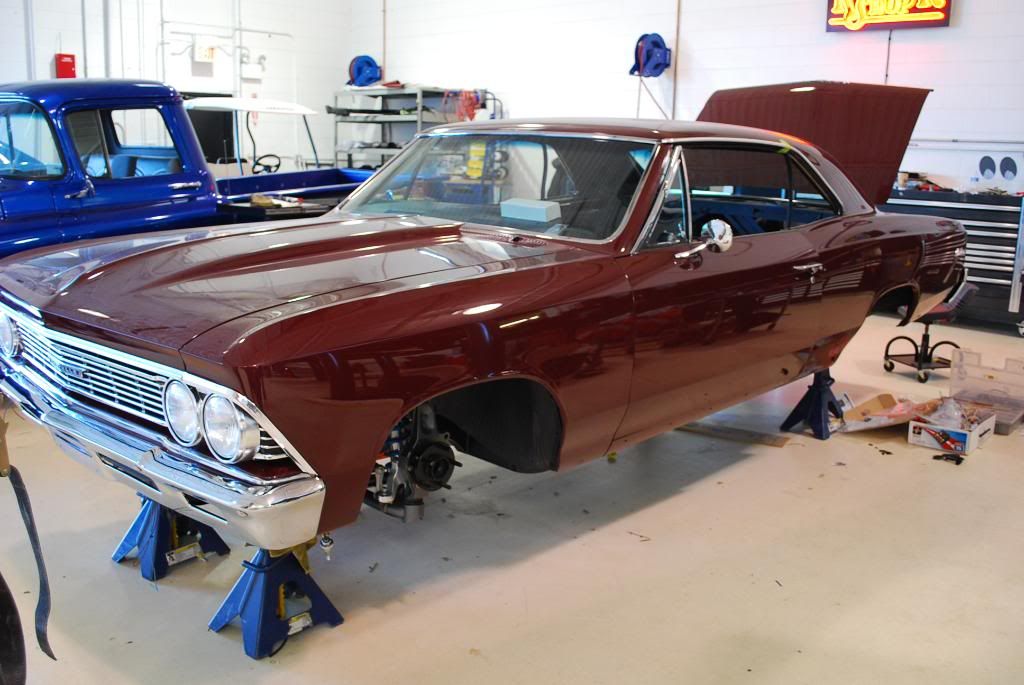

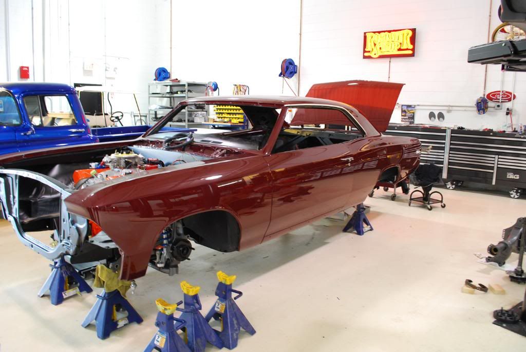

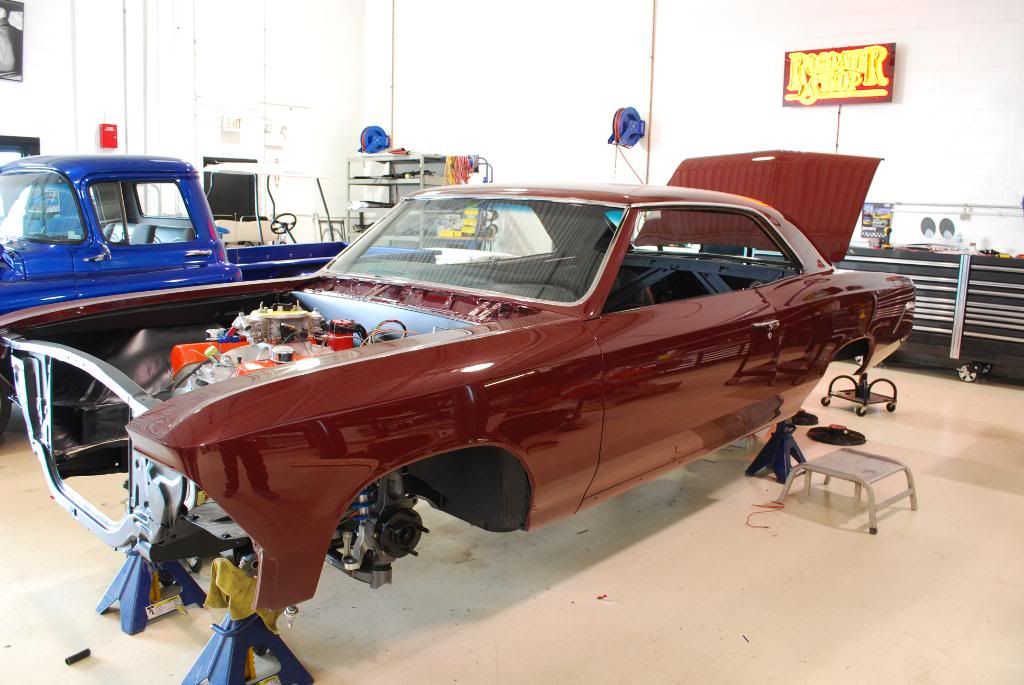

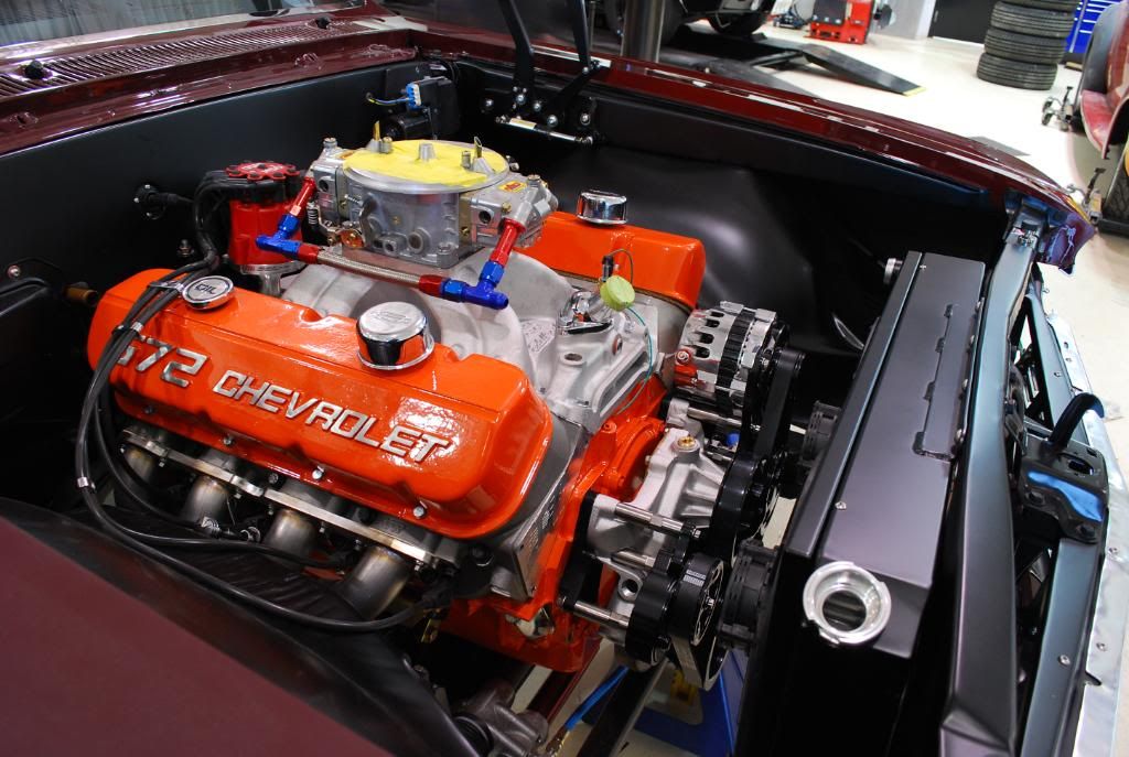

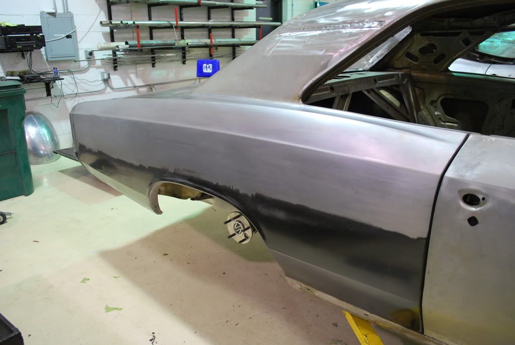

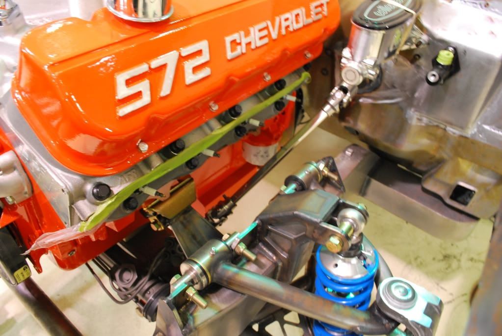

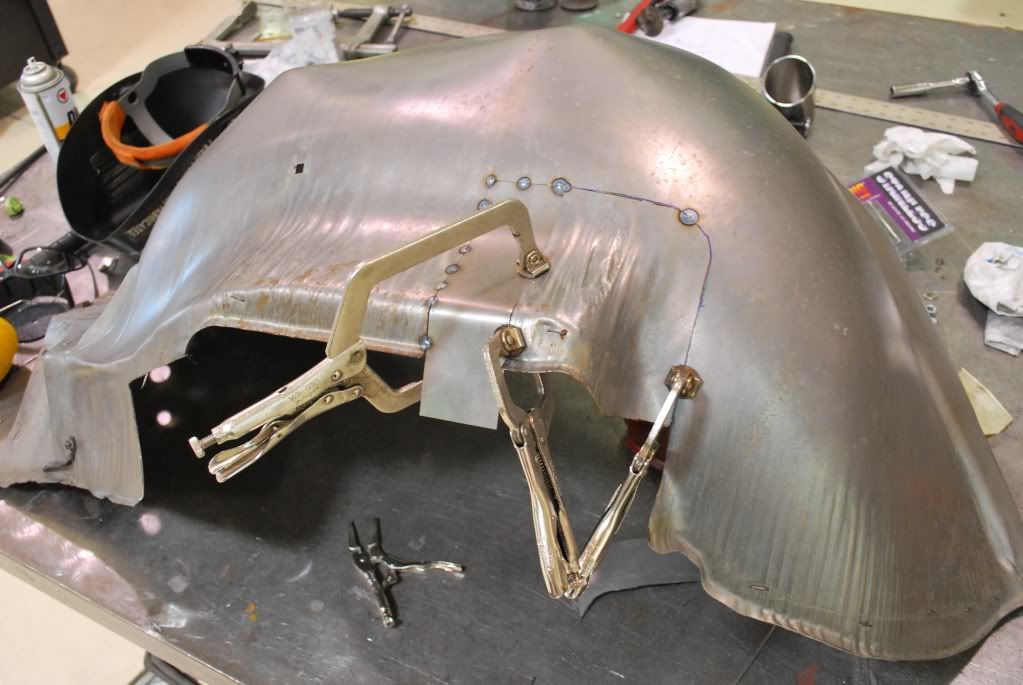

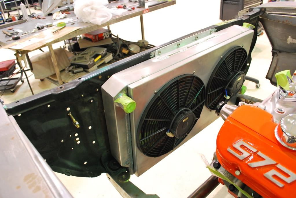

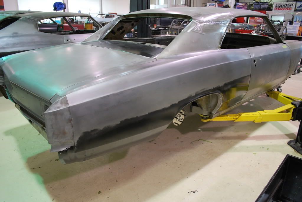

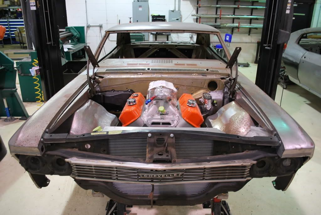

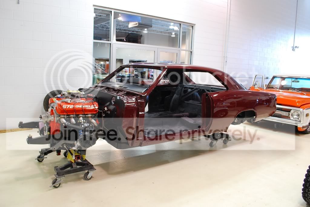

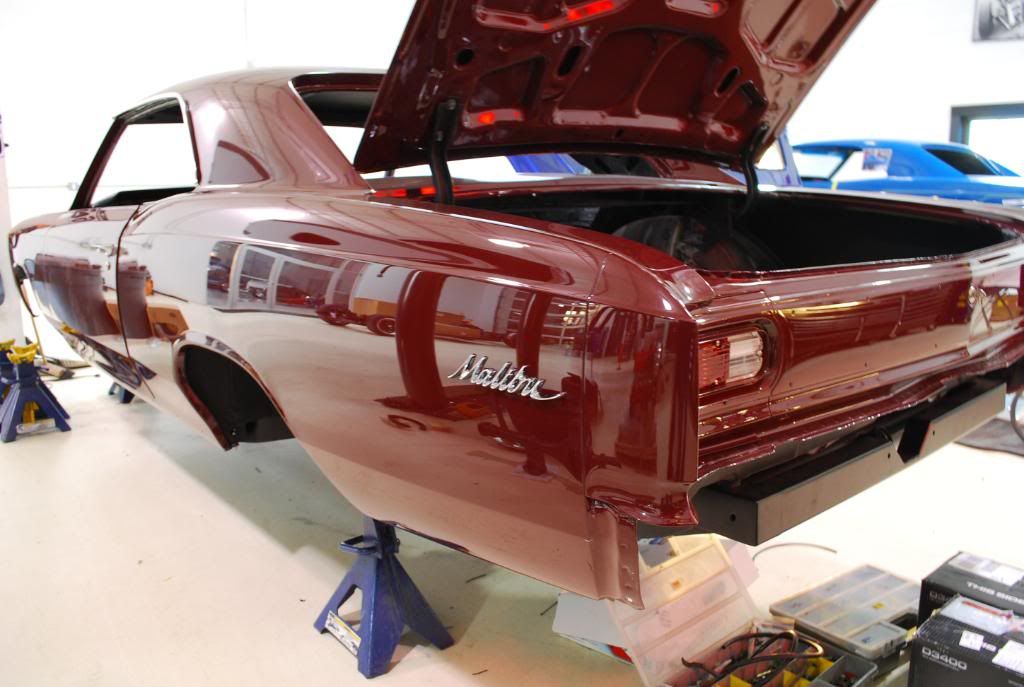

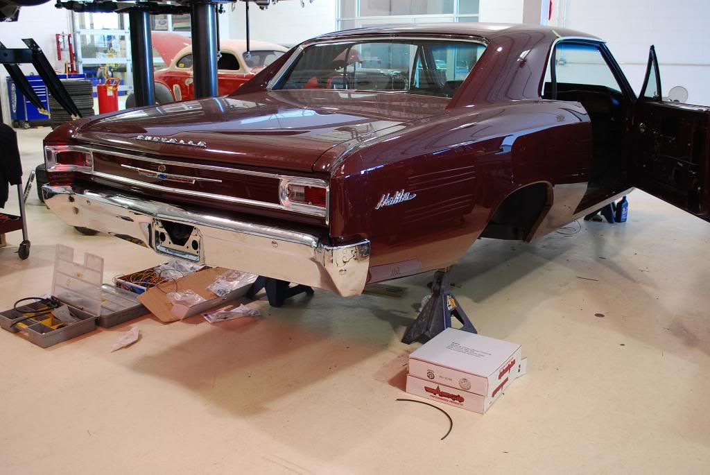

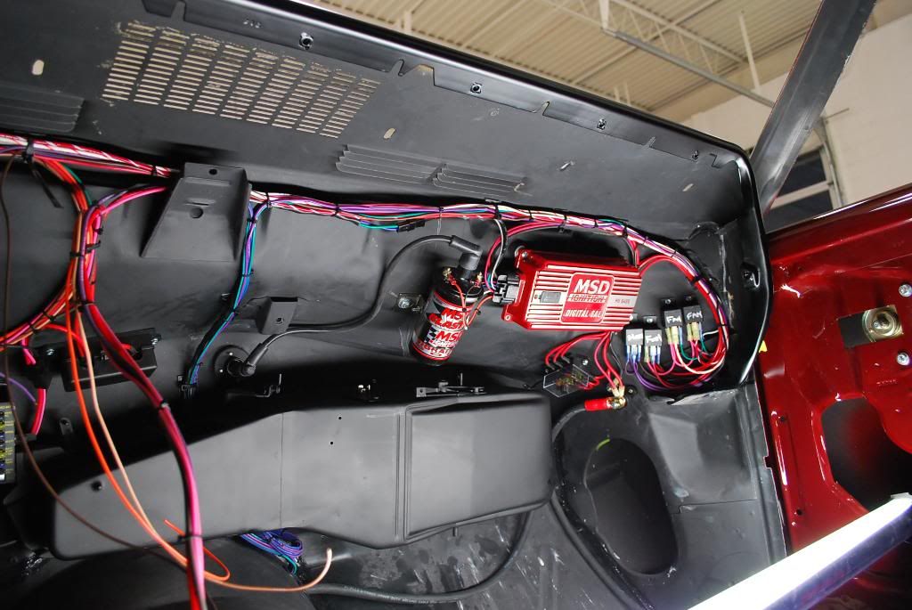

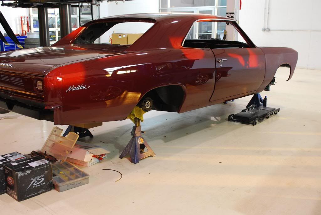

Here are a couple of more shots.
[IMG][/IMG]
It is an Autorad Radiator
www.roadstershop.com

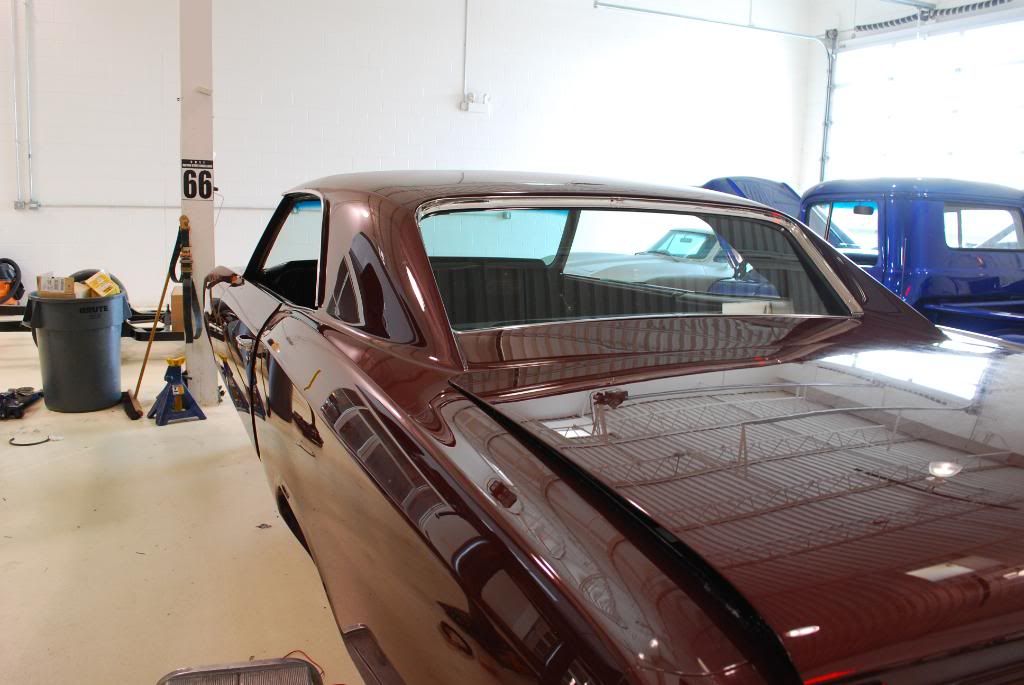

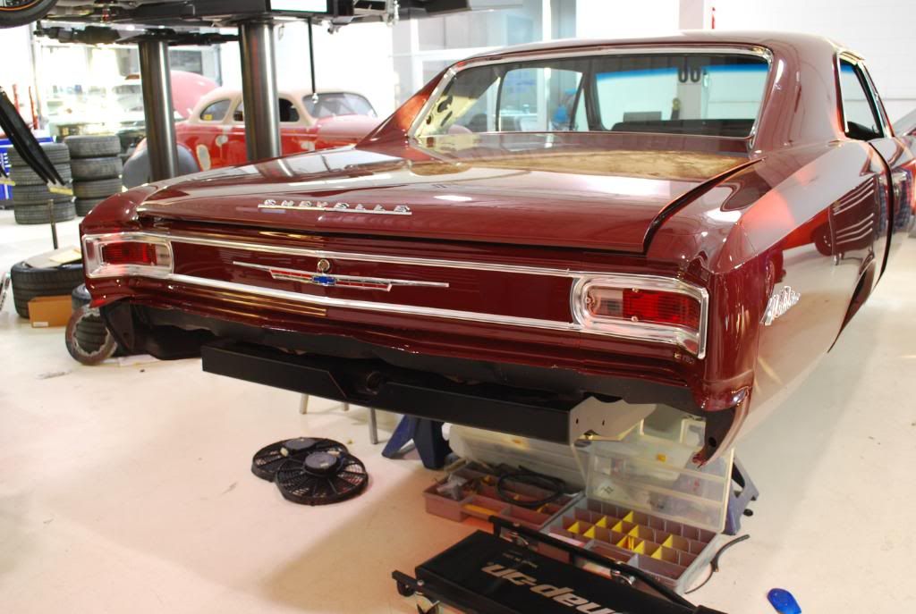

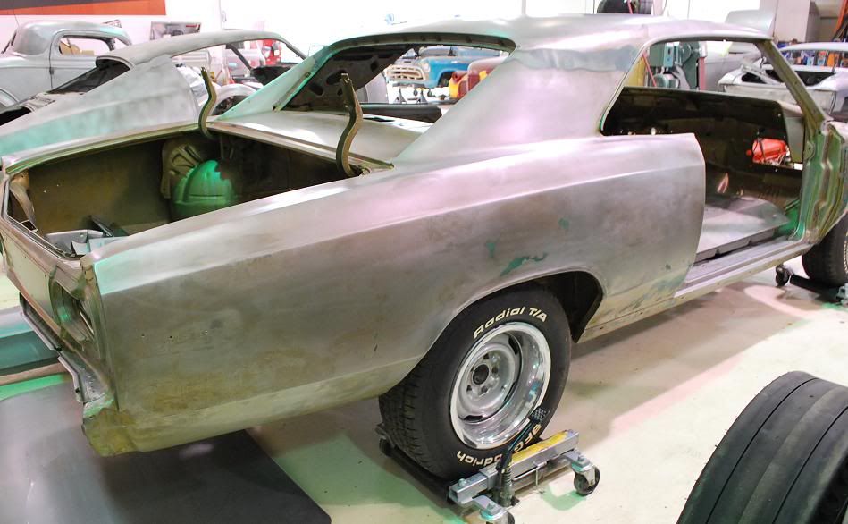

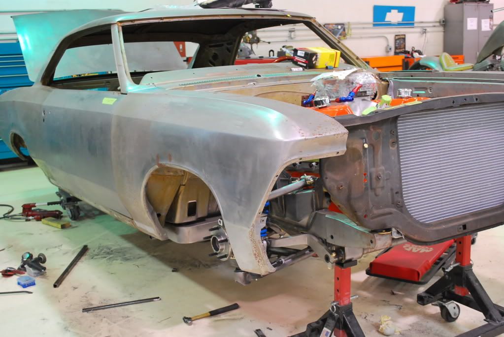

[IMG][/IMG]
What do people use to get the uniformed smooth look when sanding to the bare metal?
  #40
Old 08-03-2011, 08:10 AM
Roadster Shop's Avatar
Supporting Vendor
RoadsterShop.com
Join Date: Sep 2007
Posts: 1,120
It takes some skill on both the welding and metal finishing side. The quick answer is that you have to be able to weld the panels with minimal warping or distortion. Then knock the welds down with a grinder with out getting into the metal around it. We then do a lot of hammer and dolly work to make sure that all surfaces are even and uniform before final grinding. We step down the grit getting finer and finer and then finish it with a DA and then a red scuff pad by hand.
