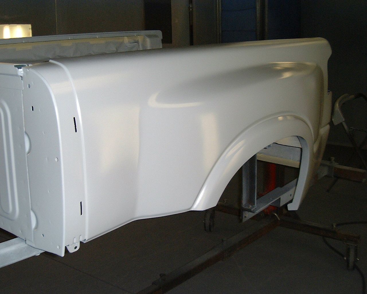

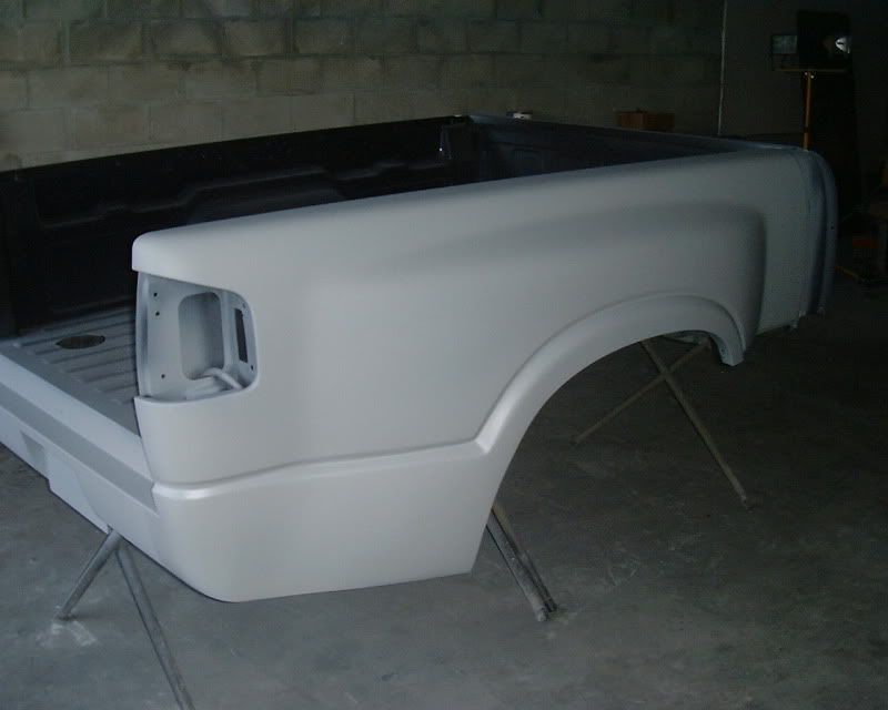

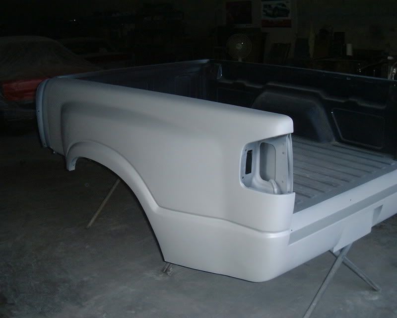

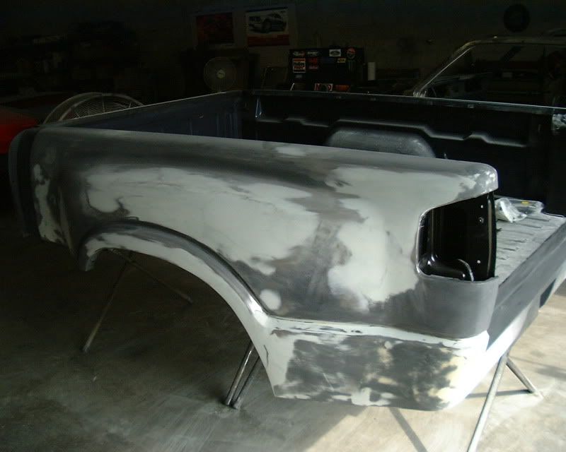

I blocked out the sides of the bed and ready for primer

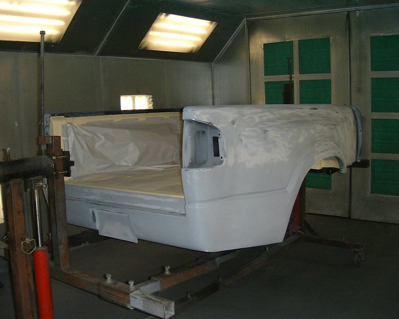

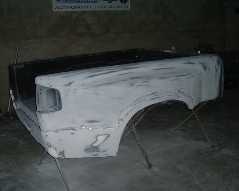

I sprayed 2 coats of Slick Sand polyester primer now will block sand again to get the shape I want.

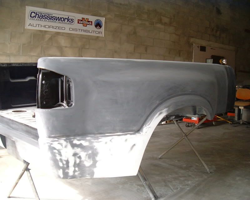

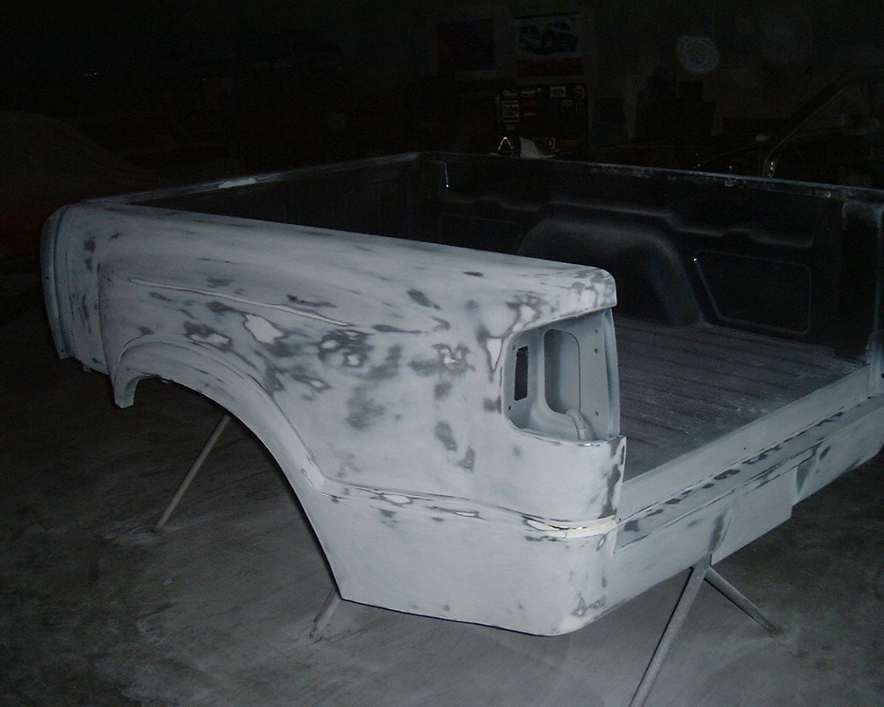

Block sanded the bed and is ready for more primer

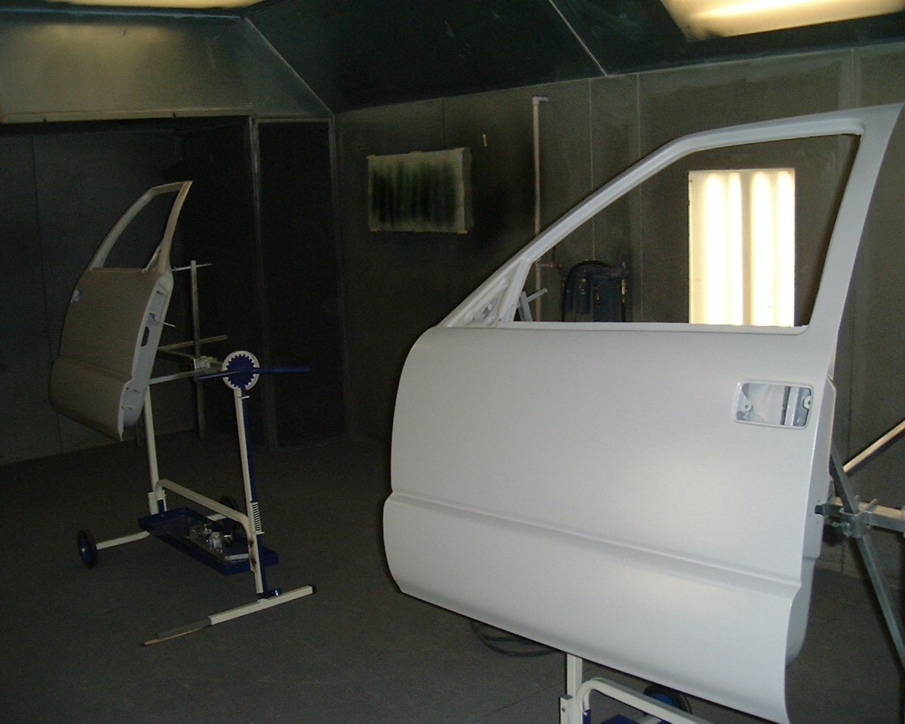

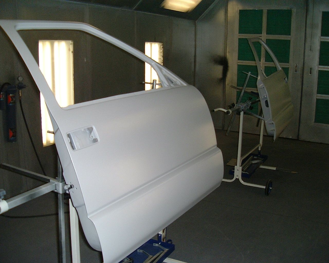

I epoxy primed the doors for the last time yesterday. Today wet sanding with 800 than spraying the base.

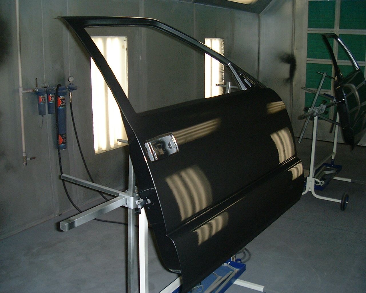

I finished spraying the clear on the doors yesterday.

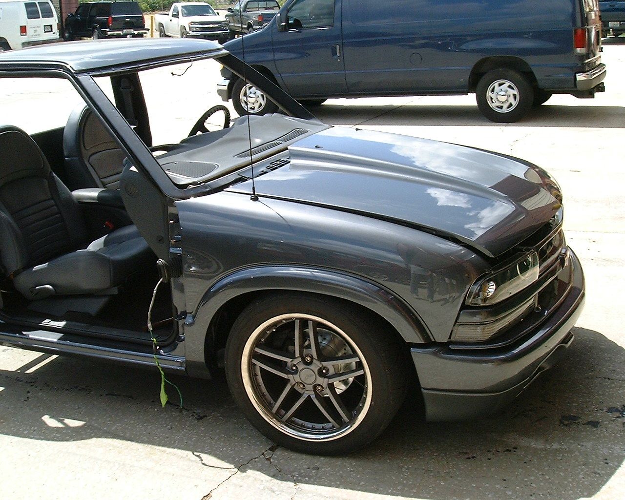

Jared's goal is to have it in tip-top shape for the LS Fest at Bowling Green in Sept.

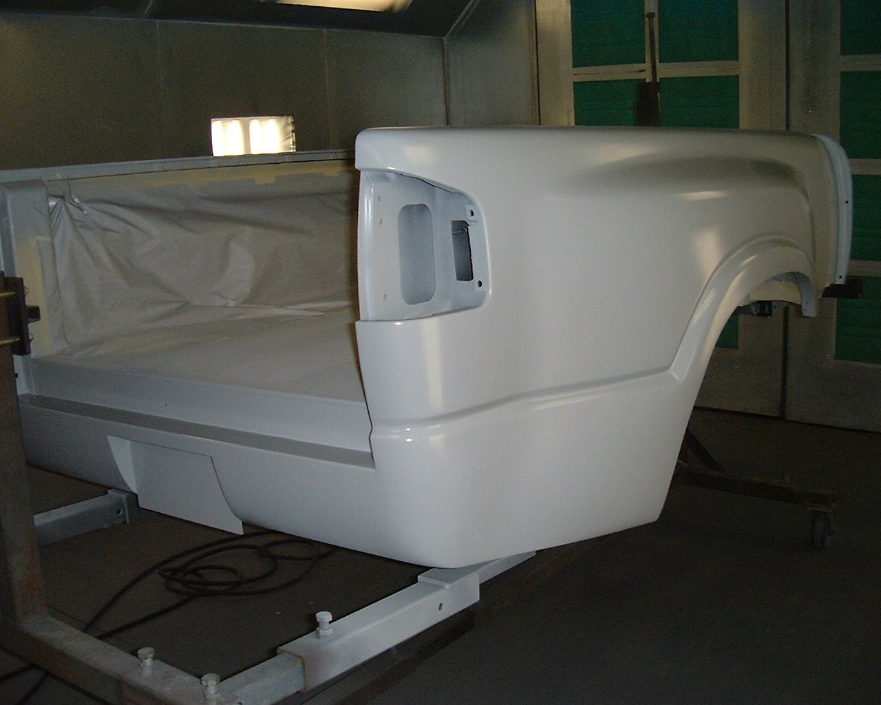

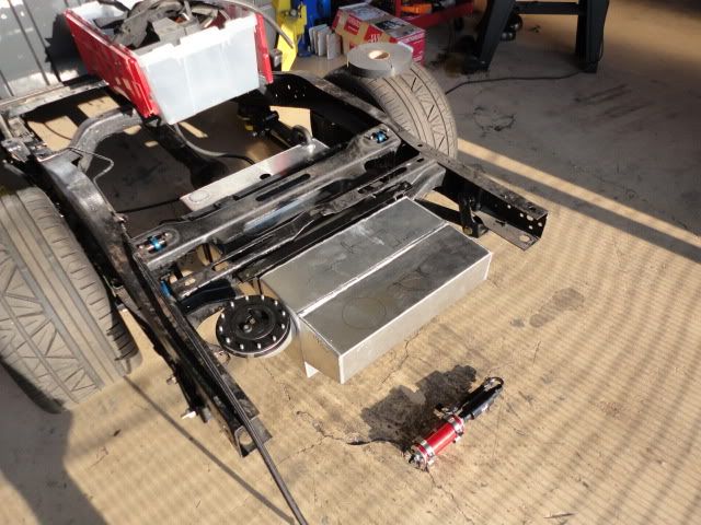

These will be the last photos until after Bowling Green

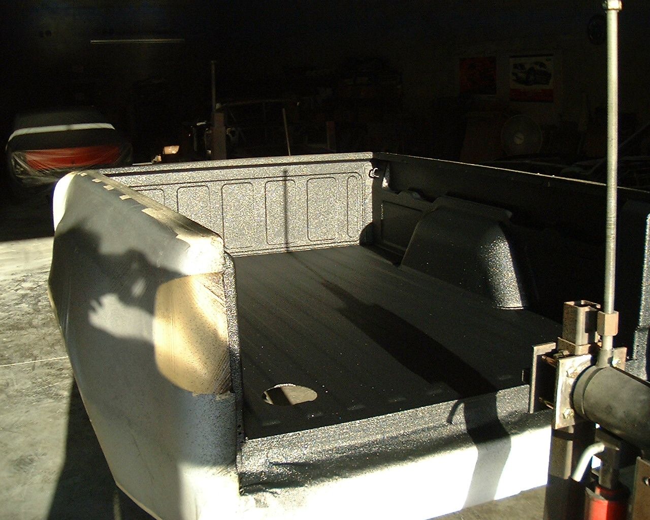

We sprayed SPI bedliner under and in the bed
Getting ready for the last coat of epoxy primer
I finished the primer tomorrow will scuff with 800 than spray the base
