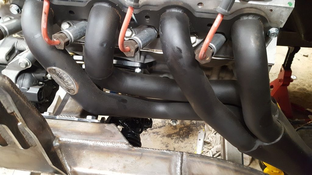

Been working on the header modification.
There was no room to go above. Not excited about the overall length and additional bends but for now its fine. I need to pinch some pennies and not buying $1500 headers is a good thing. i'll have my buddy tig them up but should have around $550 in them once done.

woah are the speed tech headers now $1500?
I will follow in your steps if that is the case. any luck with the dirty dingo bracket?
Speedtech lists them on their site for around $1400 + shipping. i think summit has them for $1200.
They are beautiful but not in the budget right now.
I haven't mocked up the dirty dingo A/C yet. It looks like it will but will verify hopefully Friday.

Thanks! I did verify I have the right mounts. The header fitment is on me. I decided to use a "non" verified header combination with this frame. I wanted a 1 7/8" primary tube but didn't want to shell out the money for the full length ones speed tech offers. These are the hooker 2474HKR i purchased from Amazon for under $400 (I also had a $100 gift card) so i took the gamble on these. I knew the driver side was a long shot but it looks like it will work out.
I'm hoping to have the A/C verified today. I want to finish the fabrication stuff and get the floor and firewall finished.
