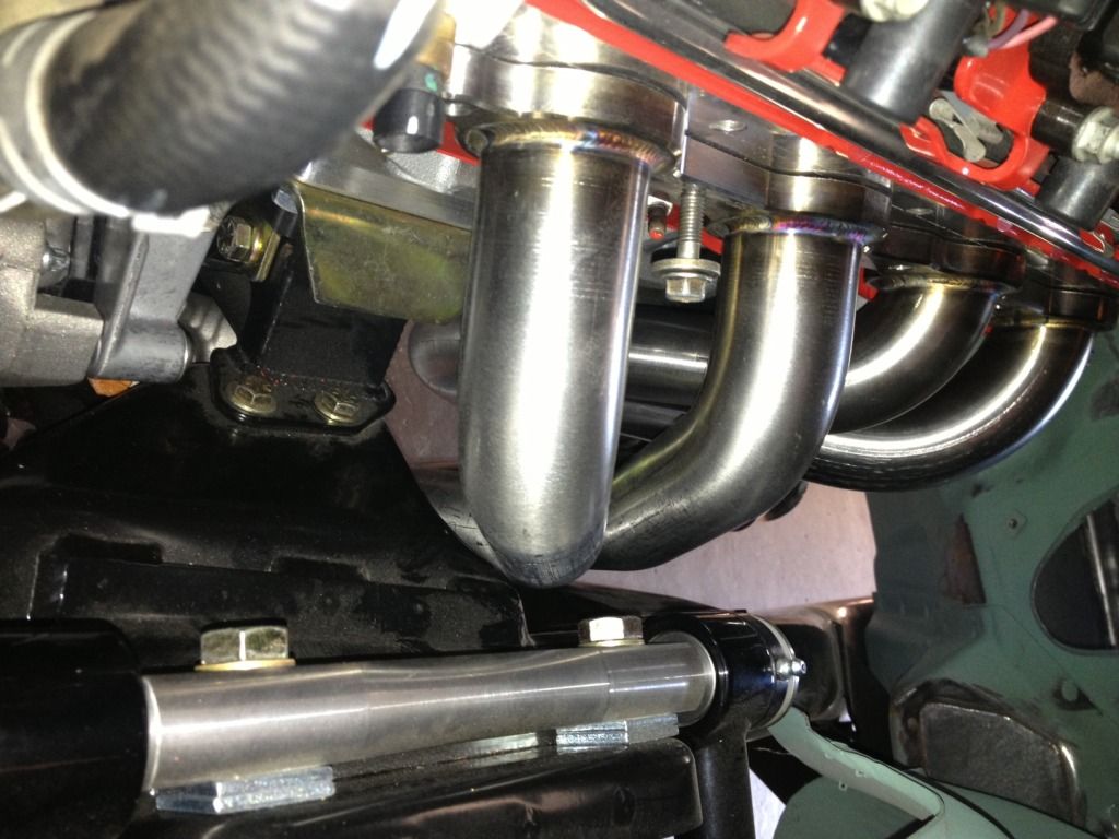

ordered these about 2 1/2 months ago , finally got them yesterday and they are a piece of art but driver side does not fit it hits the shock tower on dse sub, I've double checked pinion angle , engine center to sub,etc. running all DSE complete sub w engine mounts
so as you can see in the pick, just mocked to check fitment , no gasket but it hits sub and does not allow to sit flush to heads its off by quite a bit. any one had this experience or any ideas on the cause besides defect.

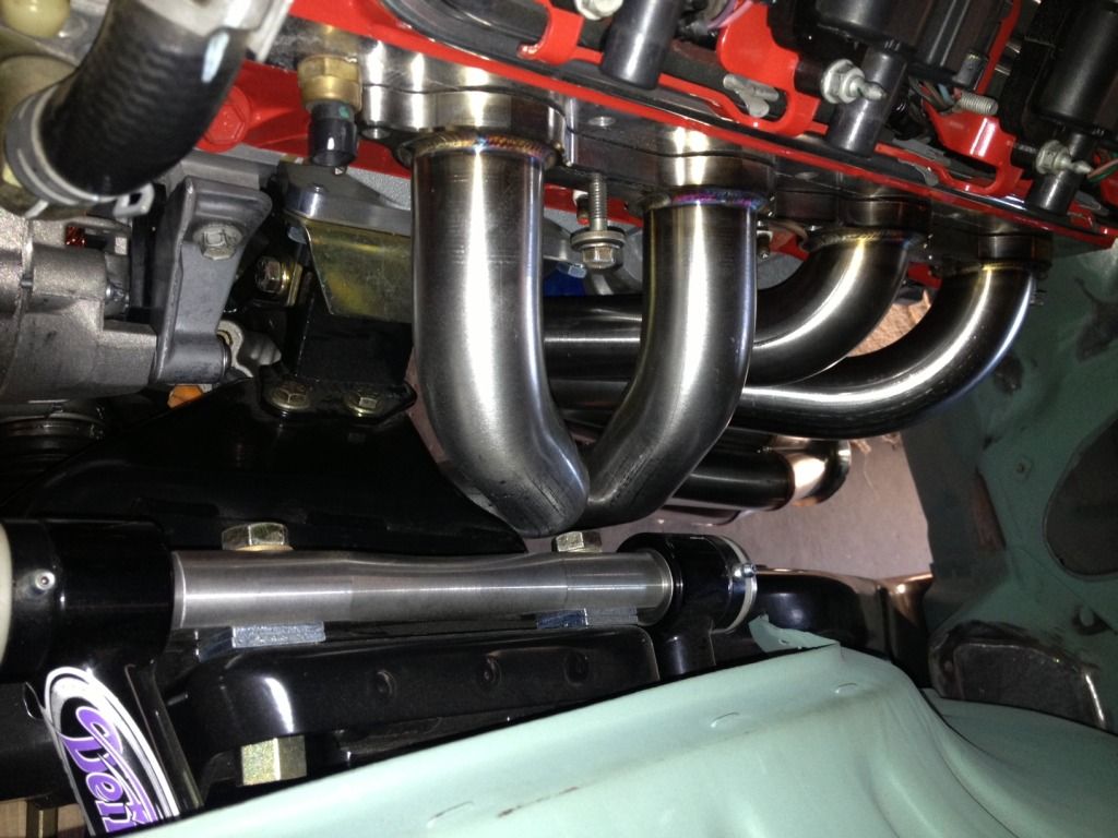

another angle

Originally Posted by frankv11 View Post
another angle
Do you have the 060404 mount kit? It sets the motor back and required with their headers.
I got 060401 mounts , when I ordered sub assembly and LS mounts they never mentioned that I would need 060404 if I wanted to use they're headers, was not aware of two different Ls motor mount options for they're sub.
