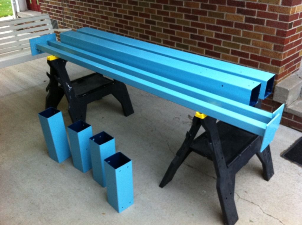

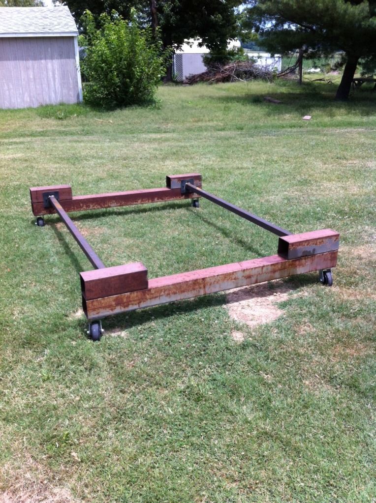

Speaking of car dollies. How about this one? This is what I was doing instead of working on the actual car. This pic is after it was test fit together to make sure it all worked. In short...17 feet of 5X5 square tubing and 88 holes drilled. You have a bolt together deal.
Sandblasted then painted
Partial assembly
Sliding it under the car
Under the car and bolted to the frame
I had to upgrade the casters. 8" cast ones to make rolling easier.
This makes a huge difference. It puts the frame 24" off the ground, allows you to remove the wheels for welding and body work, work under the car, etc.

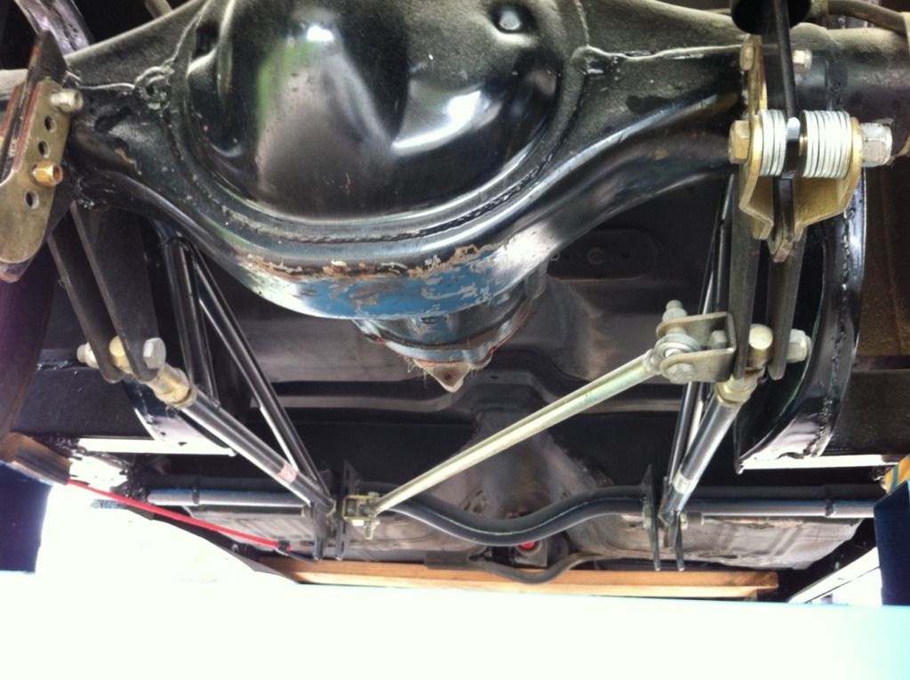

Some cool pics of the trunk pan and under the car.
