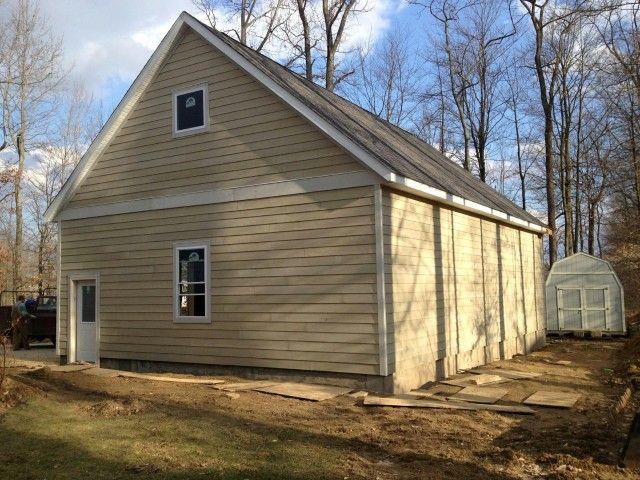

Old 02-28-2013, 07:22 PM
wiedemab's Avatar
wiedemab wiedemab is offline
Join Date: Oct 2005
Location: Batesville, IN
Posts: 1,475
Thanked 7 Times in 3 Posts
Default Few pics of the garage - so far
Still a few things to wrap up.
-paint the exterior (when weather gets nicer)
-garage doors
-finalize electric service upgrade
I'll wire it, insulate, install the heat (radiant tube).
I've picked up quite a few goodies and tools, but I'll save those pics for later.
Stairs......
I'm going to finish out the upstairs too -- well finished out enough, not Greg Weld nice or anything!
Brandon Wiedeman
'72 Suburban
'67 Chevy II -
