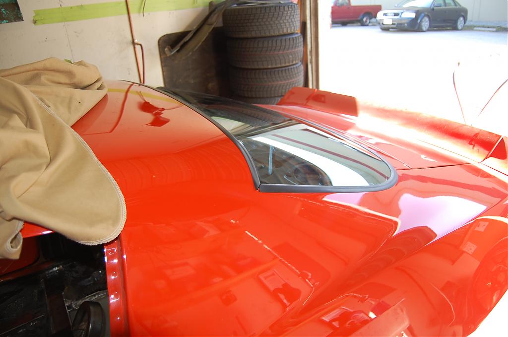

now your talking. Looks good. Just the right height to be called crazy.
I like the rear glass but stock looks bad ass flush mounted.
Haha...I see I was beaten to it.
Thanks Vince
Dan G. aka G4CERAT
