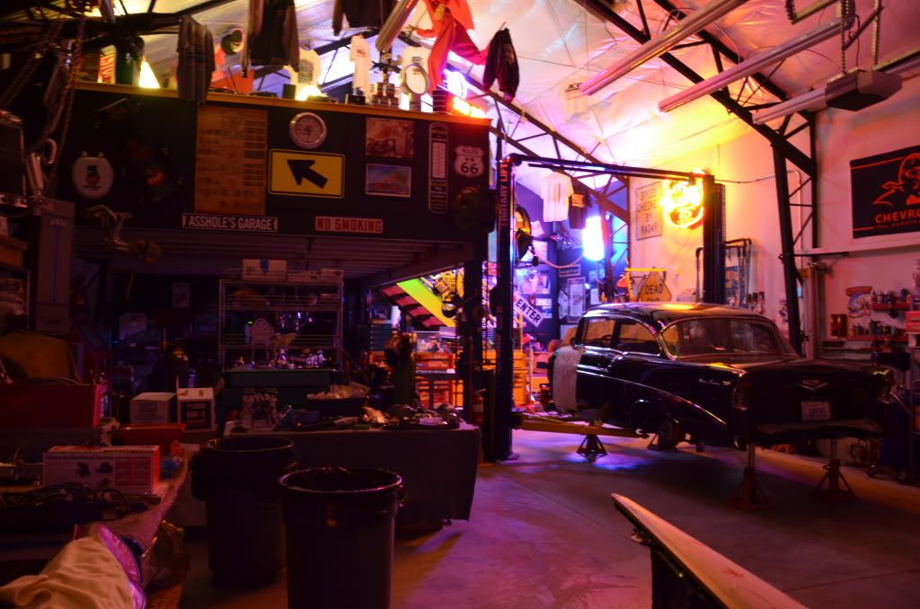

HELL NO!! Well.... maybe for you I would.
You know what happens when you work on a buddies car???
It then comes with a lifetime warranty. For ANYTHING and EVERYTHING that goes wrong with it from then on.
Sometimes guys show up here - and I just tell them I don't know anything about "whatever" their problem is -- because I don't want to work on their crap in the first place now -- or in the future.
You see that one sign in my garage pics??? It's true!!!!
