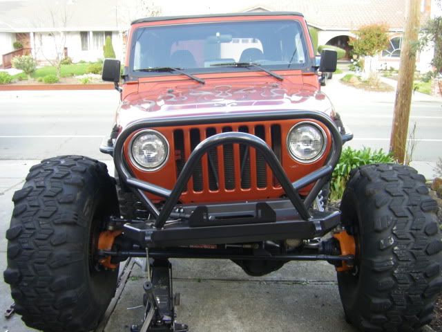

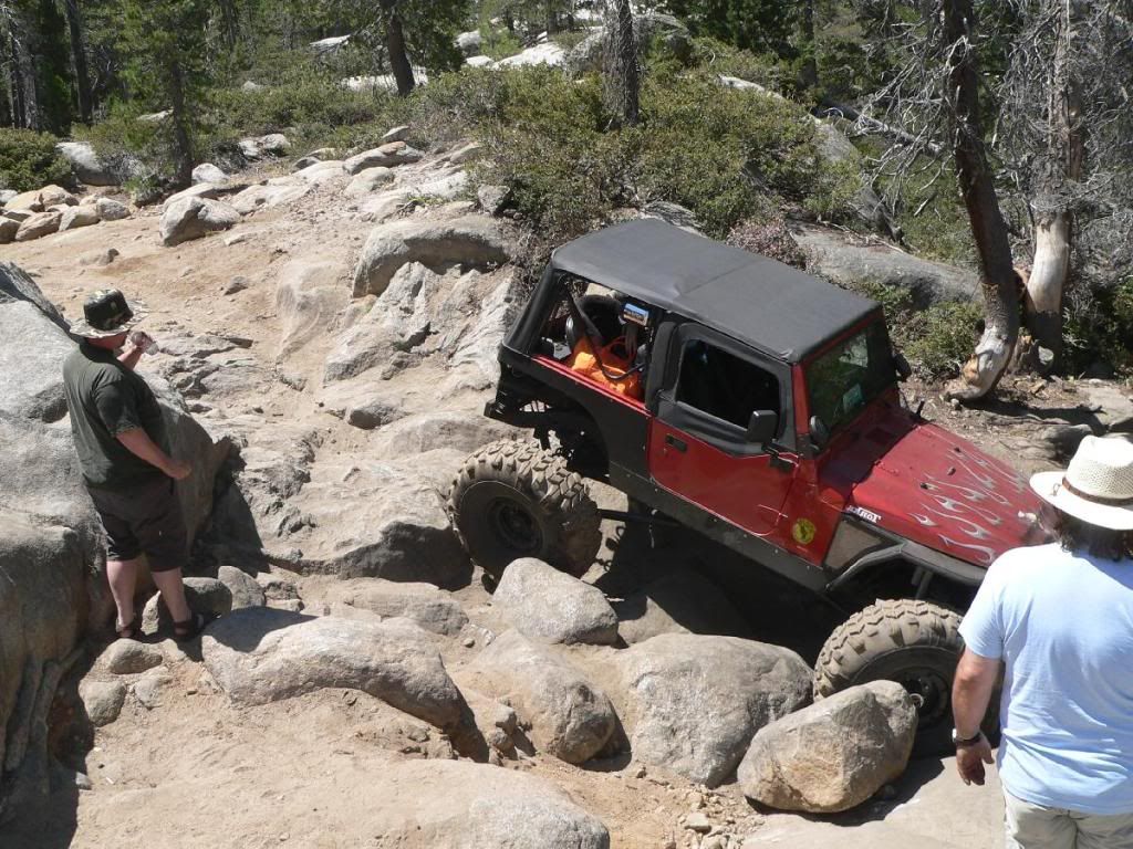

My old YTJ (YJ on tons, I put a TJ front clip):

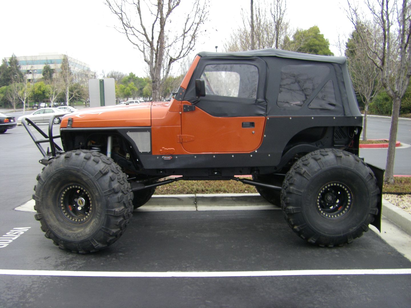

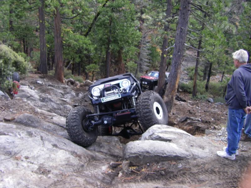

Cruiser buggy:

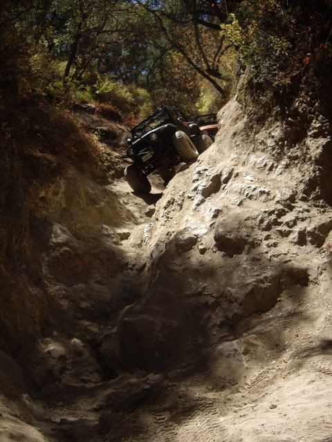

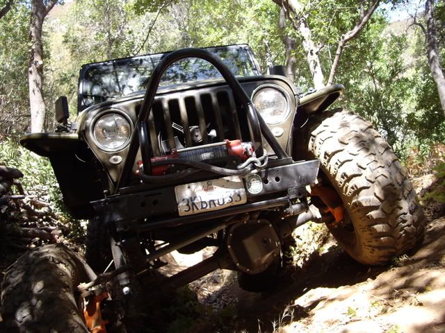

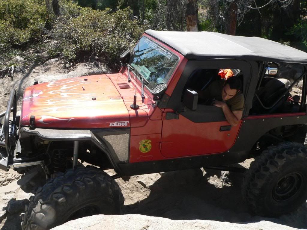

and PEPECA:
street legal...errrr
on the trail after lowering about a foot

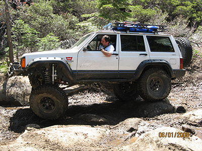

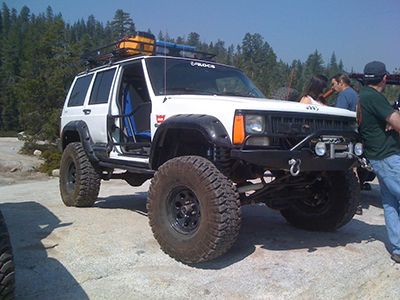

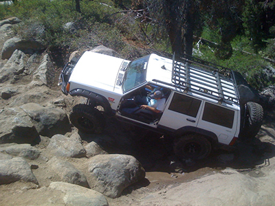

Several buddies form our jeep club have very capable XJ's like Jeff's below (old pics the rig is much more modified now), but puts several Warnaglers to shame
