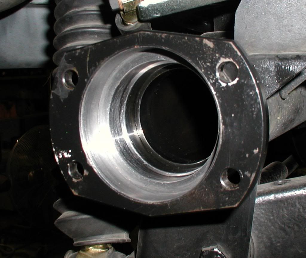

Pretty much ever since I have had this Quick Performance 9" rear axle, I have fought the passenger side axle seal (or the lack thereof) leaking rear end gear oil. QP uses a Moser Billet Torino style (big Ford) axle end and Moser axles with sealed bearings pressed on them. Their thought is the sealed bearing will stop the gear oil from leaking...it doesn't.
I finally learned that there is a step down inside the end that a National part #473229 seal fits into so I picked a couple of them up last week. Here is what the axle end looks like.
and here is what it looks like with the seal pressed into place.
ID of the seal is 1.5" which matches the axle. Sure hope it works...
I cleaned a LOT of leaked gear oil up today. And I just LOVE the smell of gear oil.

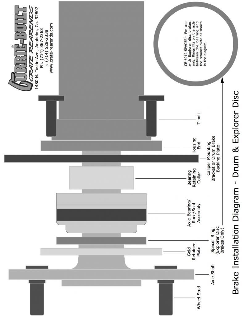

The Ford 9" I've always done had the seal installed "ahead/to the outside" of the bearing - so it was the last thing that went inside the housing and was held in by the retainer plate. I always had to put the retainer on the axle - then the seal - then the bearing and press the bearing on... then put the race in the housing and then slide that whole works home...
This is the best picture I have of the setup that holds this axle in place.
Basically the brake baking plate is set in place on the T studs, inside the housing is the axle seal, then the bearing, then a little 1/8" spacer, then the retaining place it placed over the T bolts and you put nuts on it through the hole in the end of the axle hub.
Moser themselves is who gave me the seal part number. Apparently they use it all of the time with their ends, bearing and axles.
Not sure why QP refuses to even admit the seals are needed. EVERYONE I know with a QP 9" fights this issue.
Lance
