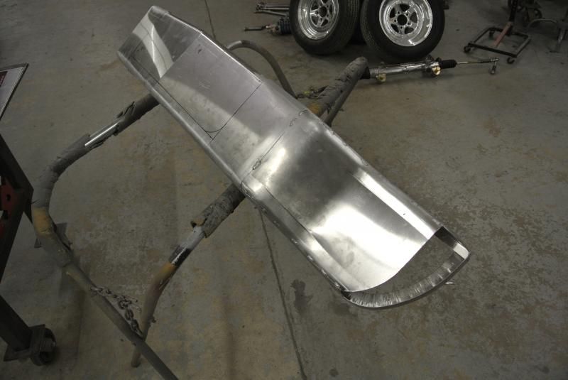

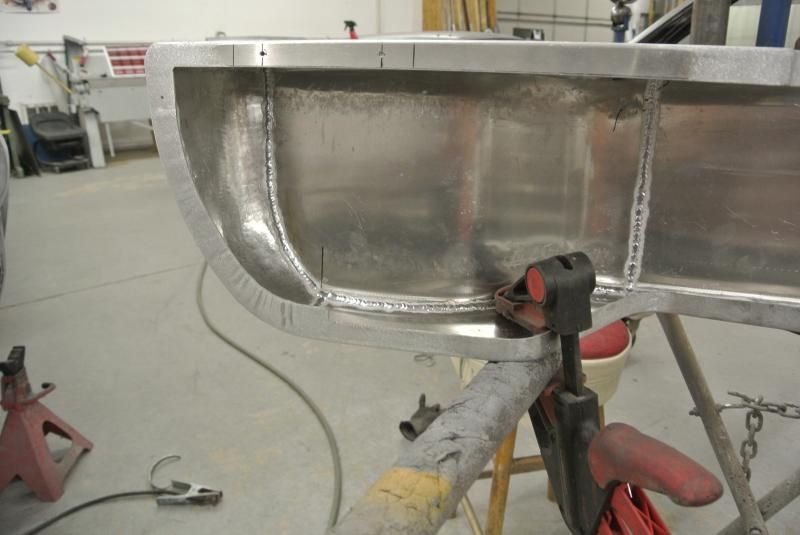

Troy --- Tell me what the numbers represent...
Greg- we clamp the flat face of the wheel well in the car and measure over...this gives us a ruff reference when trimming the tub to fit once it is all tacked together. Speeds up the fitment process.

I was totally gonna make fun of Greg, then realized I didn't get it either!!
Greg: Great Question!
Troy: That's thinkin right there!

I'm too old to be embarrassed about "dumb" questions.... but I'm never too old to learn. LOL
Thanks Troy!!!

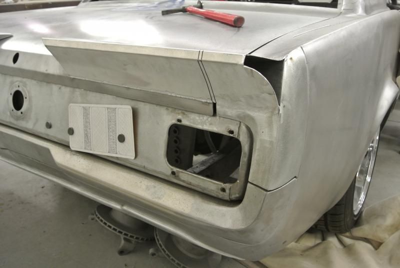

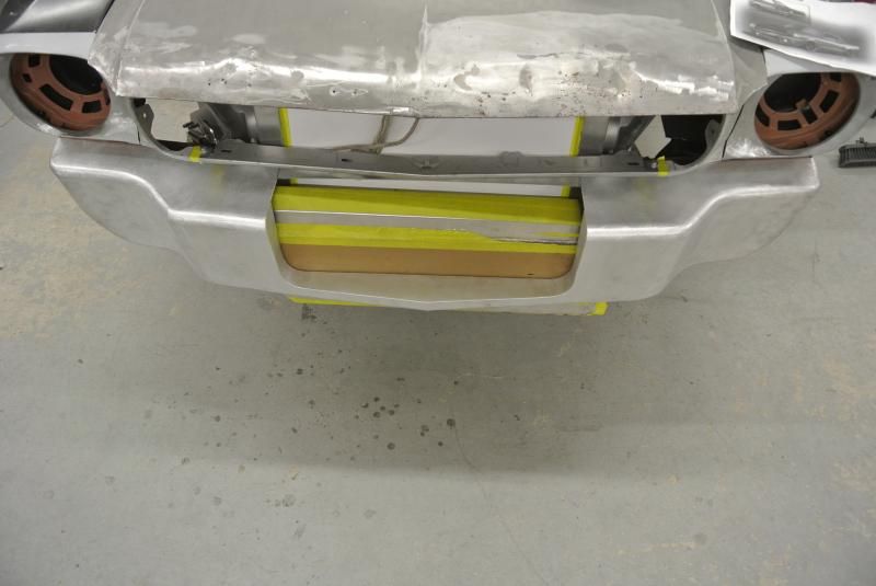

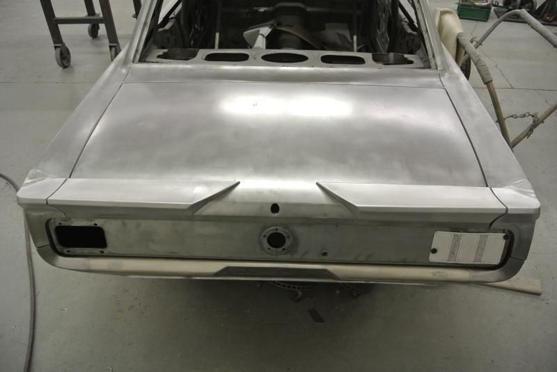

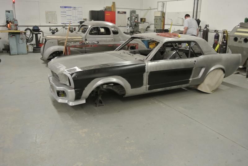

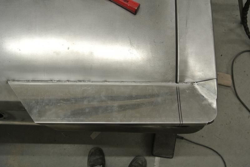

-troy

Sheet metal fabrication perfection ! I would like to see more ! Please ! Thanks for sharing !
