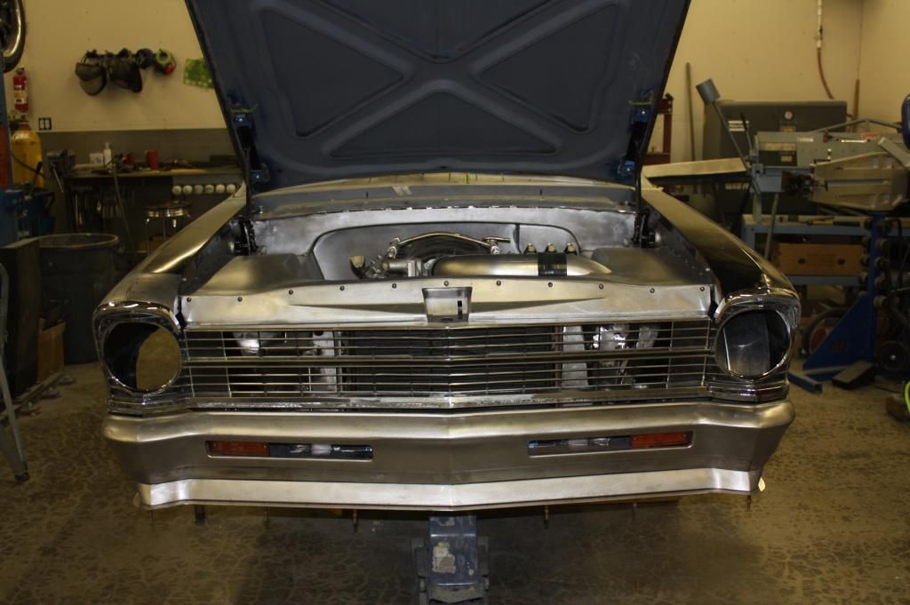

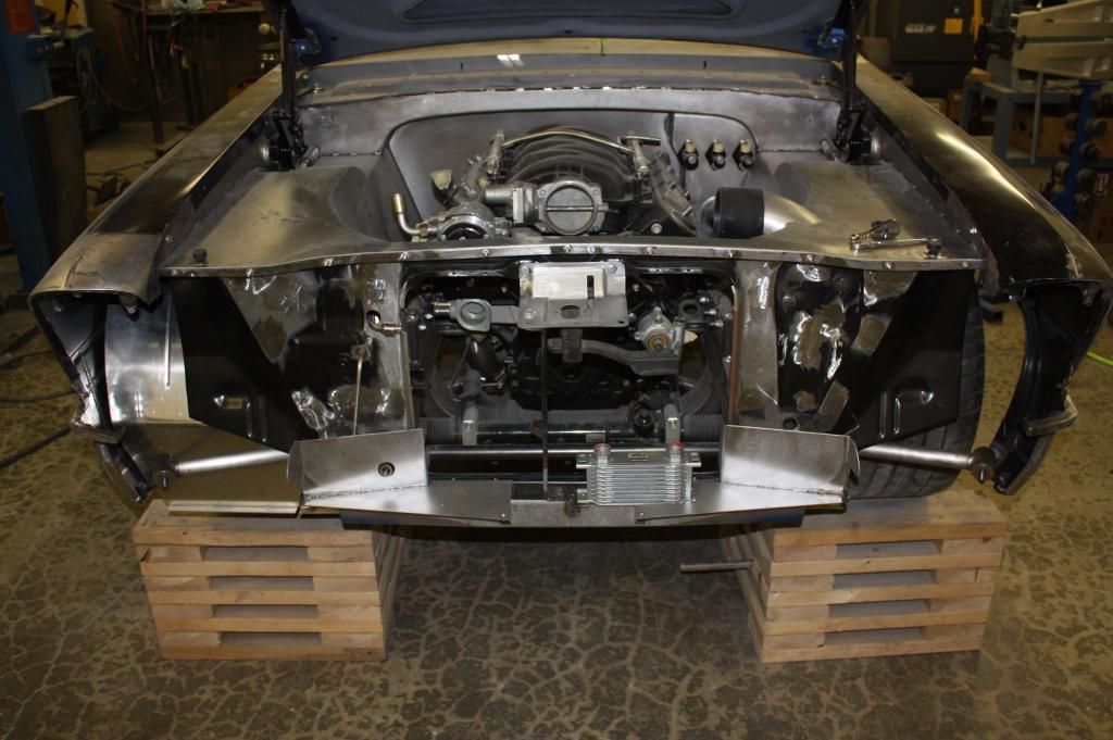

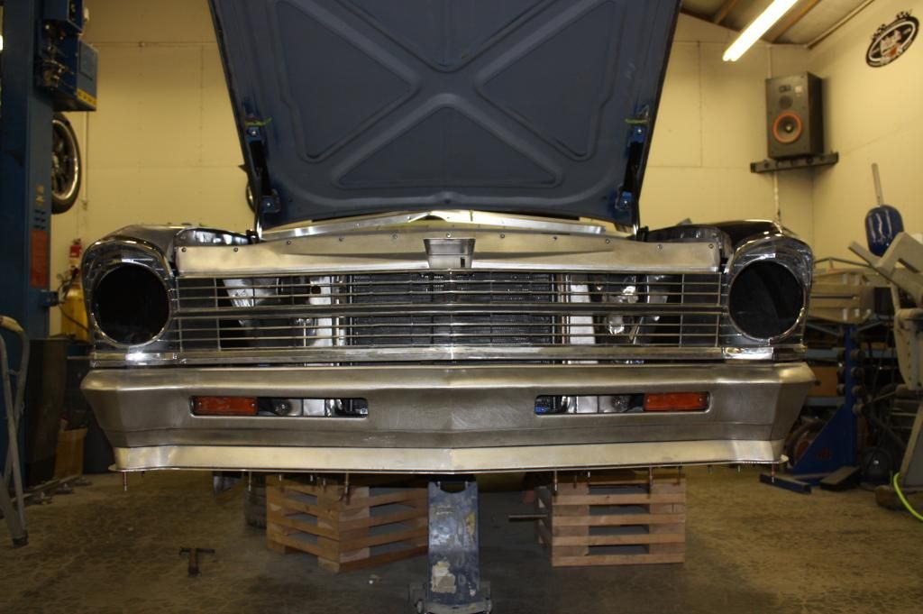

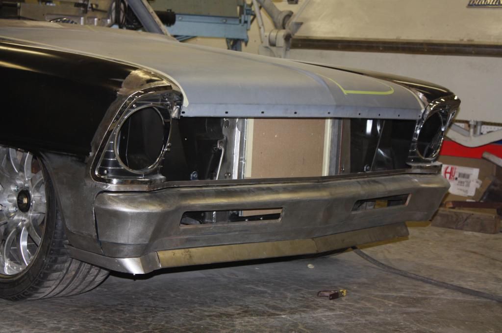

We got the car off the table and started fab in the chin spoiler as well as finished the front bumper! The bumper is now 1 3/4" narrower, the ends are completely different, they fit perfectly flush with the fender and also carry the body line to match, and the center has been peaked (shaving front license plate area).
We also made a part that goes across, under the grill to divide the bumper and grill..
Heres a pic showing the splittler that closes out the front under body. It also ties into the front alum wheel tubs.

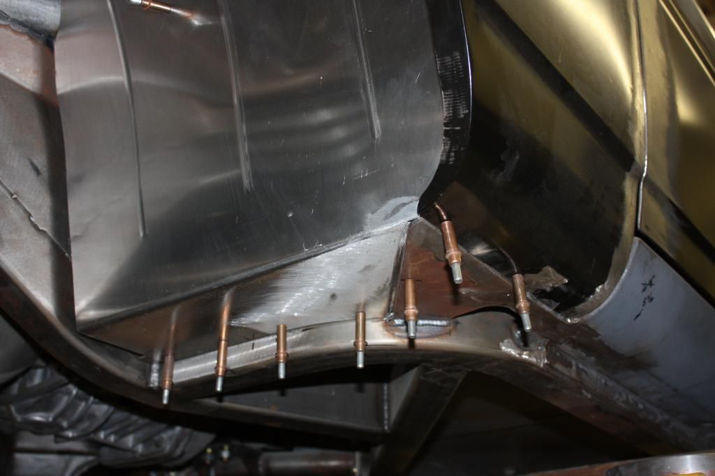

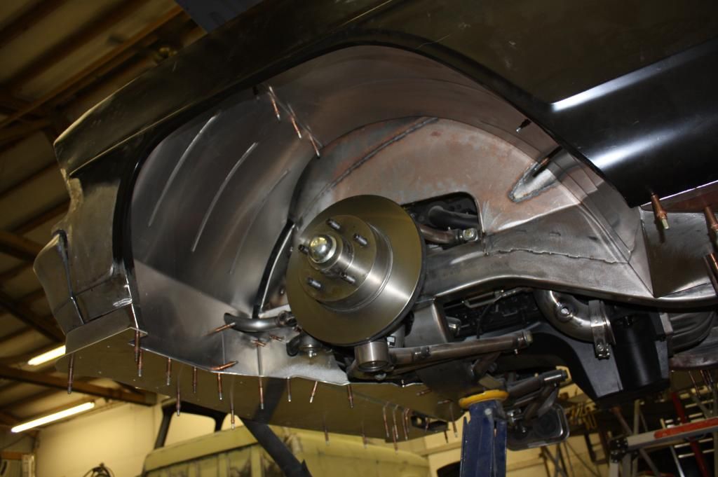

More Pics!

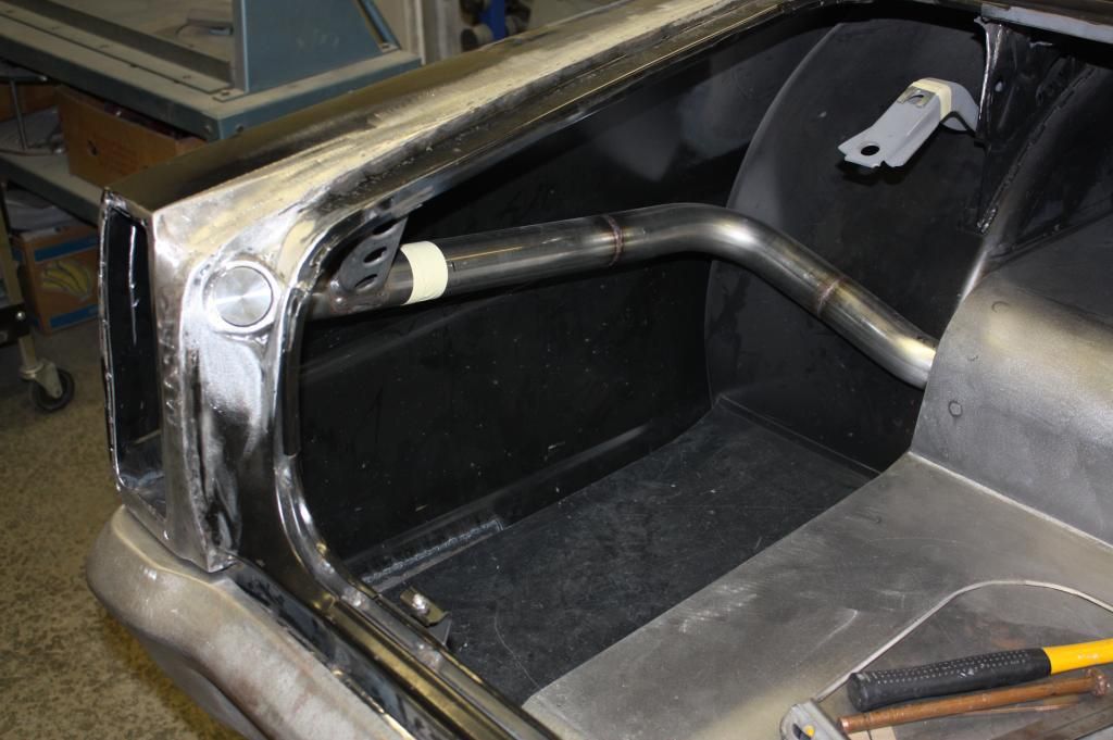

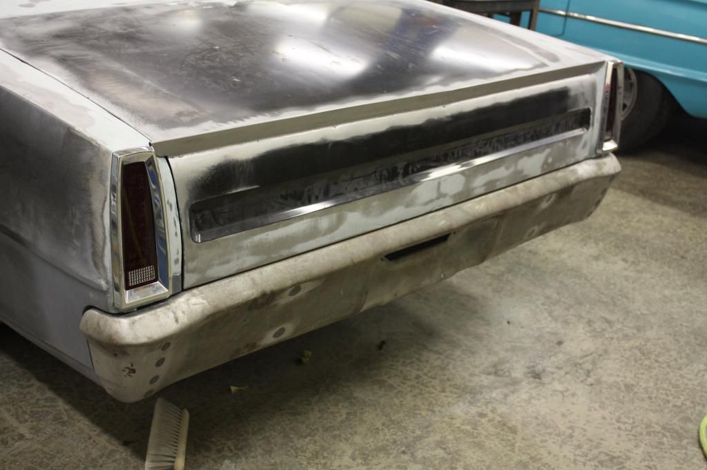

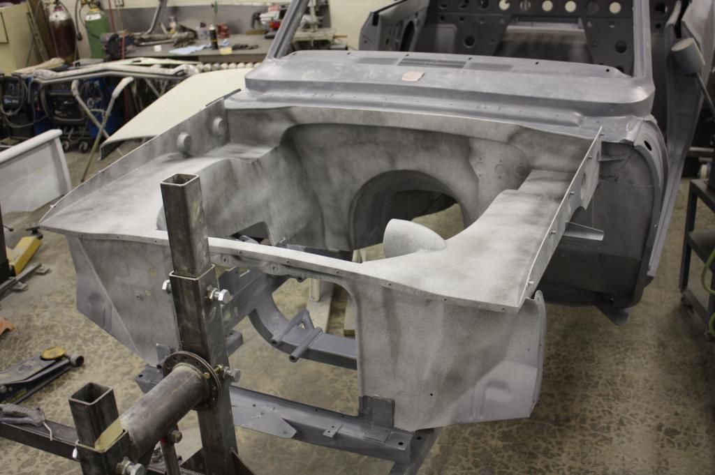

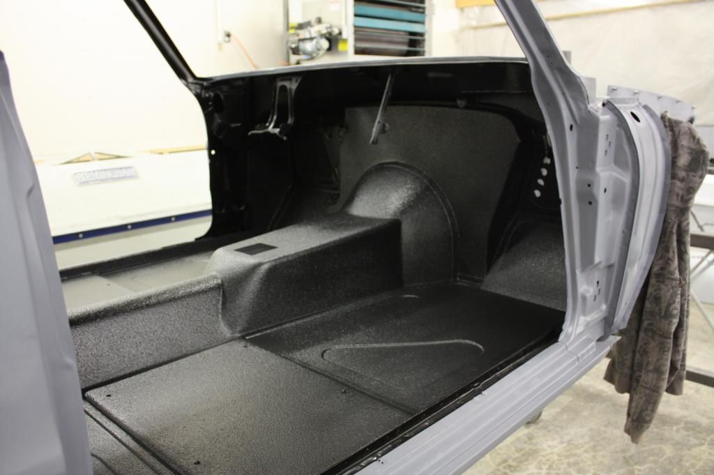

Heres some more progress pics!
We put the fuel filler in the trunk jamb

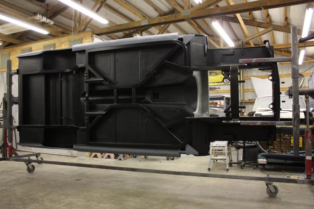

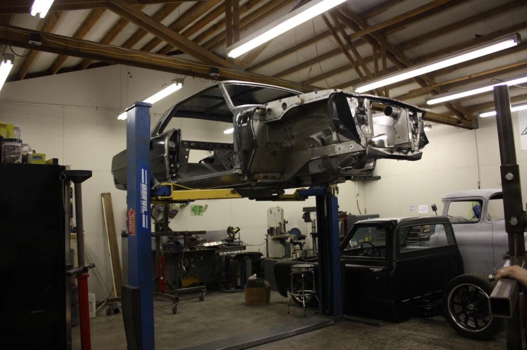

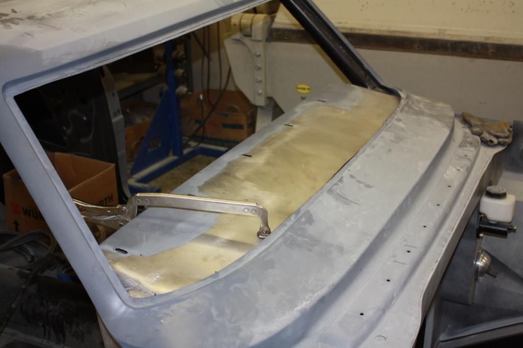

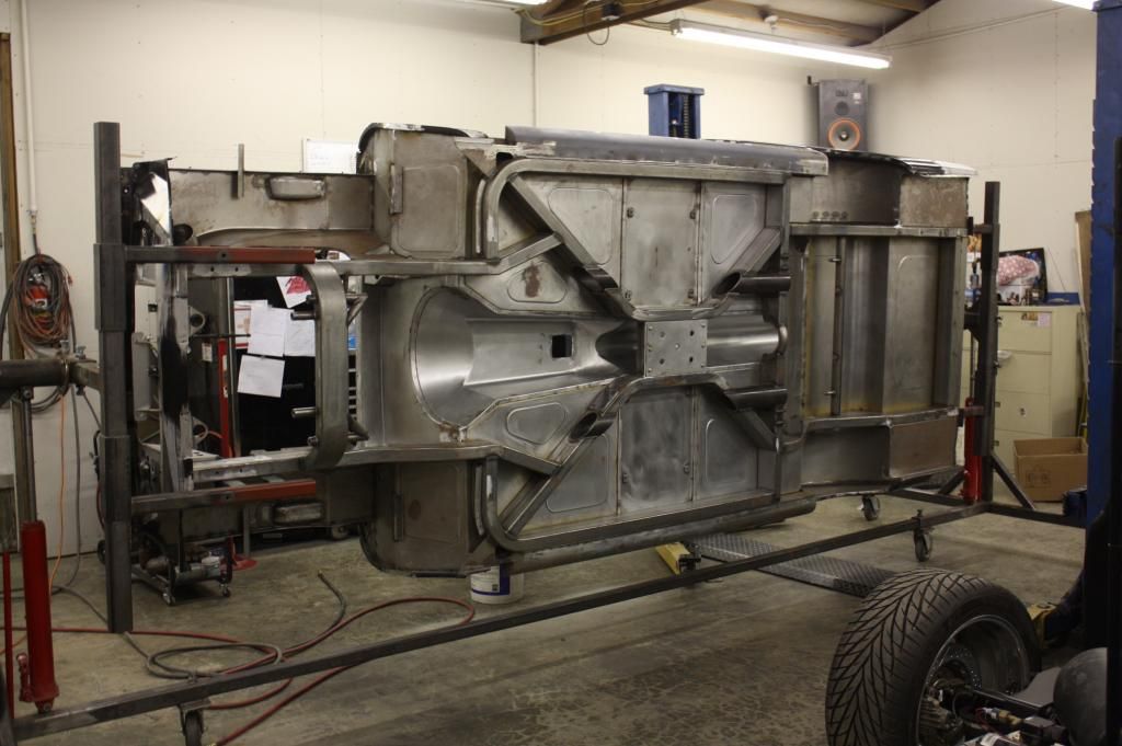

At this point 90% of the fab work was done... We disassembled the body to have it blasted again, before we start bodywork
We started bodywork in the engine bay, It was nice to have it on the rotisserie for this
We used a bed liner on all the floors, top and bottom.
The frame is smooth satin black.

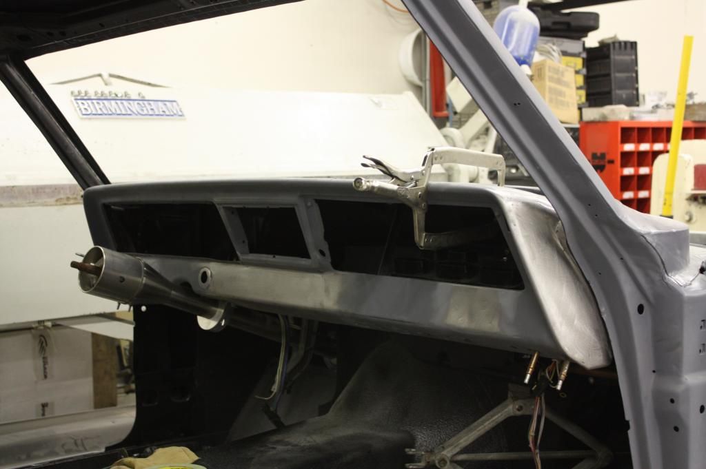

Some subtle mods to the dash include moving it back towards the driver 3".
We made a killer little spoiler for the trunk lid!
