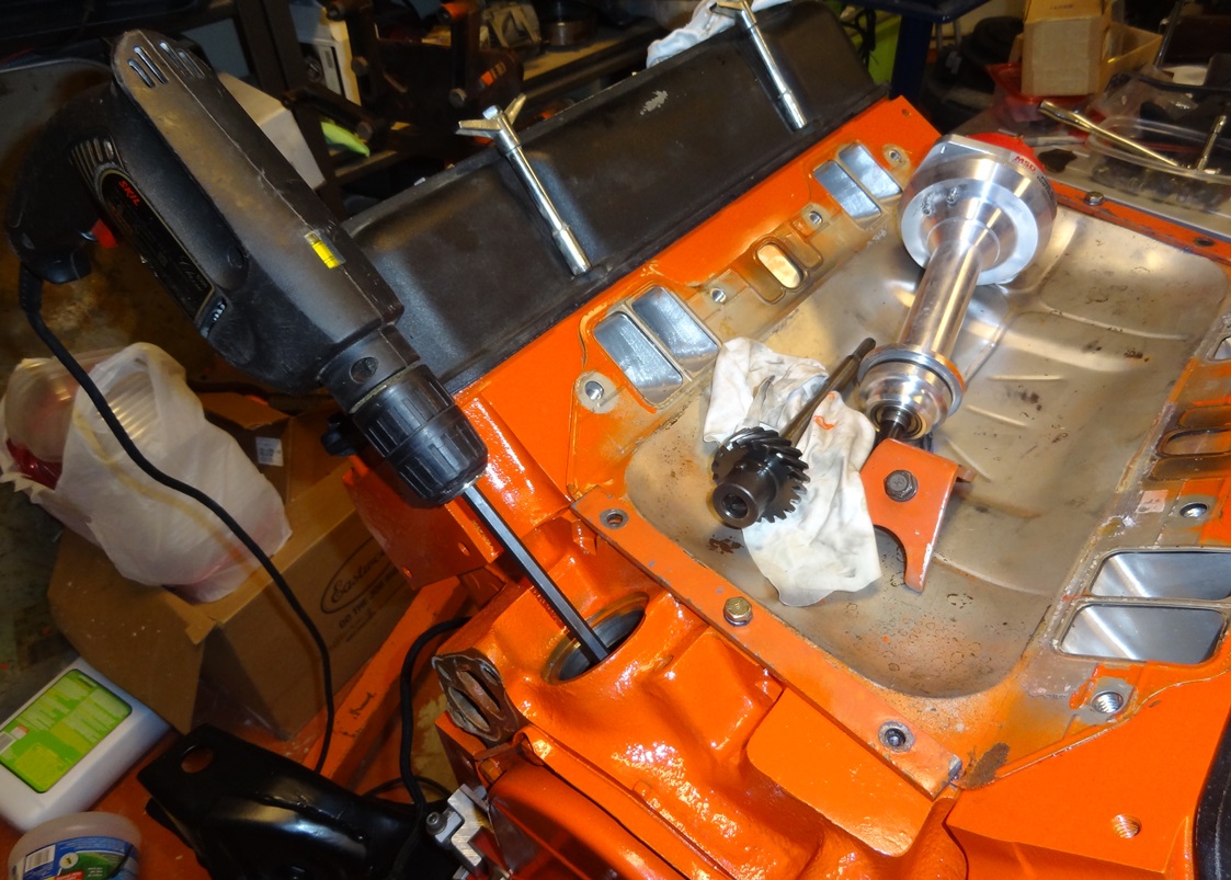

My car came with a drill powered pump from the factory. Pull the "cam sensor"/distributor, pull the intermediate shaft with a pair of needle nose. One 3/8" hex shaft and a 20 year old 800 rpm electric drill. Spins the oil pump faster than if the car was at idle (oil pump spins at camshaft speed). Rotate the engine slowly by hand to push oil to all the galleries. Just have to know which way the intermediate and distributor was pointing. I mark the distributor at TDC and make a note on the intermediate shaft angle.
Takes 5 minutes, a 1/2" wrench, and a pair of needle nose to set up. Only thing I had to buy was the hex shaft. I wrapped the hex shaft with masking tape in the area where it passes through the bushing in case it happens to touch. This will be really handy for prefilling Accusump, oil cooler, and remote filter set-up.

I pull the belt and use a drill to prime mine, plus I have a RHS block that has priority main oiling so it's a different kettle of fish. On stock blocks the lifter galley gets the oil first. I pull the oil plug on the pan and prime it until I get a good flow of oil out of the pan, I do all this on a dyno stand so it may not be so easy with it in the car.
Michael ---- You may have missed that we're talking about a GM LS motor here... thus NO distributor... and no access to the oil pump.
