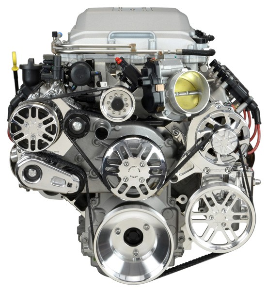

The 6 rib belt on the C1 will slip every time you get on the gas hard, those factory bracket systems have the accessory and 8 rib blower drive on Separate system for a reason. We had a few issues with the factory drive belt doing the same on the Dyno pulls for Hot Rod Magazine. We went to a fixed tensioner on the blower and it has worked flawless since.
I think the Concept One uses an 8 rib belt. All the accessories are modified with 8 rib pulleys.
Don

Interesting, for some reason I thought there was some machining involved. At least that is what I recall reading somewhere.
Edit: Here are the instructions for the specified pulley. Some machining required:
https://www.lingenfelter.com/sites/l...kit%20v1.1.pdf
Don
If you want to run the really small 2.35 blower pulley you have to grind to tabs off the blower snout which they say to machine off but it would be easily done and look nice with a die grinder, sanding disk and flap wheel. The other thing they recommend is you pin the blower pulley to the input shaft but almost no one does this that I have found and I have not seen any issues.
I used a large 3 jaw puller to get the stock pulley off (bending it in the process) and then pressed the new pulley adapter on with my 20 ton press.

OK, that makes sense. I didn't pick that up in the instructions. Thanks for explaining it.

It seems to me that all the systems discussed so far only relocate EITHER the a/c or alternator...from what i have researched both of these components caused fitment problems and required notching of the frame. has anyone combined (say the C1 and the vette setup) to eliminate notching all together?

Concept One should not require notching the stock subframe as far as I understand it. Have you called them and asked them? I don't think you will find a more compact setup.

Does 19303242 come with an 8Rib belt stock?

Yes.

The C1 setup does fit without notching the subframe. Thats what I am currently running.
