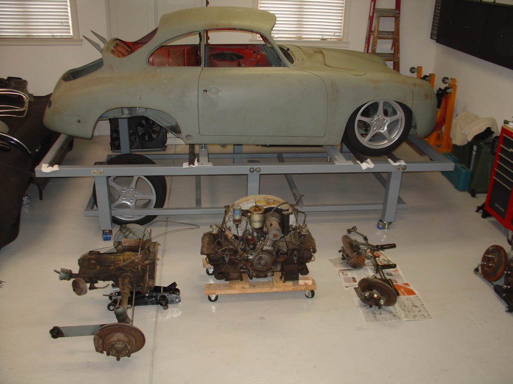

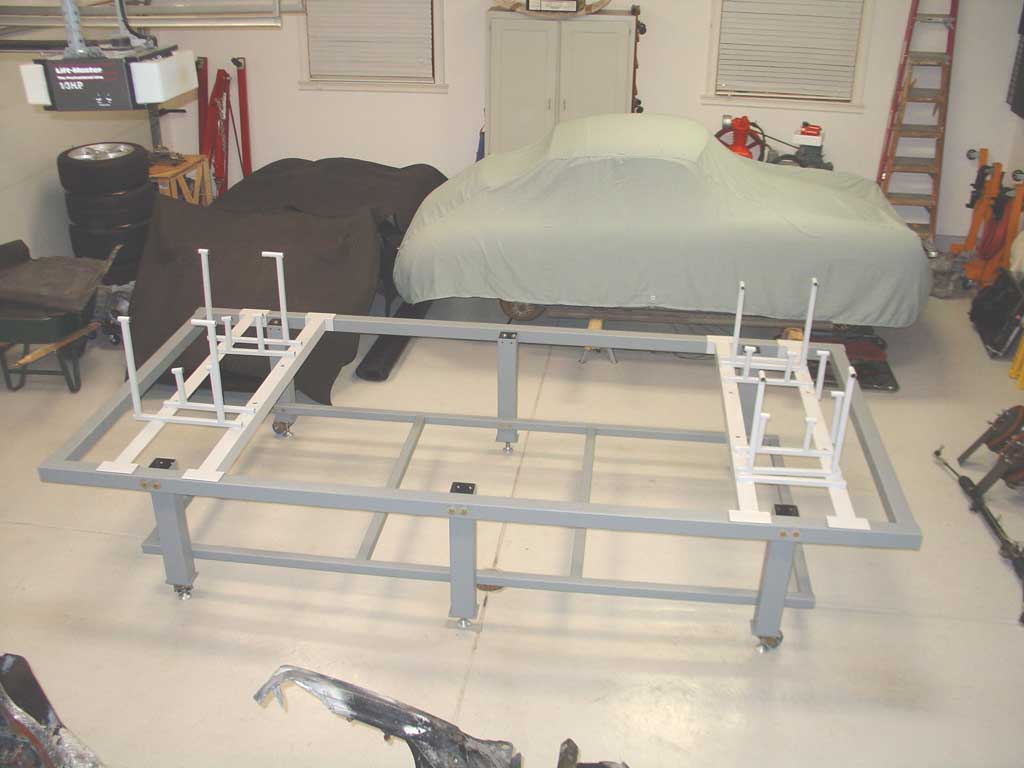

Quick Update.

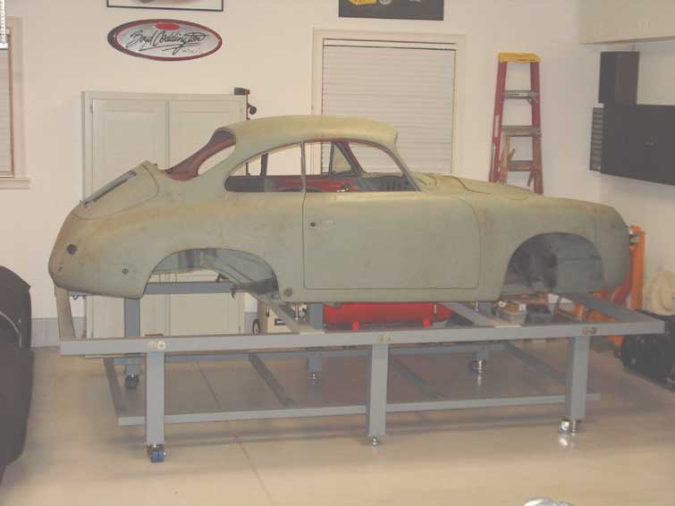

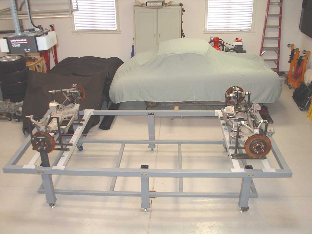

Vette chassis on jig for alignment and suspension positioning completed. All the stock suspension points identified and transferred to a jig cradle. Removed the chassis. Mocked everything back up for a quick doublecheck - then blew it apart and sanded and primered the jigs. Next step is to put the Porsche body on the jig - get the wheels under it and set the rake/attitude.

Built and installed 2 of the 4 support tubes - installed 3/4 all thread rod at all 4 corners for adjustment. Put the tires/wheels under it and the cars ready for ride height adjustment. Looks like I'll need to cut out the inner wheel wells before I can started though. The stock 4.5 wide wheels and the stock wells - just weren't designed to have 11 inches of tread in there !!
Man that 20 years in a storgage bin primer sure is ugly.
Next step: weld in some slip-joint cross bracing inside the body - and split it down the middle and widen the car 10 inches. That should be a heart stopping Point-of-no-Return....

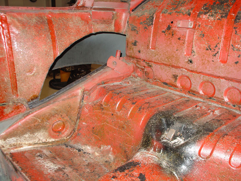

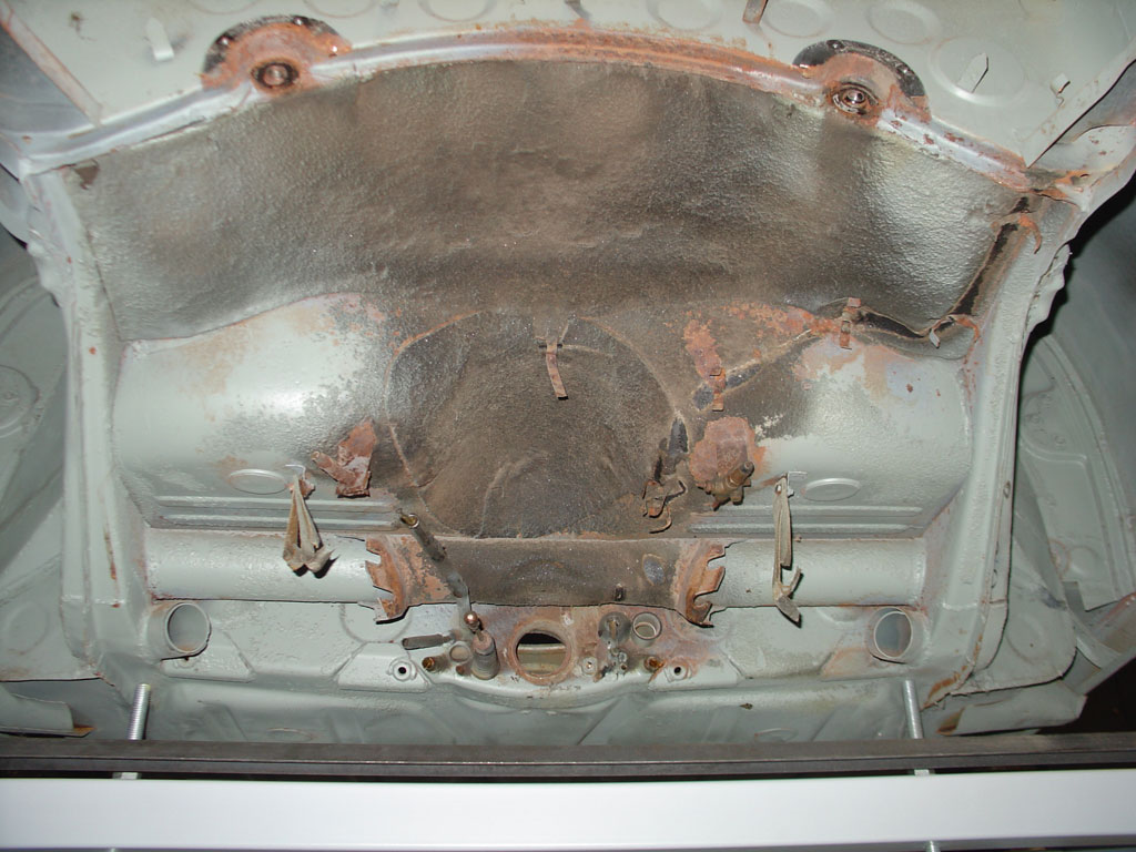

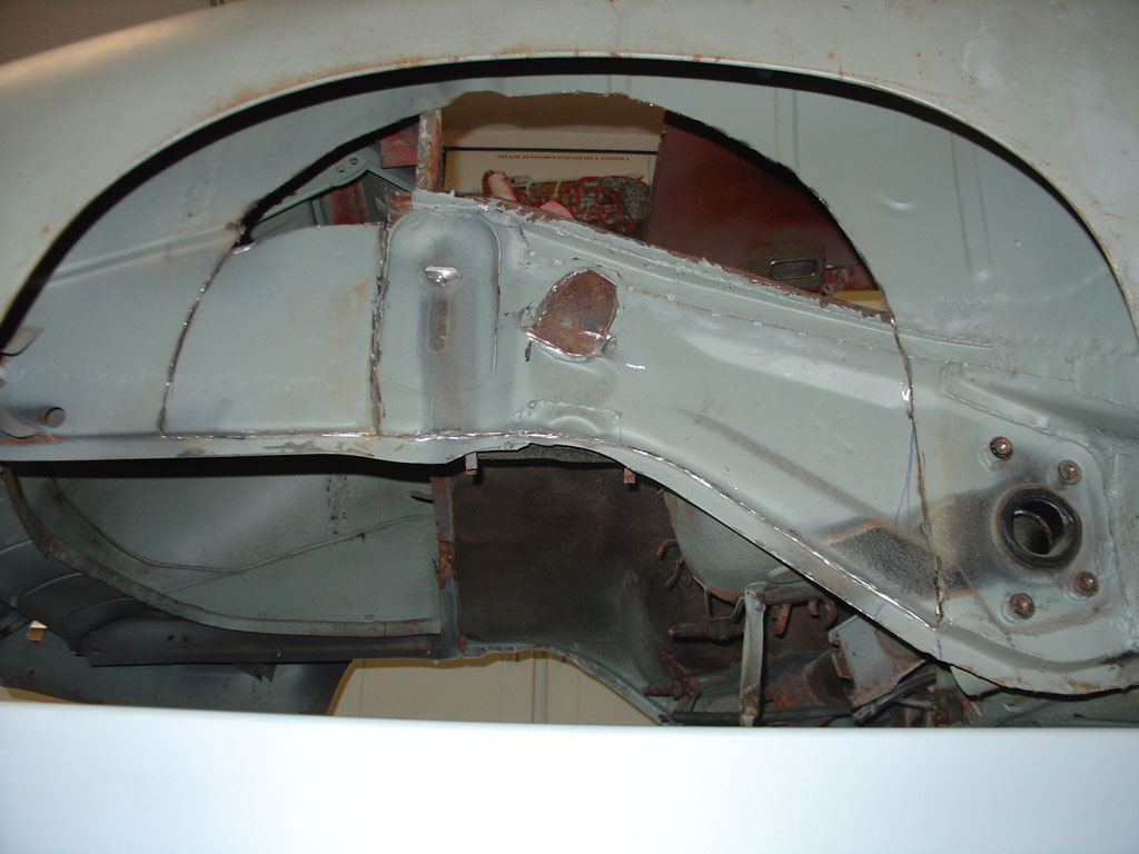

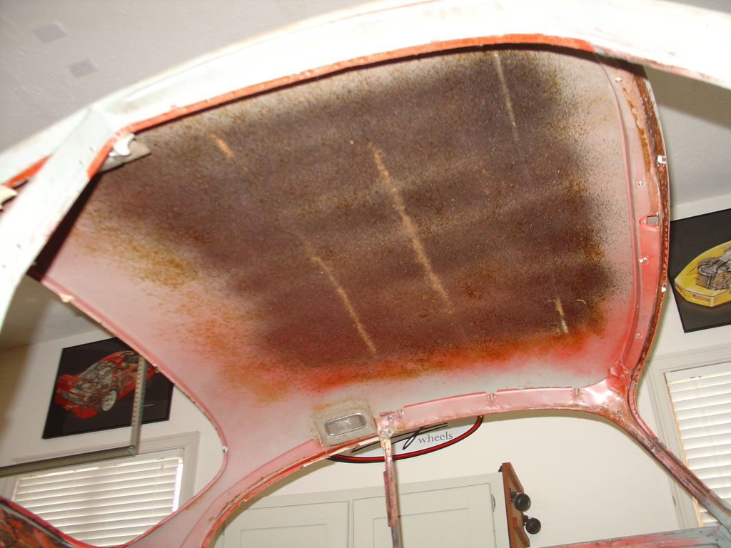

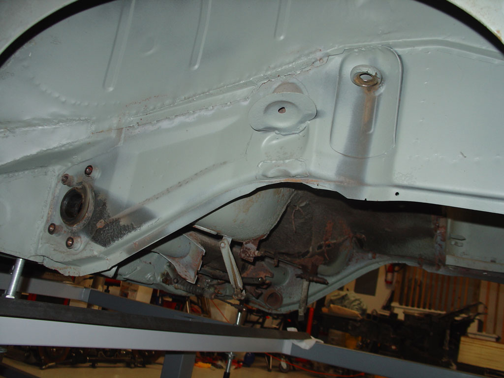

Got a little work done this week. Pulled the front suspension, engine, trans and rear suspension. Removed the headliner and all the interrior insulation, wiring, wiper motor and arms, and the steering column. Front wheels were able to tuck up in the wells - but the rears were no where close. So, time to cut them out. No turning back now....

Got some cutting done this afternoon. Need to support the tail - so I'll build/prime some body supports tonight and finish cutting out the opening Monday. Can't wait to get some tires in there and set the attitude so you guys can critique the stance for me. Right now it's 5 frnt and 6 in the rear - but I think the rear will need to be higher. I can cut and extend the rocker panel since there is nothing behind it - that would make it look lower and be an easy mod.
