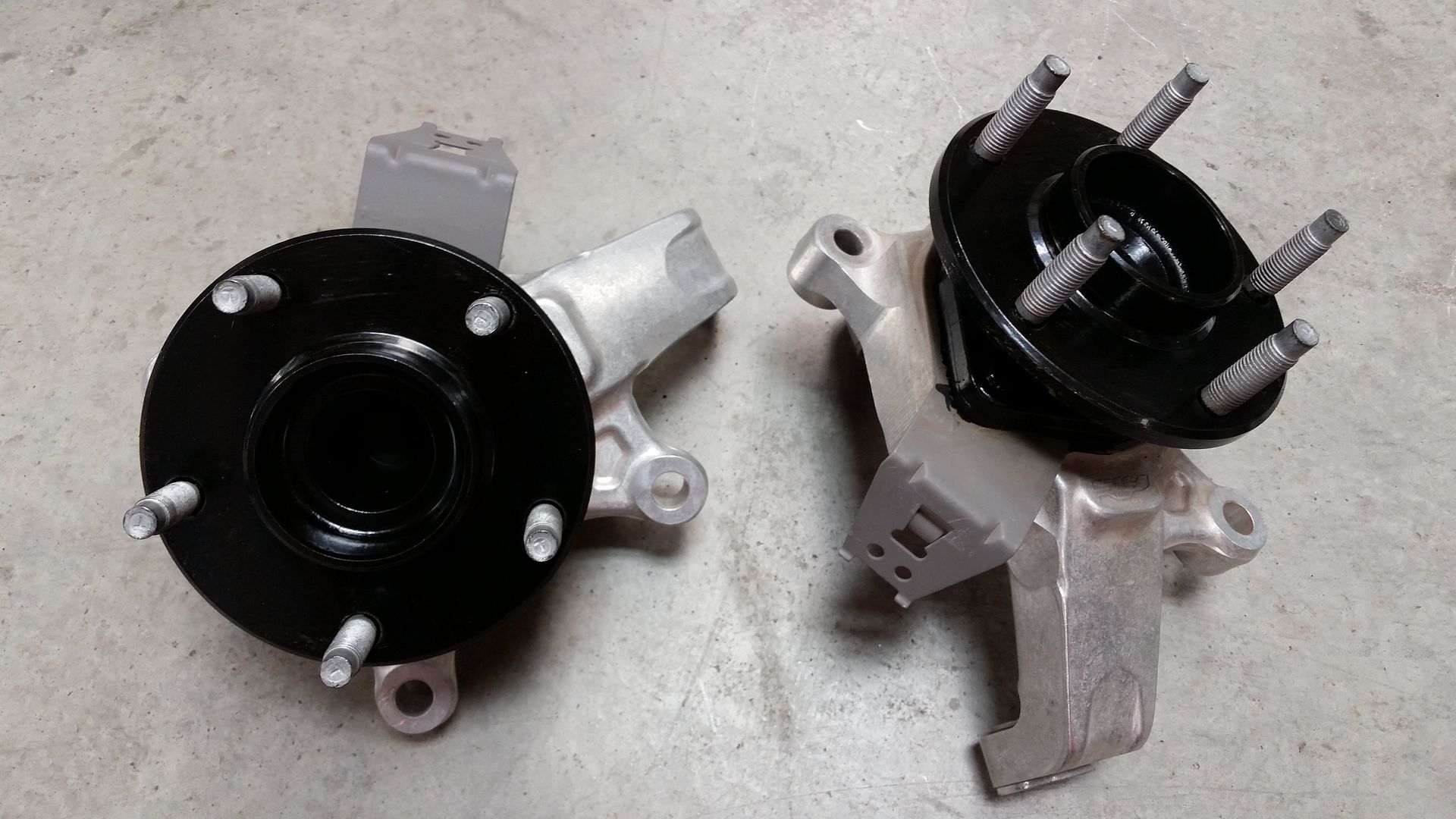

Blasted and painted the bare steel hubs on the AFX spindles, as they were showing surface rust. I'm trying not to install any bare metal parts on this car, is it looks awful later on. Spend some time doing it right the first time, and there aren't regrets later.

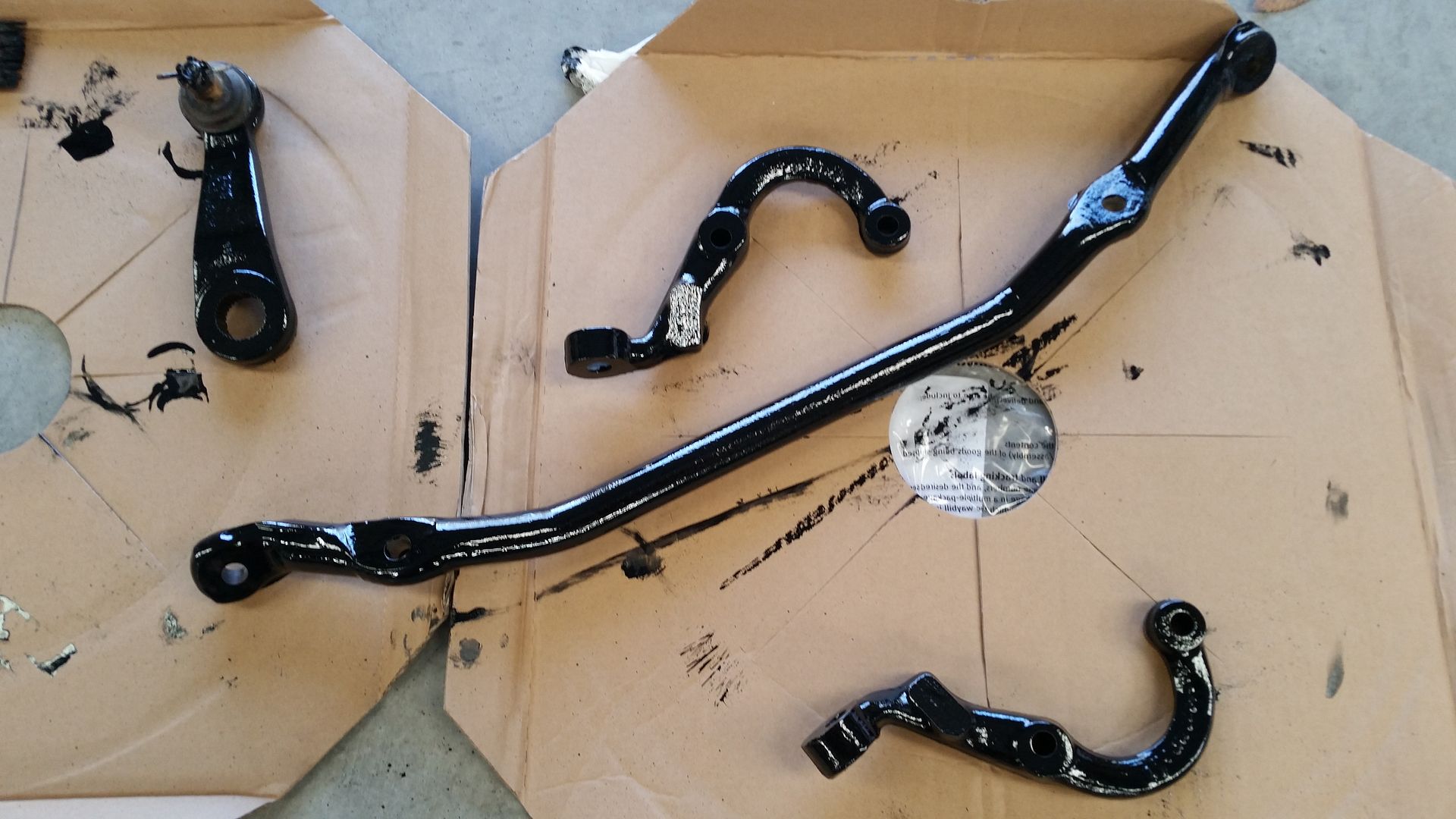

Blasted and POR15'd the factory steering parts. I find that I use that glass bead cabinet a LOT, and I'm glad I finally took it out of the box and assembled it a month ago. Now I wander around the shop and look for rusty stuff to blast. Restore, not replace, when possible.

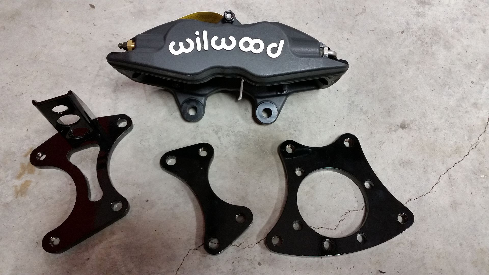

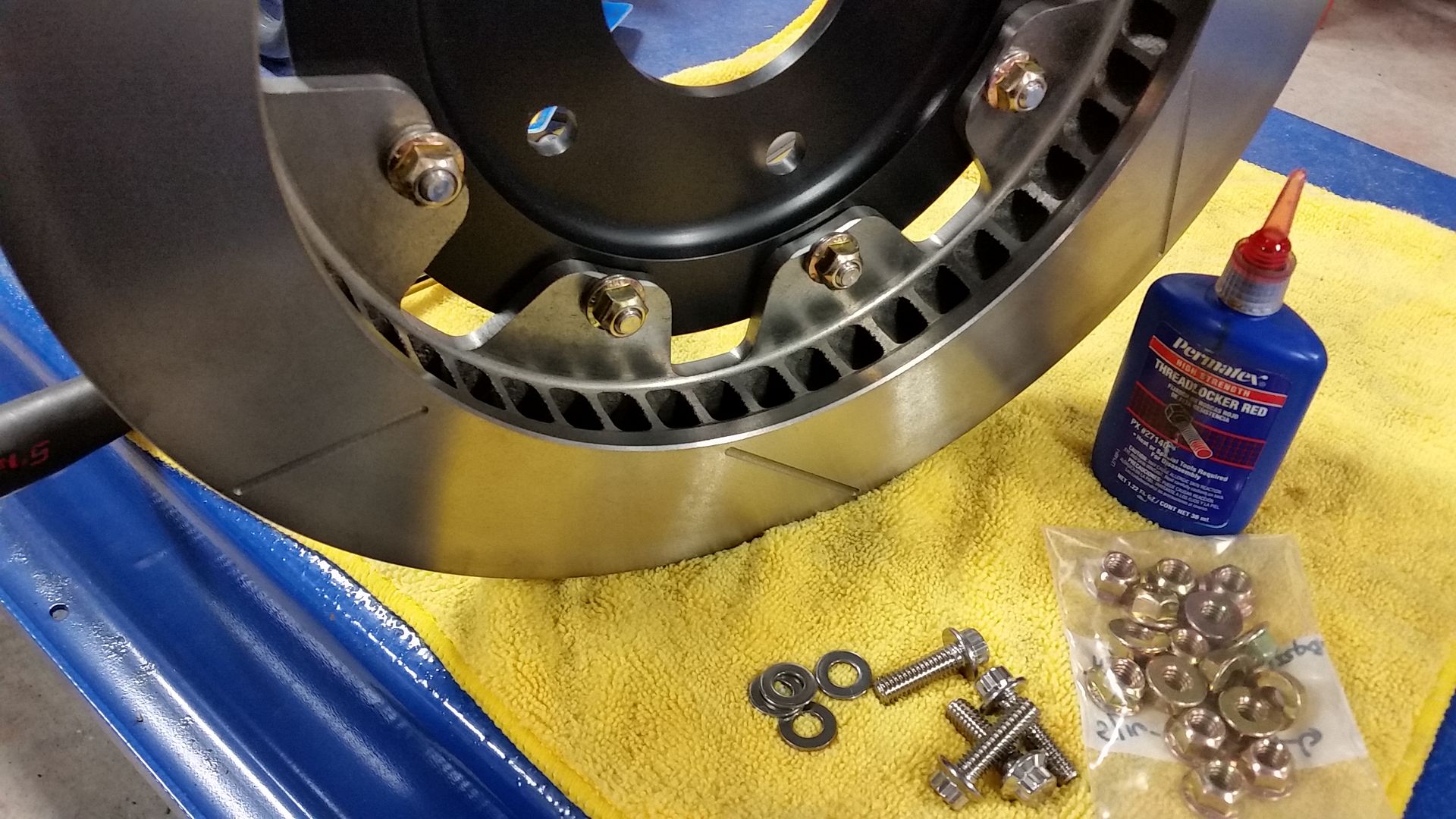

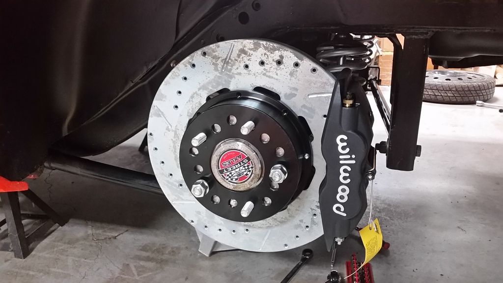

Now that the front and rear suspension were sorted out, I busted open the dusty Wilwood boxes that have been sitting since 2005. And, so began the royal pain in the ass that has wasted far too much time. The problem with buying parts that you can't test fit right away, is dealing with the surprise factor later on. I originally ordered this kit through Precision Brakes Co, before they went out of business (or simply changed their name). They used Wilwood components, but built their own brackets and rotor hats.
Rear kit was designed for GM 12-bolt, and luckily I had no issues there. Except for the external parking brake, which protruded so far back behind the rotor that I think it will hit my mini-tub during suspension travel. Not Precision's fault, as their kit was designed for stock width axles and mine is narrowed as much as possible to get a nice deep rear wheel lip. The newer Wilwood systems have the internal parking brake, which I prefer, but I also don't want to toss a good kit away just to get a parking brake.
Rears: 12.88" diameter, 4-piston.

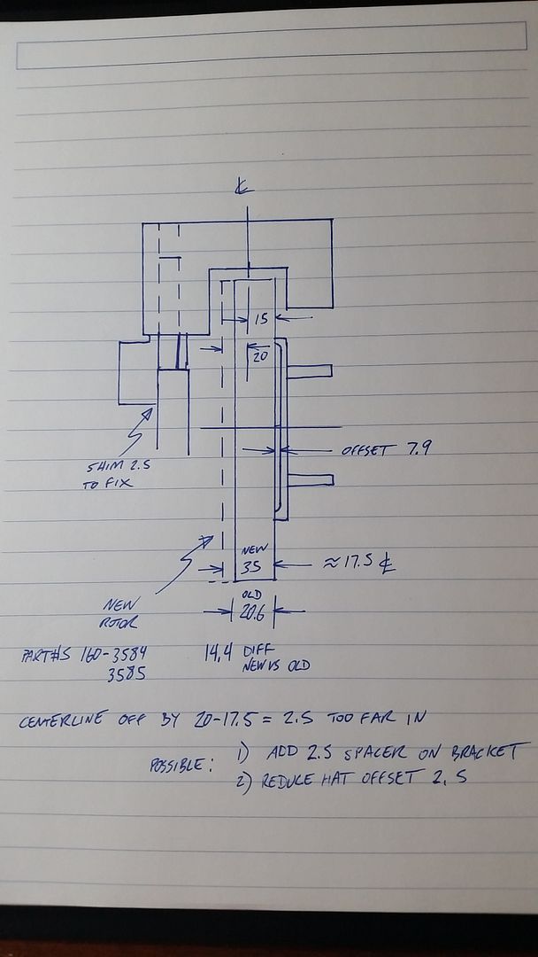

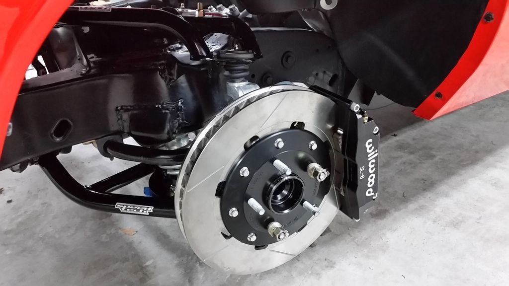

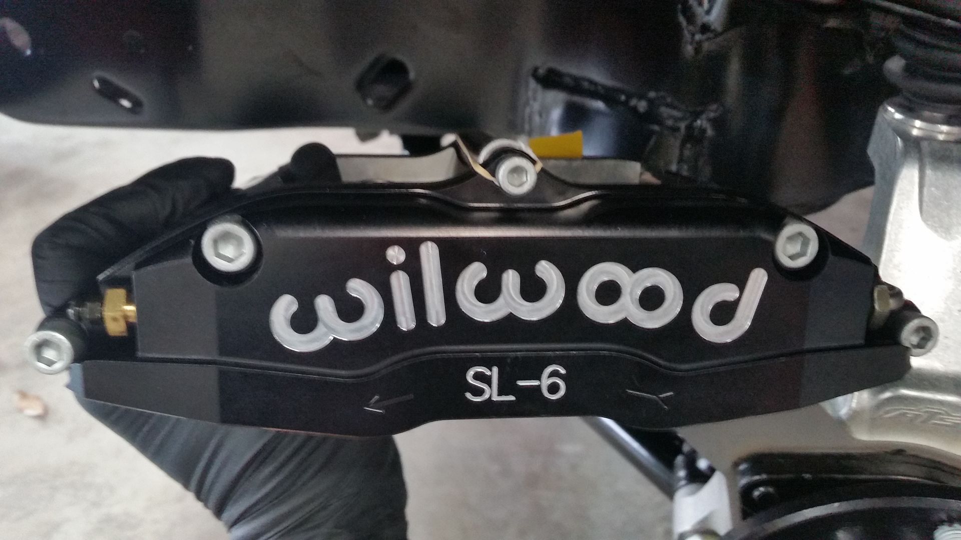

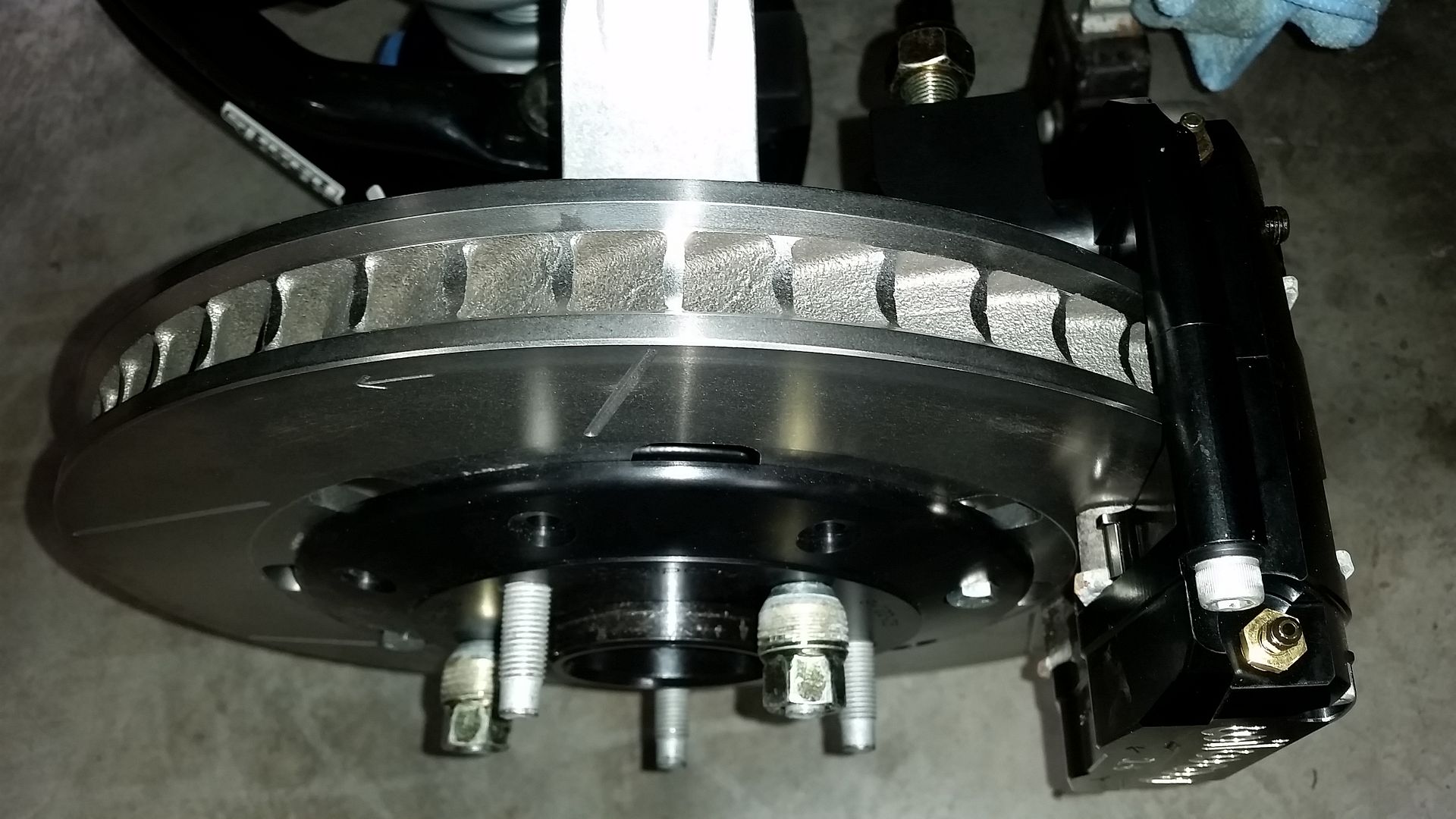

Now for the front brake "fun". Nothing fit well. The kit was supposed to be for the C6/AFX hubs, but I discovered that they sent me the wrong rotors. I mocked the parts up on the car, took a lot of measurements, did calculations to figure out the proper caliper offset and rotor placements. Then spent hours digging through Wilwood catalogs trying to gather up a parts list that would work.
Final solution:

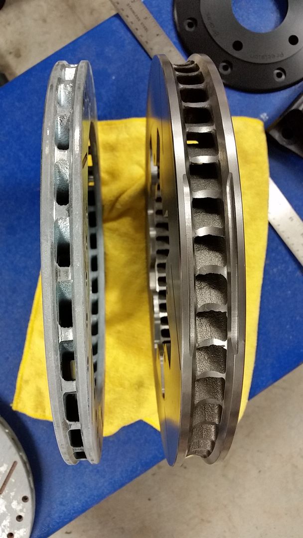

I discovered that Precision had sent me four rear rotors, with just different hats. The front calipers are much bigger SL-6 billet 6-pistons, and needed a much thicker rotor to work. How much thicker? 20.6mm up to the new 35mm size. Huge difference. I ordered a new set of Wilwood racing rotors, in 13.06" diameter.
Finally on the car:
How she sits today.

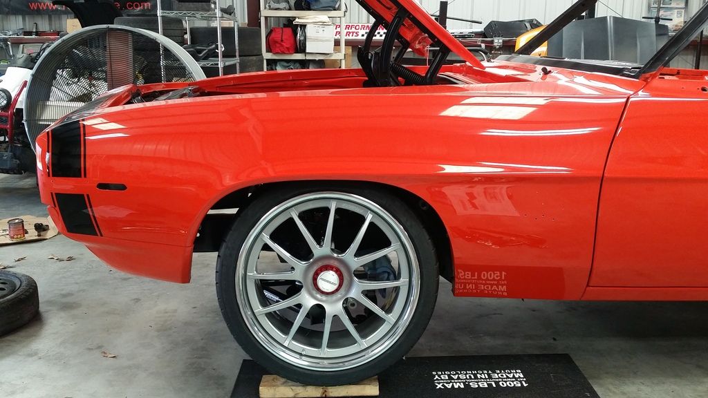

With the brakes in place, I was finally able to measure the car for wheels and tires. I had a slew of wheels around my shop, from various cars, so I had a fun day of sticking things under the car to visualize colors, tire fitments, diameters, etc... I placed my order for a set of Forgeline wheels this week, as I am a distributor/dealer for them and really like the brand.
Yes, this is a 2014 Dodge Viper wheel with 355 wide Pirelli. It fits. But, I'm going with 345 wide to give a little more space. GAP racing did a nice job on notching my frame rails, and moving the mini-tubs in as much as possible. They also pulled the quarter panels out a tiny bit, as we shot for 15" of inner clearance. Nailed it.
18" front and 19" rear. 25.5" front tire, 27" rear tire. I like this wheel diameter and tire height fitment.
