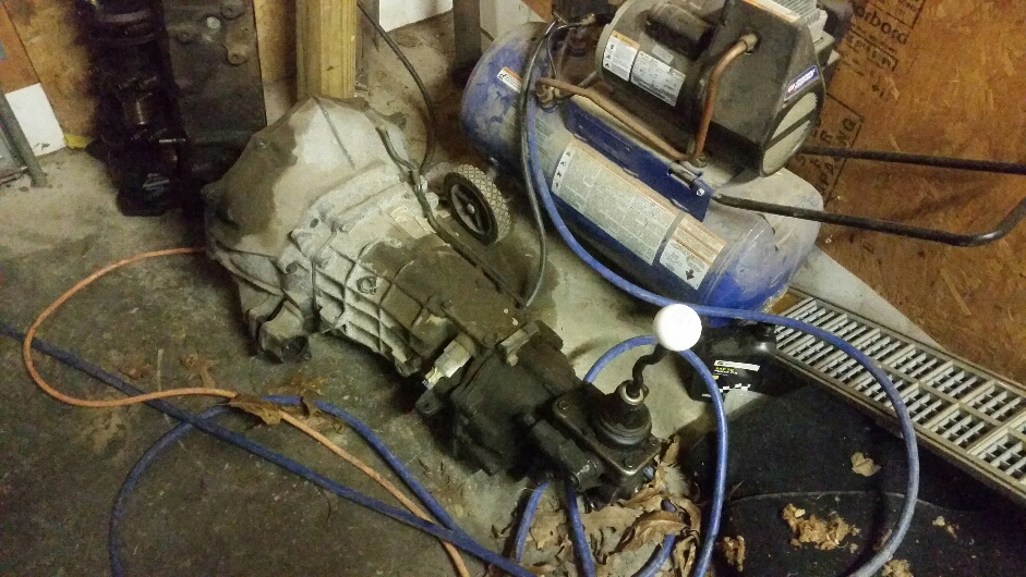

Got the T56 out of the Z28 and getting parts ready for a swap in to the Cheyenne, already ordered a clutch pedal assembly. Probably swap the LT1 in after some beefing up just need to figure out if I'll stroke it or just bore it out.

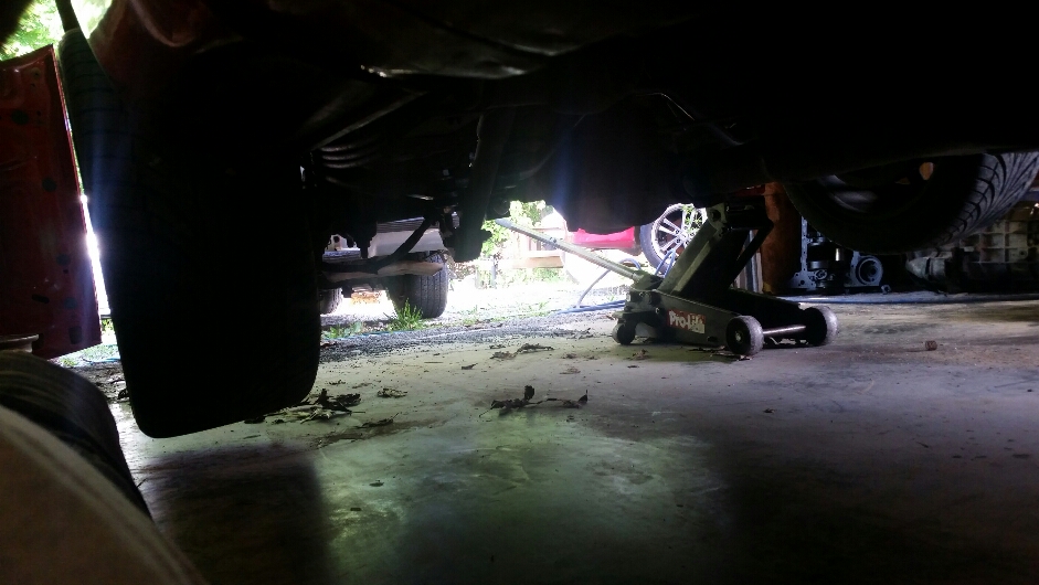

Got the Hellwig 1 and 1/8th inch solid rear sway bar installed today. But the instructions did nothing to help.
Helwig #7555

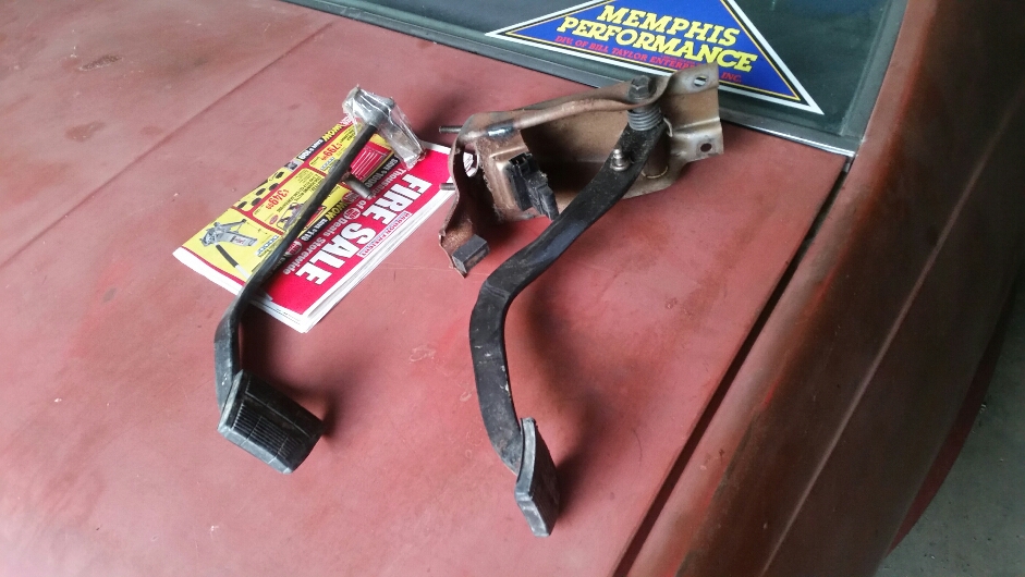

Got my manual brake pedal and clutch pedal assembly in yesterday.
So now the first step is done now I got to get a master cylunder.

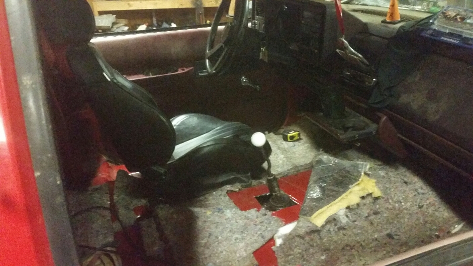

Getting the LT1 and T56 for a test fitting in the Cheyenne to see where the hole for the floor should be and get the right master and slave cylinder right.

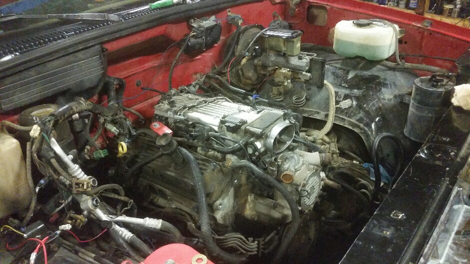

Posts: 87
Getting ready to test fit the LT1/T56 in the truck this 4th of July and see where I need to cut the hole for the shifter. Have already ordered a driver side seat bracket for my Procar seat and a PSI LT1 wiring harness for a manual, OBD2 port so I can use all the stock stuff, and laid out for a Corvette accessories bracket so I don't have to notch the frame for the Camaro a/c compressor placement.

Did you purchase a LS1 T56 or an LT1 T56? The LS1 T56 is not a direct bolt up to your engine. The flexplate, clutch, throw out bearing, input shaft and mid plate are different. The bellhousing will bolt up, but the clutch action won't work without heavy modifications.
The best route is to find an LT1 (1997 and earlier) T56.

Got the LT1 and T56 in tonight for a rough fit and to get some other thing to fit like the master cylinder and slave cylinder and custom transmission crossmember.
