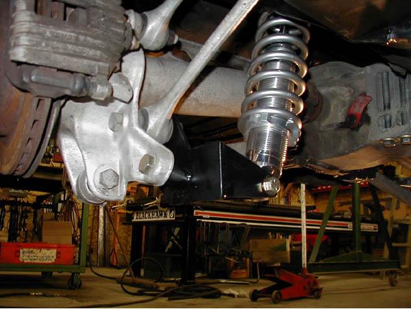

What are you doing to reinforce the spindle in the back. If I am seeing the pictures correctly, you're got a rod in place of where the coil overs will go? The spindle is not designed to handle the weight of a Corvette let alone a Nova. Could prove destructive if you it's not reinforced.

spindle you mean the aluminum casting part around the wheel bearing ? i attached it like it was meant to by wayne dues chassis shop (see photo). personally i think the casting should be fine but the black powdercoated lower mounting could be stronger ... it doesnt really look stiff espescially if you consider weight and lever where the shock ball eye attaches ... looks like it MUST bend ..... also with the sway bar mounting to lower a-arm in the front, the connecting bracket looks weak ... does anyone have the full wayne due set installed and can tell me more about it ?

Next -- check with Bob S. at Progressive Automotive. I'm using some of his parts for my project. He offers a bracket to use coilovers with a C4 IRS. The bracket is 1/4" plate and it mounts to the shock hole as well as to both of the trailing arm holes. The mount for the lower end of the coilover is boxed in. Very heavy duty.....
