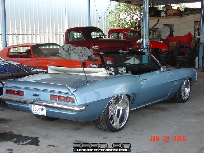

Mr.BThibodeaux does this car look familer to you, i bought it in houston about 1yr ago.by the way nice project

Yep, you bought it from me in Sugar Land. You live in south Texas right? I hope you ripped that 307 out of it. It looks like you have a few projects there to keep you busy.

I recognized your last name,the 307 is still in ,just with some aluminum heads,cam,and alot more googies.those are projecs from customers were working on.i see you have asome project there looks very,very nice
