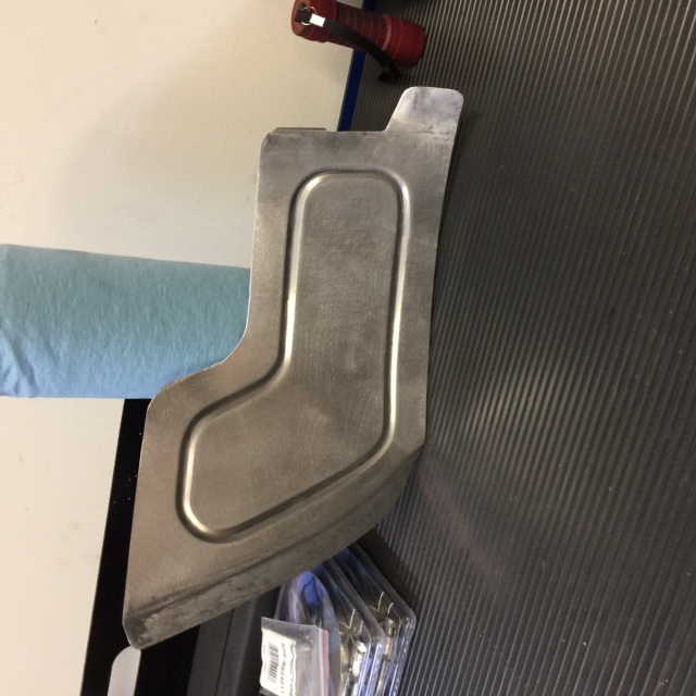

Put a few hours in the garage this weekend and finished mocking up the remote oil filter. I made a close out panel so it wasn't visible from the front wheel well. Once I get the front end alignment finished I'll install some mounting hardware for the closest panel.

Very nice! ^^
Well done mod right there.
