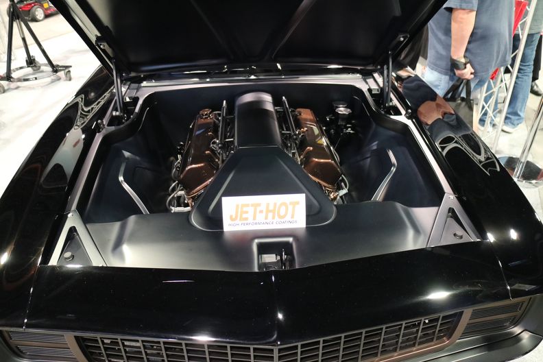

Jet-Hot coated Holley EFI multi-point intake manifold. This is part of a Holley HP big block Chevy package.
The intake was upgraded with some new squirters from Injector Dynamics.
Here, the billet Holley throttle body, fuel rails, sensors, stat housing, and MSD distributor are in place.
