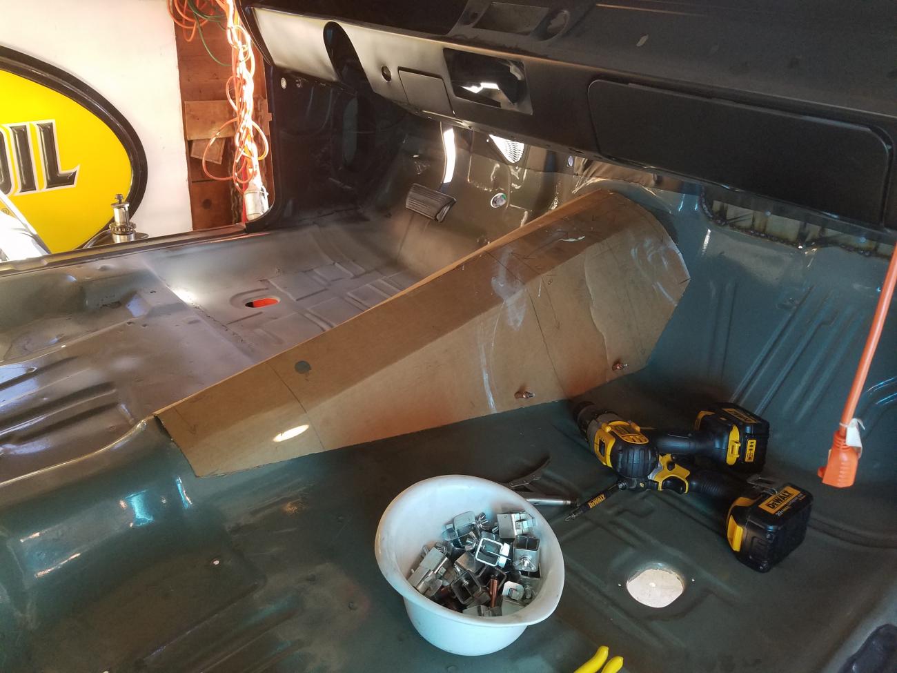

Alright, got the floor on the drivers side all patched in and good. I am now going to knock out the trans tunnel. I am still unsure if I will go with a tko600 or t56. So I am going to cut the tunnel big enough for the t56 just incase. I really don't think I have a need for the 2 overdrive gears where I live. Here is how it looks as of now. I made a template and will transfer this over to metal. Hope to have this finished up this weekend. This way I can shoot some bed liner on the bottom of the car.

Alright, cut out a template to replace the trans tunnel. Still not sure what I am going to put in here, either the t56 or the tko600. Picked up a piece of 20G steel and Cut the template I made out. Tomorrow I plan on cutting the tunnel.
