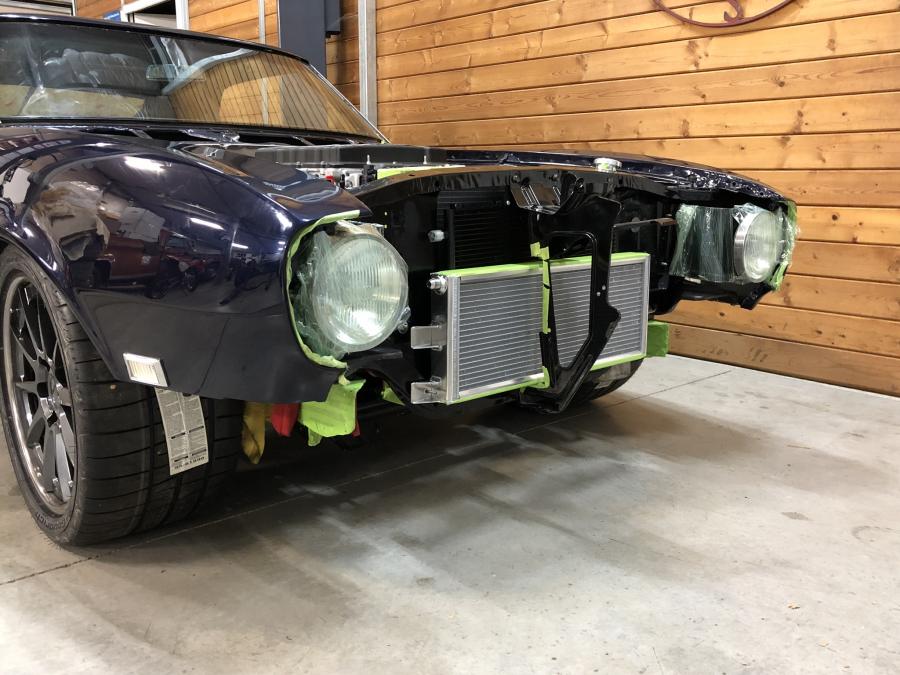

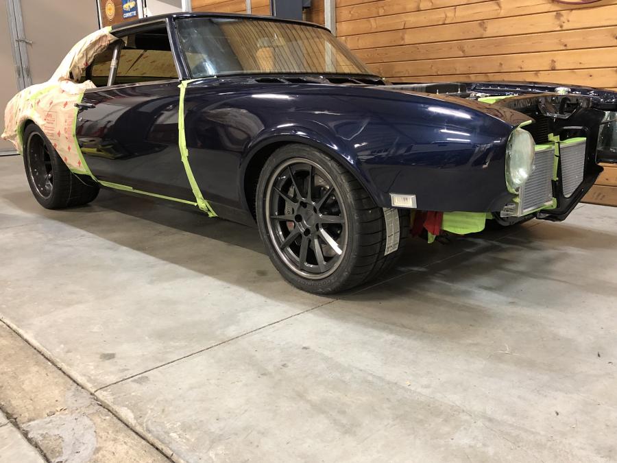

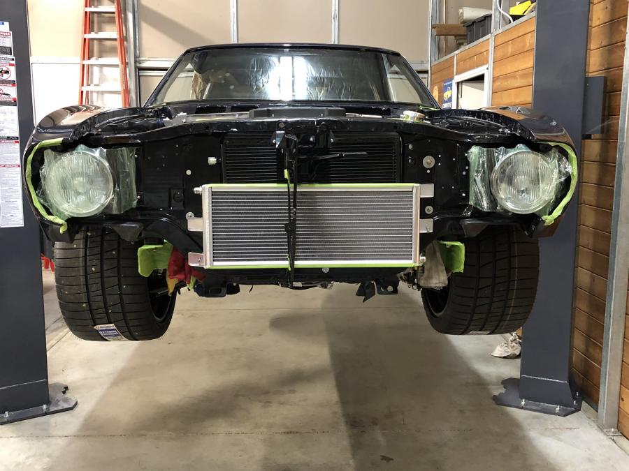

I had the luxury of spending another long day in the shop today and made some good progress.
Was able to get the fenders back on the car in order to mock up the Speedtech fiberglass inner fender wells. installation was straightforward enough but the factory mounts on the firewall must be trimmed in order to get them to fit. No going back now! These things add a significant amount of room for the 315 tires. I haven't adjusted ride height or tried turning the wheels yet but I don't see any obvious signs of it being an issue as there is a lot of room in there.
Also mocked up the radiator, A/C condenser, and heat exchanger for the supercharger today. Not sure yet how I'm going to plumb up the condenser as I will need to relocate the filter/drier so none of the Vintage air pre-bent tubing will work. Has anyone done something similar? I'll probably locate the filter/drier between the headlight bucket and the heat exchanger.
Now that this complete I was able to figure out dimensions for the oil cooler and PS cooler. those are going to stack on top (above) the supercharger heat exchanger. I'm a little worried about airflow through all of these before air gets to the radiator but going to move forward with it and see how it goes.
pics of todays work....

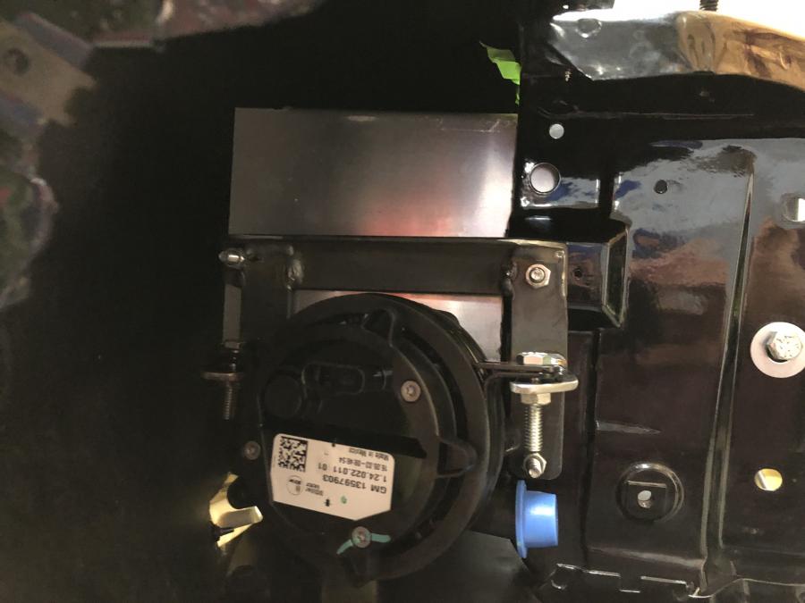

I was able to spend a little time in the shop today to finish up the raised transmission tunnel modification and mock up the vintage air evaporator.
Headed back to the office tomorrow, so unfortunately my couple of weeks in the shop came to an end tonight. Back to working on the car on weekends only...

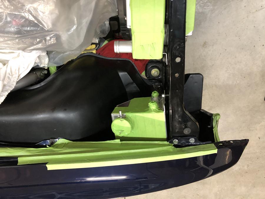

The only real progress on the car this weekend was that I met with my buddy Aaron who owns Southbound Customs, a auto body restoration shop in Oregon. We walked through the car and built our plan for body work. As most custom car builders are, he’s super busy with current projects but we settled on having the car into his shop to begin body work the 2nd week of April. So, I need to crank on this thing the next couple of months to get all of the mock-up complete and disassembled to be ready for him. Gonna be fun!
I did manage to find locations for the supercharger coolant tank and pump assembly. Also found a perfect location for the LT4 ECU and engine harness fuse box up underneath the dash above the vintage air evaporator. That’s a huge win as I was worried sick that there wasn’t enough room under the dash for them.
Here’s a couple picks of the coolant tank and pump locations. The pump fits great behind the passenger side headlight bucket.
