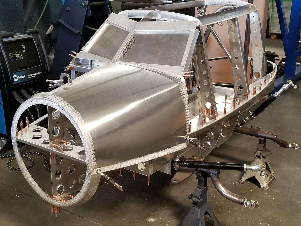

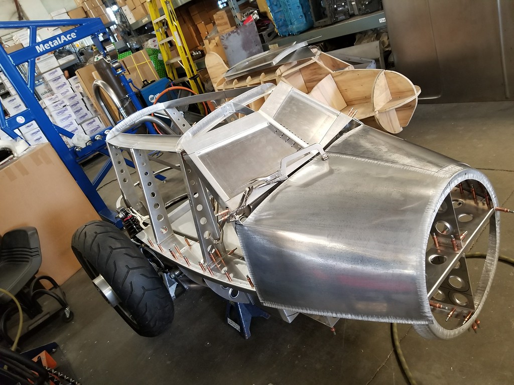

After following your ruptured duck project this is a great encore! I love seeing these come together and thank you for taking the time to share. What thickness aluminum are you working with?
  #38
Old 03-07-2018, 07:59 AM
FaBrycation's Avatar
FaBrycation FaBrycation is offline
Join Date: May 2007
Location: Pella, Iowa
Posts: 665
Thanks: 91
Thanked 93 Times in 35 Posts
Thanks, it was an honor to get to build this sidecar. It, like the Duck, is made up of 3003 H14 .063 Aluminum.

Posts: 132
So awesome! Thanks for posting!

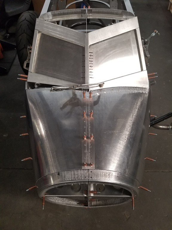

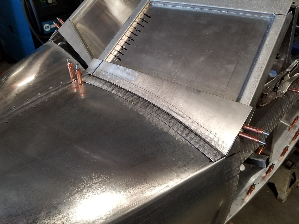

I've never really seen the technique of building your body lines and panel edges in stretched and shrunk strips then sheeting in the larger areas between. That looks really effective.
